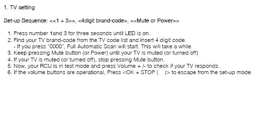

    hello, as in the topic I have for some time, I have a VU + DUO 2 tuner with an original remote control that has 2 switches, one for the tuner and the other for the TV
    And here's the question, does anyone know how to program it so that it turns the SAMSUNGA TV on and off?
    Thanks in advance for your help

  • #7 15619309
    romeok01
    Level 35  
    Posts: 2117
    Help: 357
    Rate: 590
    You have only written above in English.
    1. Press buttons 1 and 3 simultaneously for 3 seconds until the LED lights up.
    2. You enter a 4-digit code
    3. Press and hold the Mute button until the TV mutes
    4. Now press the Volume +/- button and check that the volume control works
    5. Press Ok + Stop simultaneously and you exit the remote control programming mode.

    I had the same problem and I succeeded, maybe this way will help someone.
    1. Press buttons 1 and 3 simultaneously for 3 seconds until the TV LED on the left side of the Vu + remote control lights up.
    2. You enter a 4-digit code (codes below)
    3. Press and hold the white TV button on the top left of the remote (it should be red) and hold it until the TV turns off.
    4. Now press the OK and Stop buttons (at the bottom of the remote) simultaneously until the TV button (LED) goes out.
    5. Now you can turn on the TV with this button.
    - Samsung Code, 2 4 4 8
    - Panasonic Code, 2 1 5 3
    - Philips Code, 2 1 9 5
    - Sony Code, 2 6 7 9
    - LG Code, 1 6 2 8
    if it does not work, return to the factory settings of the remote control (how to do it is described above in "Photodetector"
    Regards

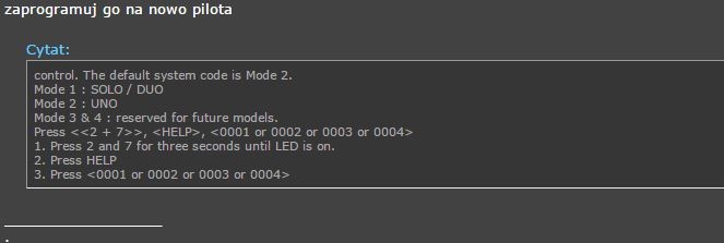

  • Factory reset works but pairing remains unresolved
    #27 20367536
    ggeneja
    eprom1 wrote:
    The setting for the volume button on the Vu remote is here: menu-settings-system-audio/video-settings hdmi cec-forward volume keys. Uncheck, from green to red. And you have volume controls.
    Factory reset: Simultaneously press PVR EXIT for 5 seconds. The red LED flashes 3 times after 5 seconds. And that's it.
    To program the remote control as described earlier, turn off all devices, turn on only the TV and proceed as I wrote, so that the remote control remembers the settings, remember to confirm with the OK button.
    Hello. Can you help me pair the remote with the vu zero decoder? I dug something in the options and disconnected the remote control from the decoder and now I can't do anything on the decoder. The option to reset PVR EXIT works because there is a 3-time flash on the remote control. I still don't know how to pair it with the decoder.

The remote became unpaired; the menu is unreachable—how to re-pair?
Access the box via OpenWebif, change Remote Control Code to 1, then press PVR + EXIT five seconds on the handset; pairing restores [Elektroda, ggeneja, post #20369577]
