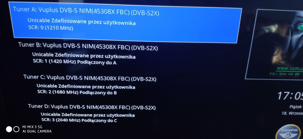

    Hi

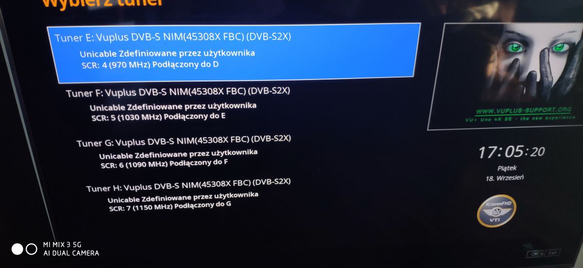

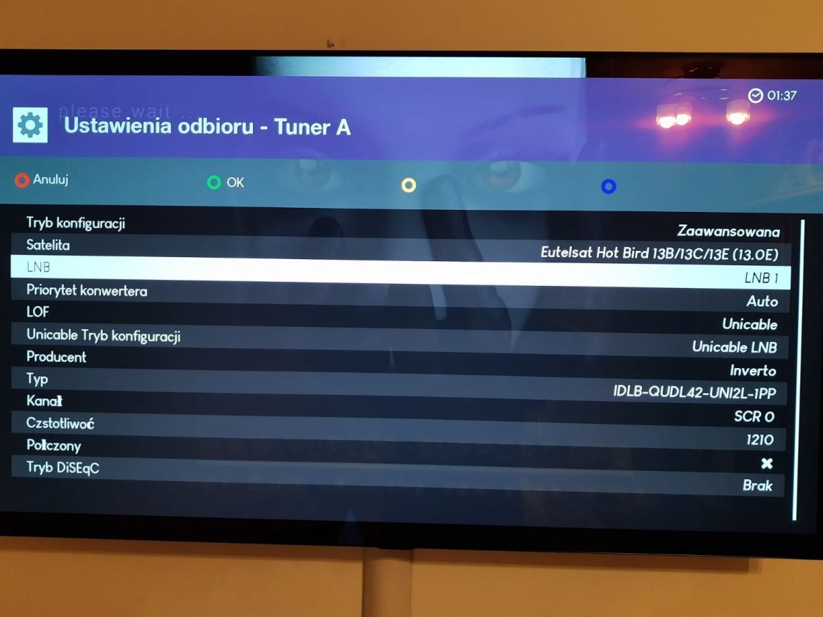

    I have a UNICABLE QUAD TWIN INVERTO CONVERTER
    IDLU-QUDL42-UNR2L-1PP, connected to the VU+ DUO 4K tuner (1x FBC Dual DVB-S2X head), one cable probably connected to Tuner A, I've been fighting with it for 3 days and I can't handle it, the current configuration of the tuner:
    Setting up UNICABLE QUAD TWIN INVERTO CONVERTER IDLU-QUDL42-UNR2L-1PP with VU+ DUO 4K Tuner
    set: Tuner A:
    Tuner B off,
    Tuner C:
    Tuner D connected to C, E to D, setting the appropriate SCR by box:
    scans the sky and no channels.
    What am I doing wrong?

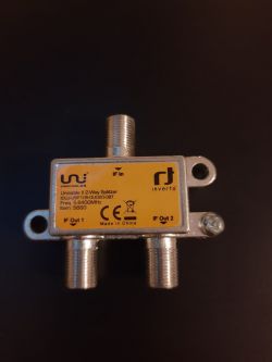

    in the set with the converter there is a splitter
    I connected it by branching into two wires but it does nothing in the sat installation. there are no other tuners in the UNICABLE system, there is another FULLBAND connected to the LNB1 converter

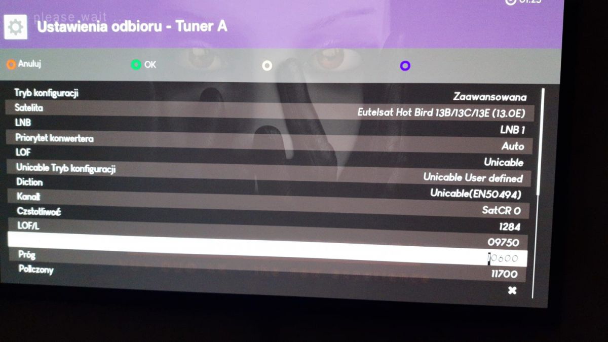

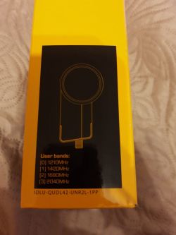

    Maybe defining UNICABLE parameters by the user will help? What values to enter?
    Second thing - to be explained,
    on 1 cable there is 1 physical tuner, 3 virtual, so if it works ("lights") I have 4 tuners? 1 watching, recording 3 different shows?
    Similarly, if I connect 2 cables, I have 8 tuners?
    I don't have to connect 2 cables if I don't want 8 tuners?
    Ultimately, I want to watch SAT TV, e.g. on a laptop, tablet, or another SAT tuner via IP? When the tuner (VU+ DUO 4K) is busy.

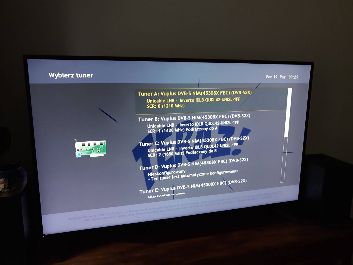

    tomaxas wrote:
    Were you able to enable unicable?
    I have a Vu+ Uno 4k SE with a Unicable Inverto 5434 converter (as from this link https://www.amazon.de/-/en/gp/product/B071FQQ...=ppx_yo_dt_b_search_asin_title?ie=UTF8&psc=1) Vu works under the latest VTI . Here is the tuner configuration screen. Everything runs very smoothly. Here are screenshots from the tuner configuration tab.
    Setting up UNICABLE QUAD TWIN INVERTO CONVERTER IDLU-QUDL42-UNR2L-1PP with VU+ DUO 4K Tuner Setting up UNICABLE QUAD TWIN INVERTO CONVERTER IDLU-QUDL42-UNR2L-1PP with VU+ DUO 4K Tuner
