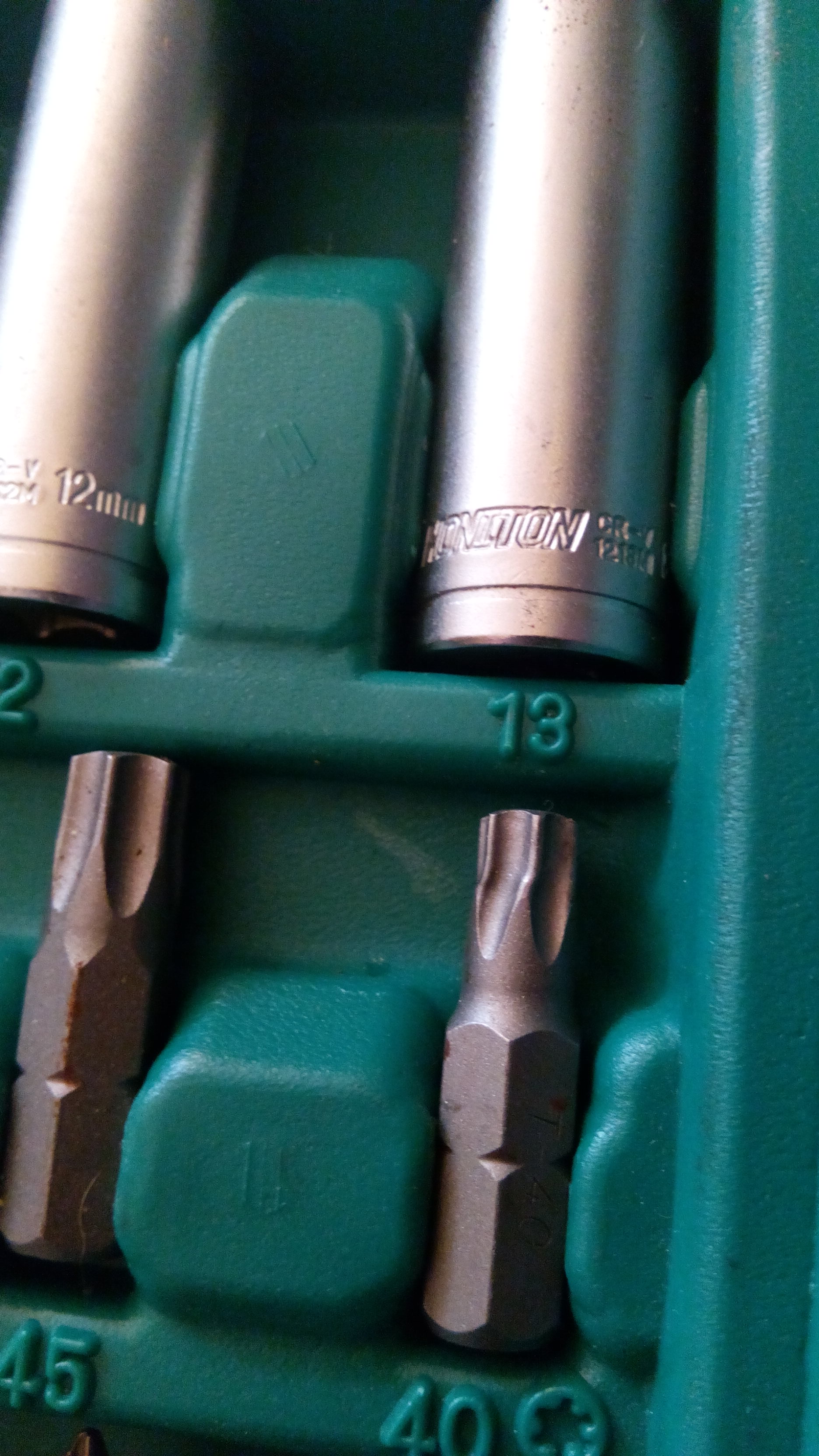

    Honiton, yesterday's unscrewing the washing machine pulley, without any levers, with one hand not very hard pressing
    Durable Key Set Recommendations for PLN 500: Brands, Material Strength, & Richly Equipped Options
    Thank you for replying and showing the photo, such answers are worth waiting for. I think I will choose the Bahco key set, but I will wait for the next answers (don't throw money down the drain).
