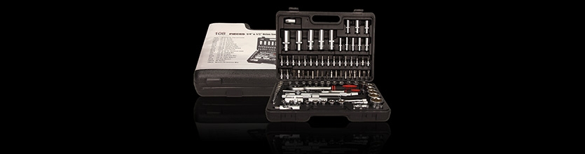

    Hello. I bought a Honiton 94 elements suitcase a few years ago. It is enough for an amateur. Regards

    I have the Honiton set myself, I bought them for my brother and friend. We are very pleased. Most often used with agricultural machinery and tractors. easy they don't have but no problems. They are not cheap because the set cost me about PLN 230 from 6 years ago, but it's worth the price. Recommended Affordable Car Repair Tool Brands & Sets: Yato, Craftsman, KS Tools, Husky, & Lidl
