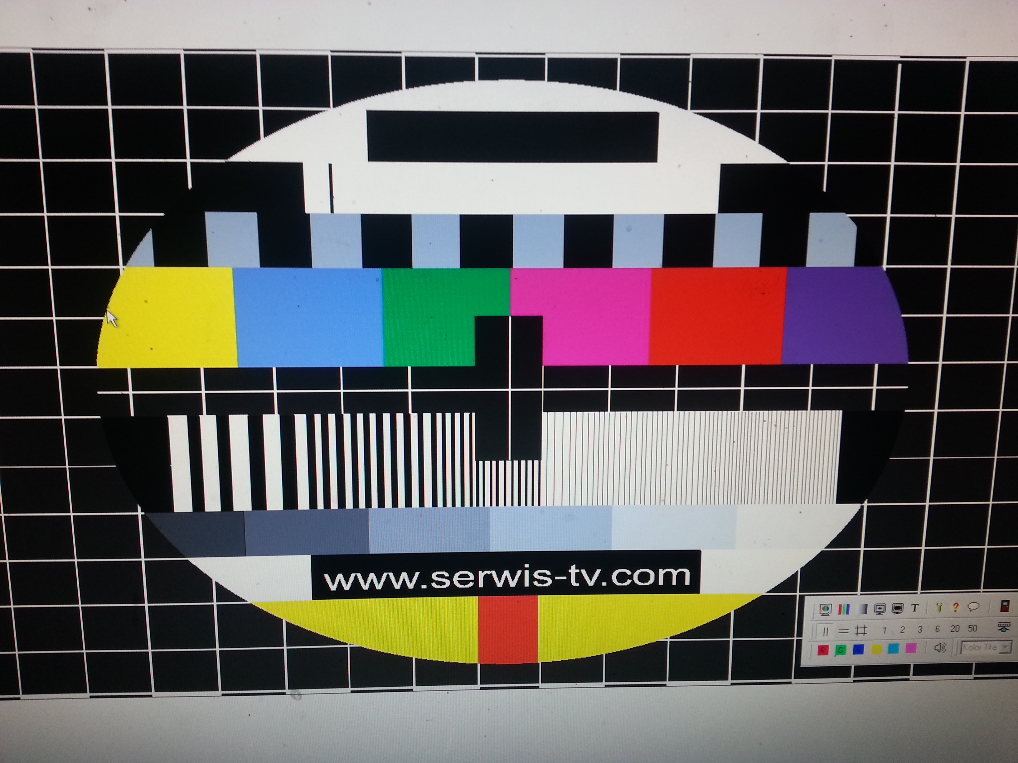

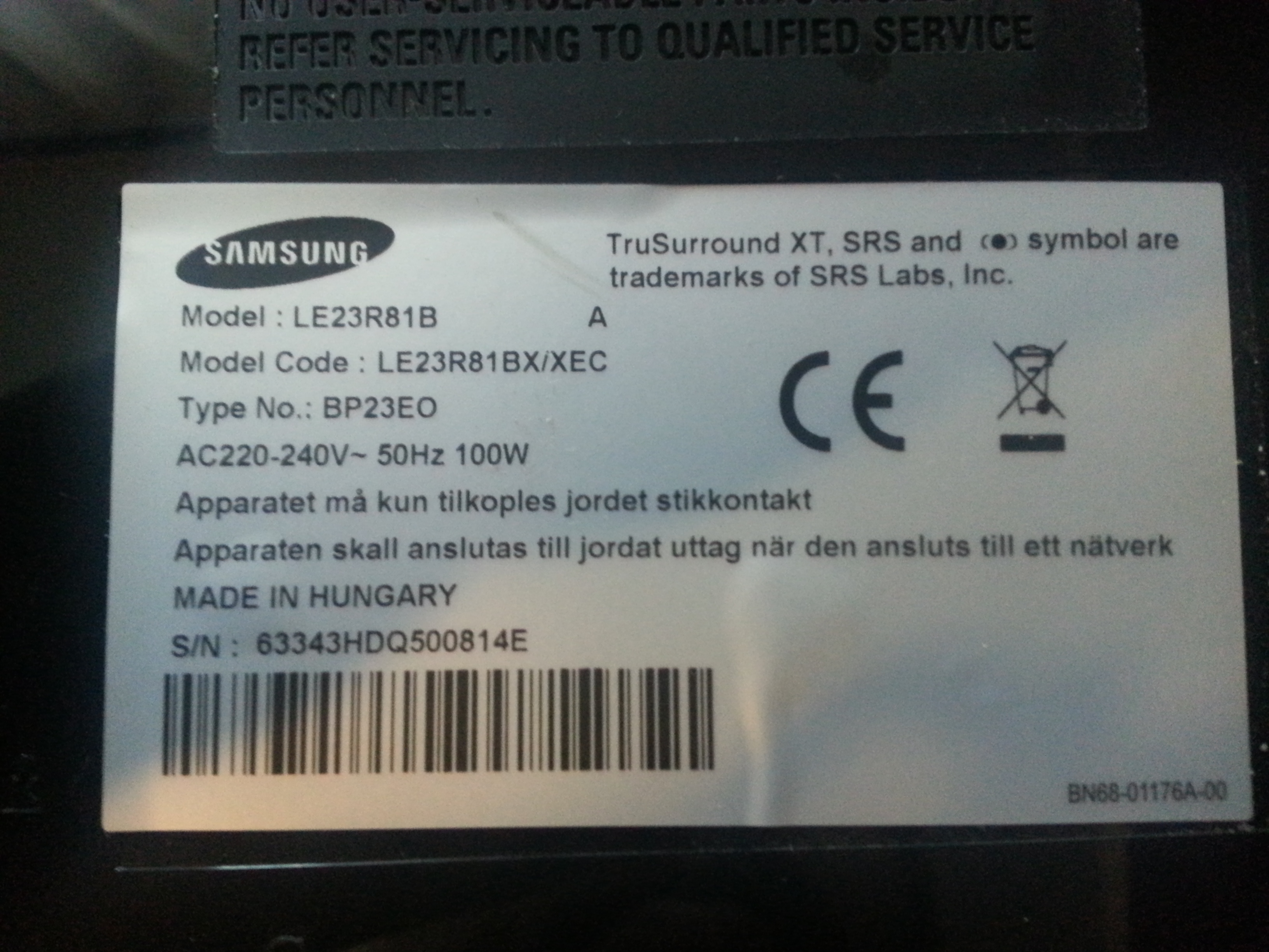

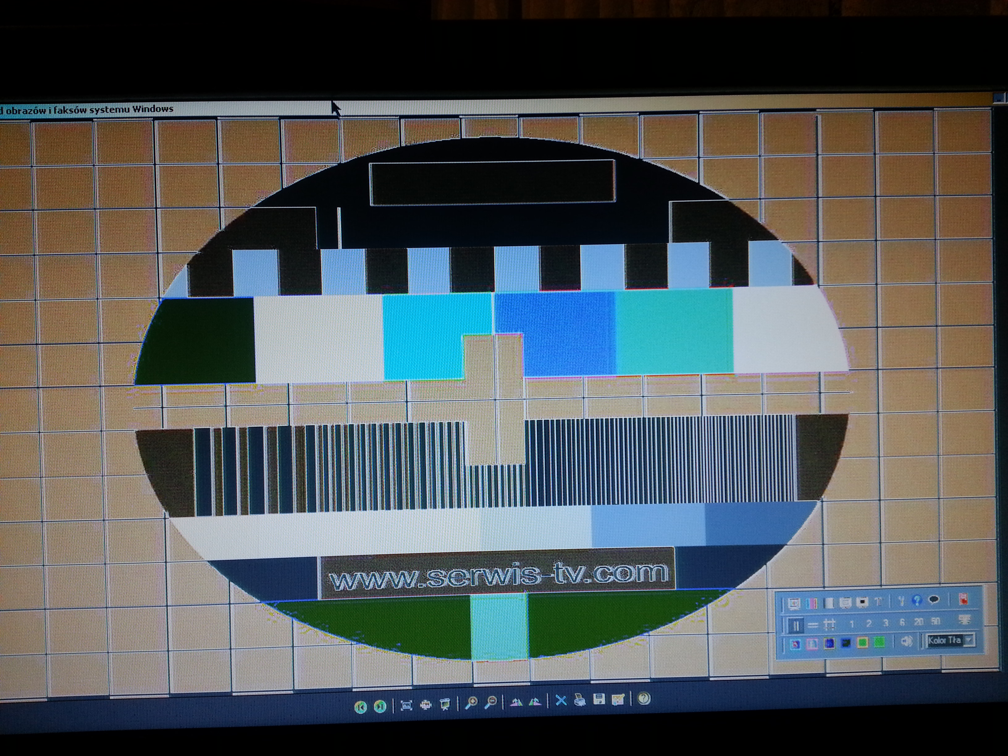

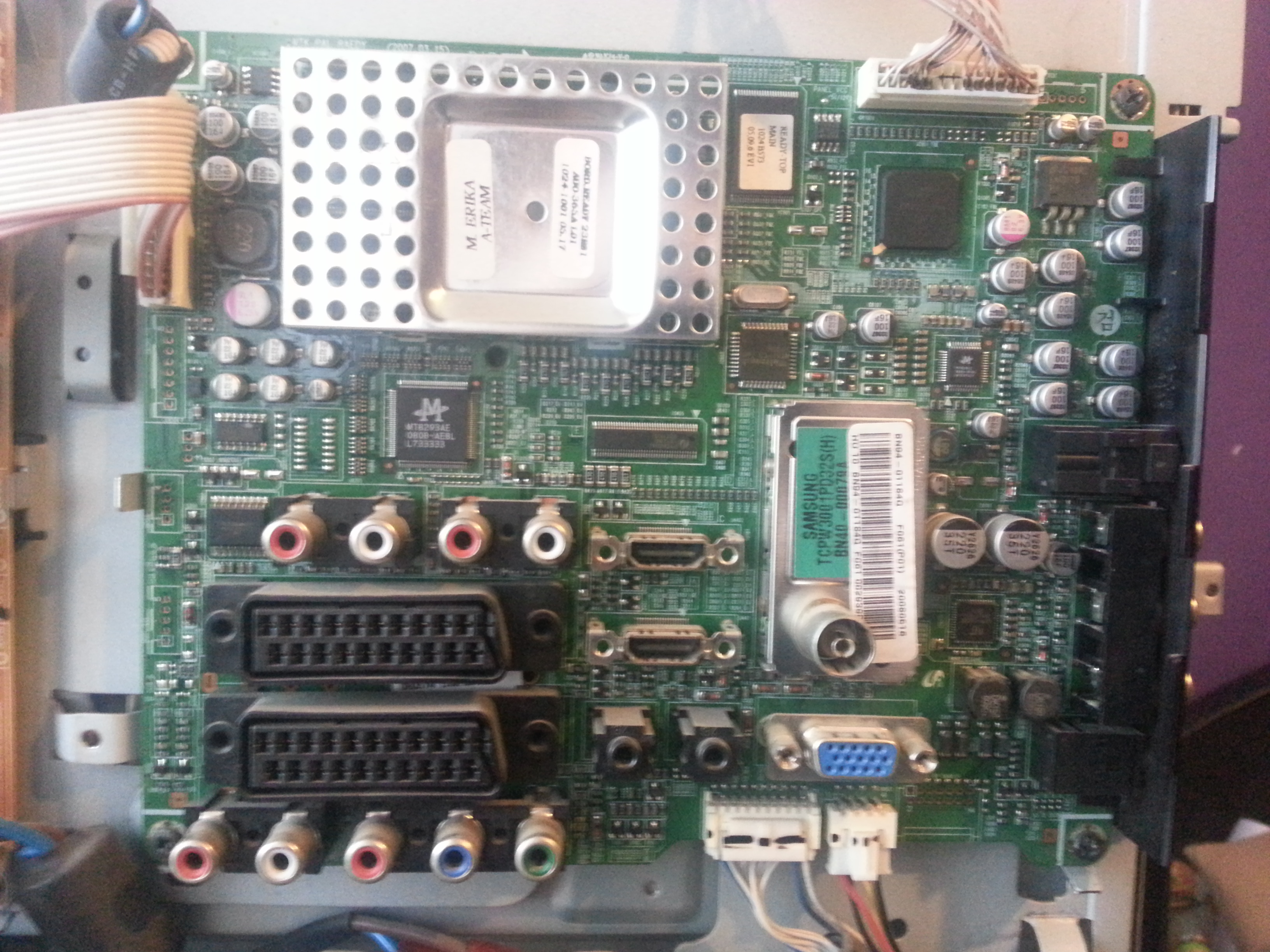

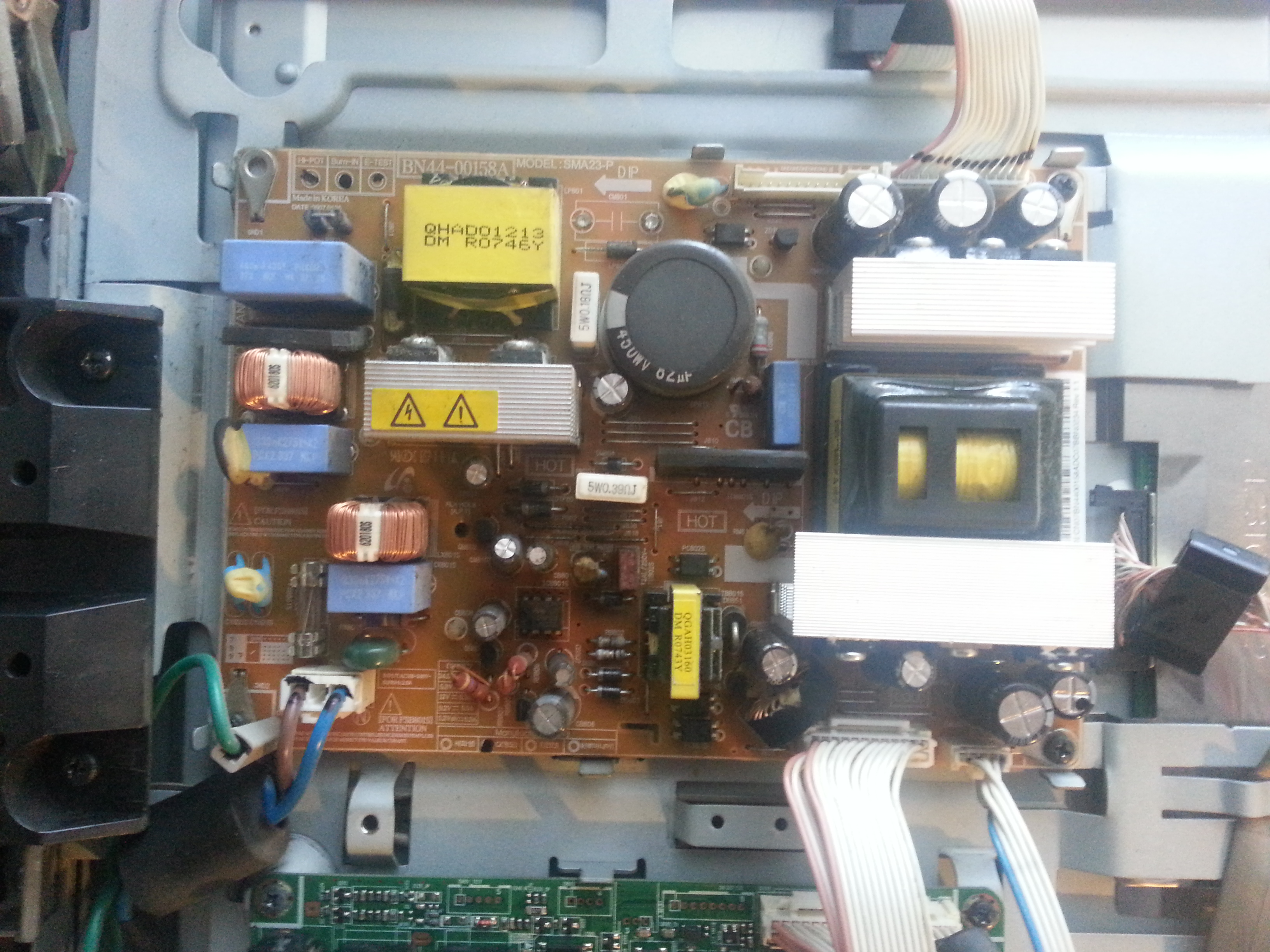

    Hello, I have a problem with the monitor, strange colors and an image that may be the reason.
    Monitor data:
    Samsung
    Model Code: LE23R81BX / XEC
    Type No .: BP23EO
    I am asking for help in making a diagnosis.
    • Samsung type-BP23EO model - LE23R81B swarm image with no colors. p__yta.jpg (1.4 MB) You must be logged in to download this attachment.
    • Samsung type-BP23EO model - LE23R81B swarm image with no colors. zasilanie.jpg (2.15 MB) You must be logged in to download this attachment.
    • Samsung type-BP23EO model - LE23R81B swarm image with no colors. tak_powinno_by__.jpg (1.88 MB) You must be logged in to download this attachment.
    • Samsung type-BP23EO model - LE23R81B swarm image with no colors. tak_wygl__da.jpg (1.81 MB) You must be logged in to download this attachment.

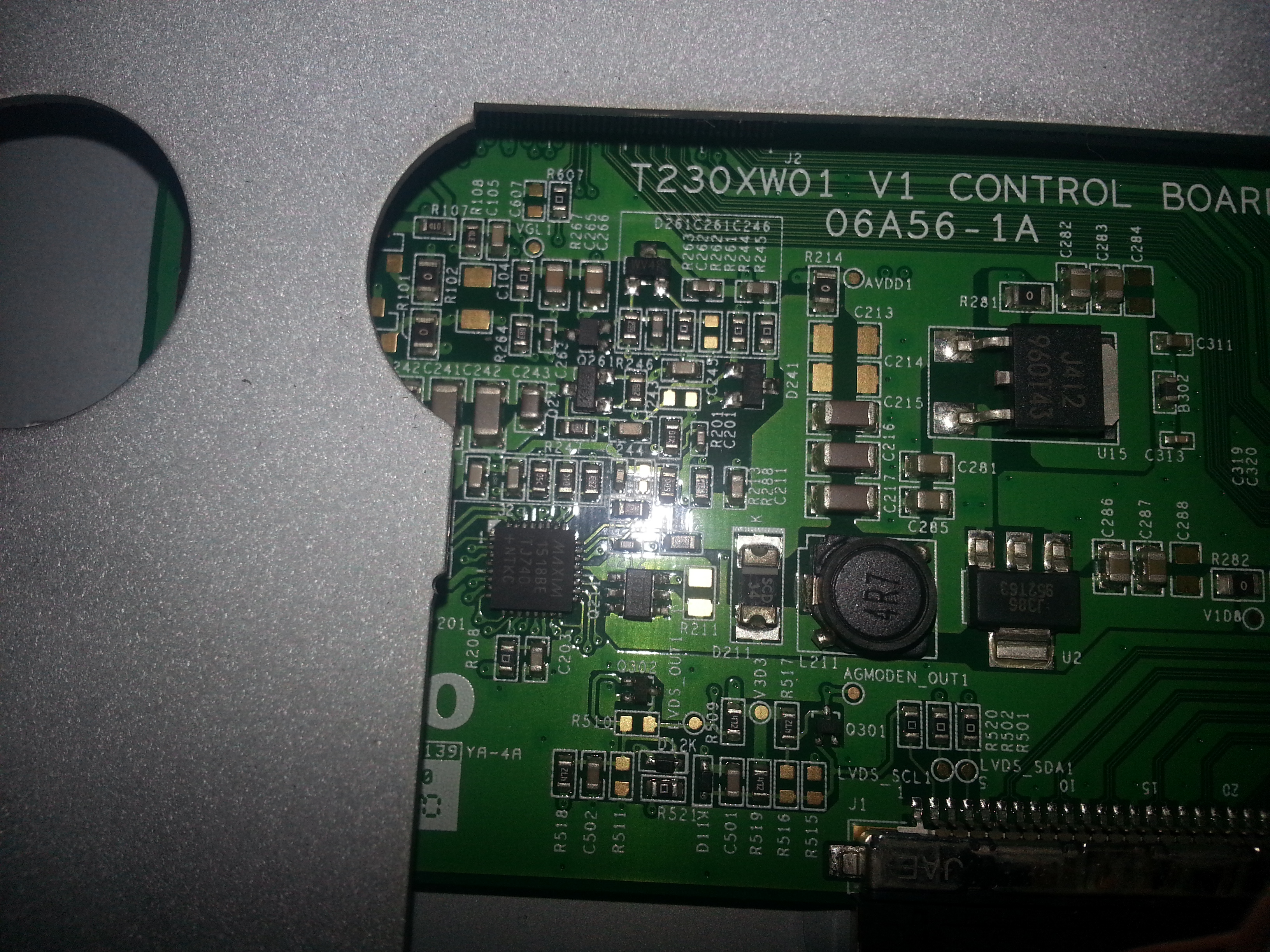

    T-COM T230XW01 v1
    • Samsung type-BP23EO model - LE23R81B swarm image with no colors. t-com.jpg (3.26 MB) You must be logged in to download this attachment.

  • #4 14413164
    lukasz2431
    Posts: 28
    Rate: 7
    Monitor data:
    Samsung
    Type No .: BP23EO
    On other entrances, too, is it swarming? If this is the case, I suggest to put the main tape into t-con. If it does not help, I bet in the background t-con
