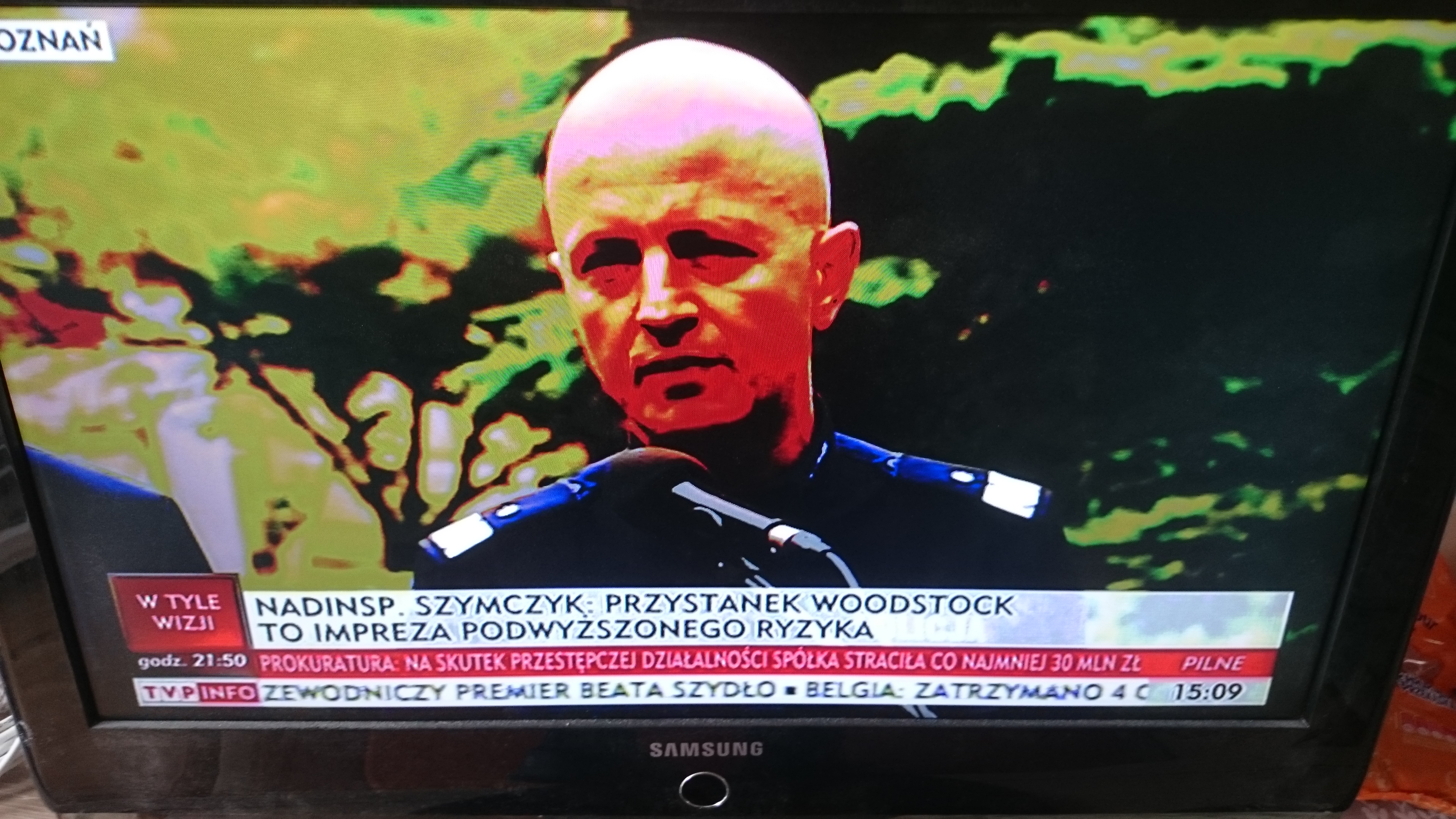

    Hello!
    LCD TV as in the topic, the symptom is as follows: TV plays, there is audio, but the picture is as if in sepia, has any of your colleagues processed something like that? Best regards and thank you in advance for any answers.

    Solarization. Damage with a wide aspect of searching - LVDS tape, T-CON, motherboard on the matrix.

    So where should I start looking at the beginning?

    If you do not have a matrix replacement, T-CON or at least tape to be able to eliminate various possibilities, then you have nothing to look for.
