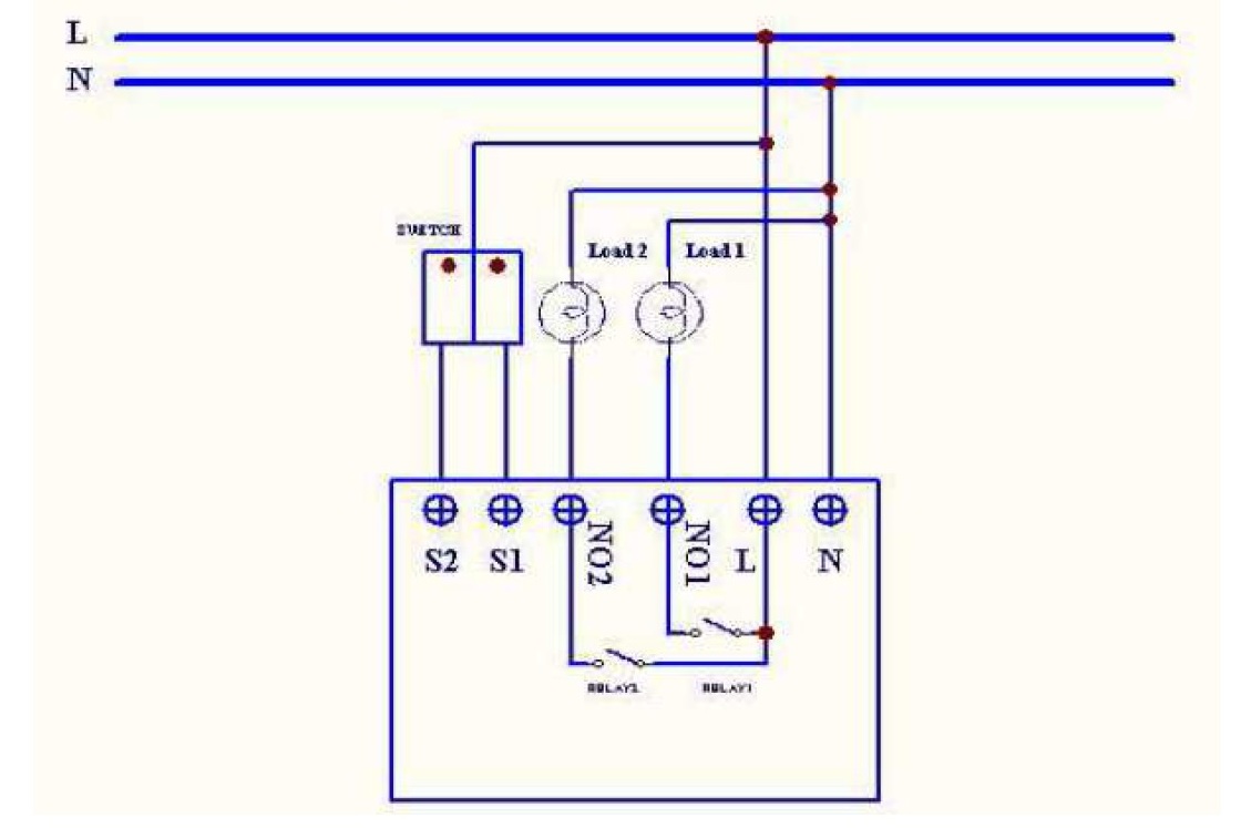

    Hi. I bought a z-wave switch and I don't know how to connect it in the socket.
    I have the instructions for it:
    http://www.philio-tech.com/pdf/PAN04.pdf
    with a diagram
    How do I connect the z-wave PAN04 switch to a socket with two wires?
    There are two wires sticking out of the wall, as is usual in sockets (Blue N and Brown phase L). How do I connect all this correctly, including the switch, so that the equipment works properly and I don't accidentally burn it when connecting it. (I only want to connect one button and one light source)
    If I understand correctly, I must connect the wires like this:
    However, the question now arises whether this is all ? Shouldn't something be connected to N01 ?

    Problem solved. The only thing I found was that in order to make it work I had to connect another wire to the power socket, i.e. zero. Without this [wire] the problem was impossible to solve with this equipment.

    Instead of pulling the cable, it was sufficient to plug the device directly into the ceiling rosette :)
