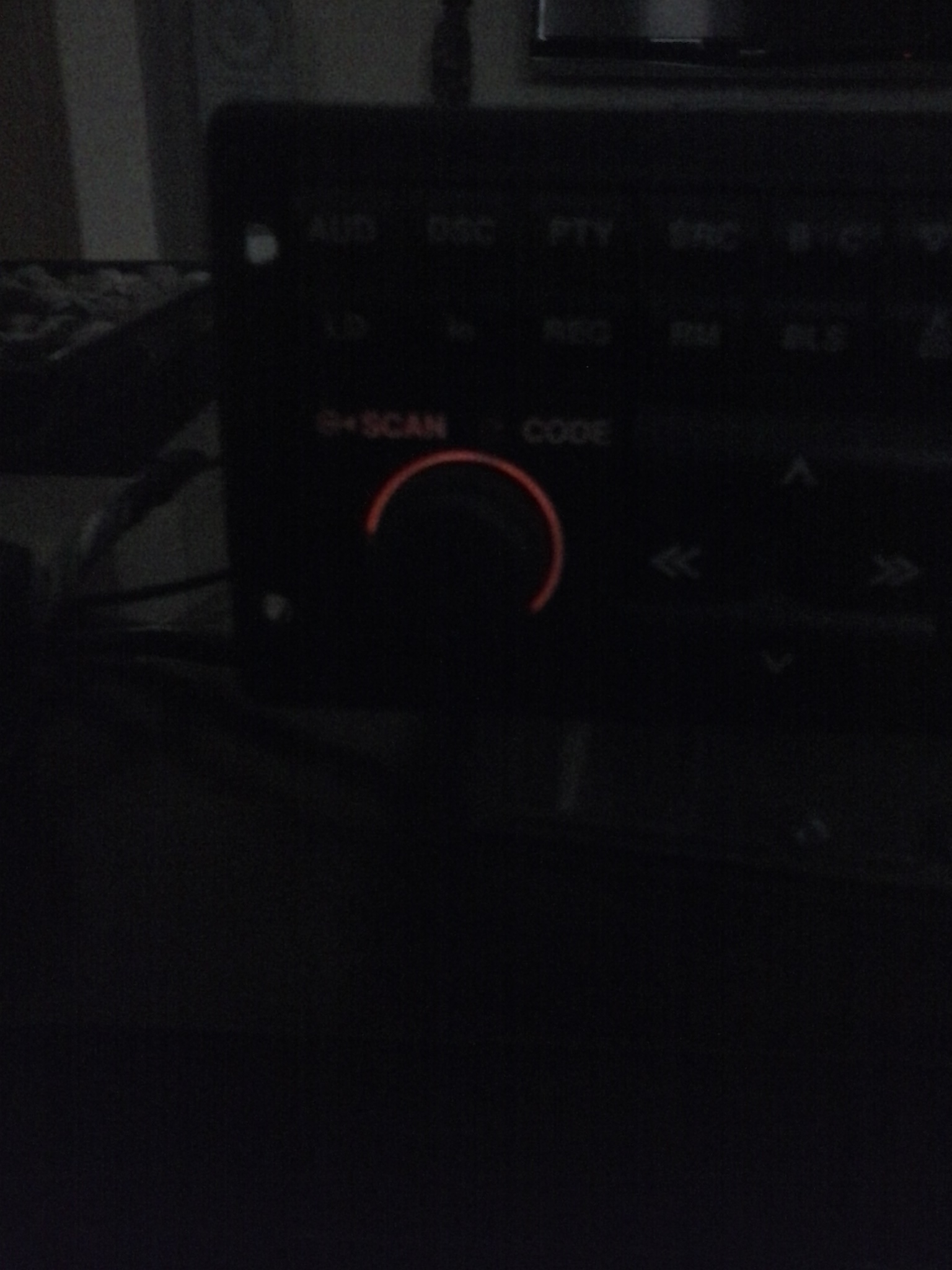

    Hello friends, anybody can help me with this radio?
    If i connect current to radio anything happend, i put current in acc+,bat+ and negative
    If i connect current to acc+, ANT+ and negative, switch button light goes on but is the only thing
    I searched online and i saw problems with capacitors for this model ,i changed capacitors but all is same.
    Are others capacitors or is other thing?
    Thanks

    Hi try to put 4 +
    Regards

    Hello. I think you have to follow the wiring from the connector to the capacitors, and if you have an oscilloscope, measure the voltage and the ripple. Be sure to connect the voltage on the right pin, the ANT is generally an output for supplying an external electric antenna. If you put any voltage in here, you risk damaging the appliance. Do you have the schematic? Often these schematics are available in Fiat-Ford audio search criteria...

    Sorry for not answering before, how is the connection 4? I have already tried everything
