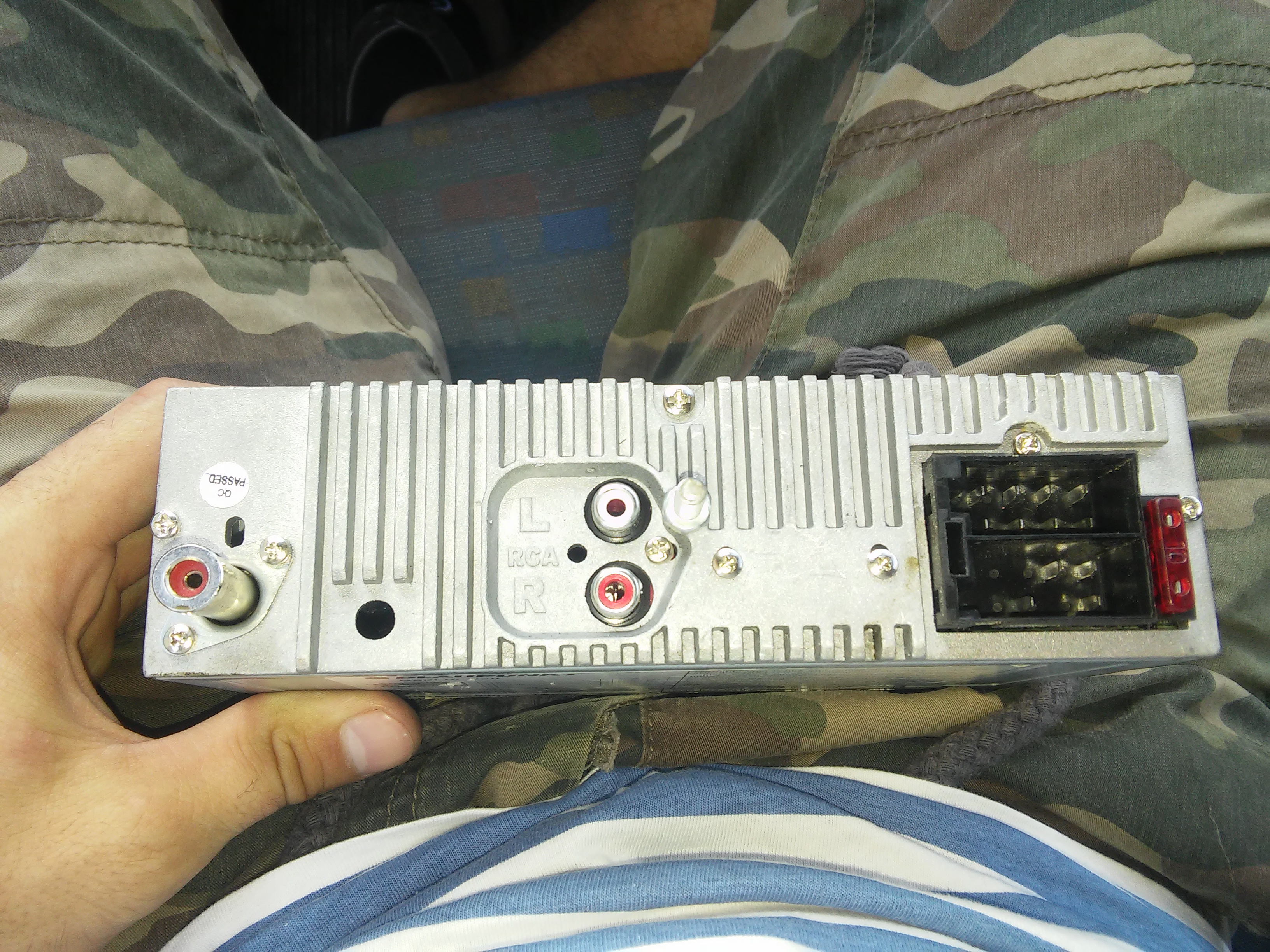

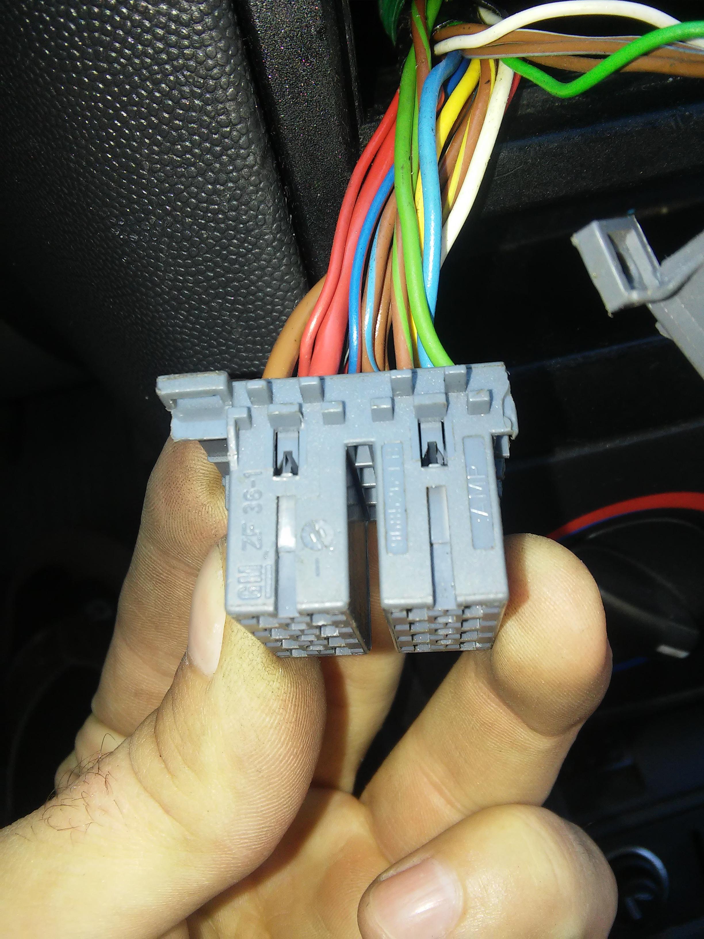

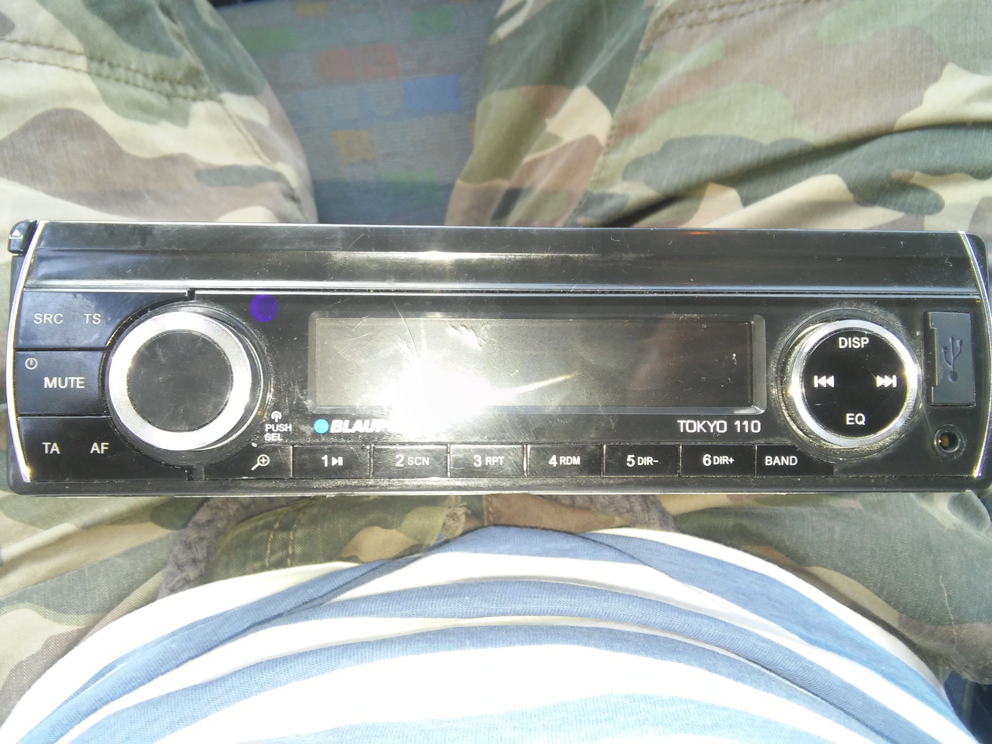

    Hello, I have a problem with connecting the Blaupunkt tokyo 110 radio in the Opel Corsa C 2000 car. The cube looks original as in the photos. The current is with the key pulled out and turned. The fuse responsible for the radio according to the diagram is ok, the fuse on the radio too. Radio wgl does not turn on, does not respond. Please help 7

    #2 16643351
    gumisie
    Posts: 17873
    Help: 1667
    Rate: 2480
    Hello, and what about the second plus (pin 7 of the ISO cube). For proper operation of the radio, two voltage (+) pins are needed. 4, pin. 7, yellow wire.
    Best regards.

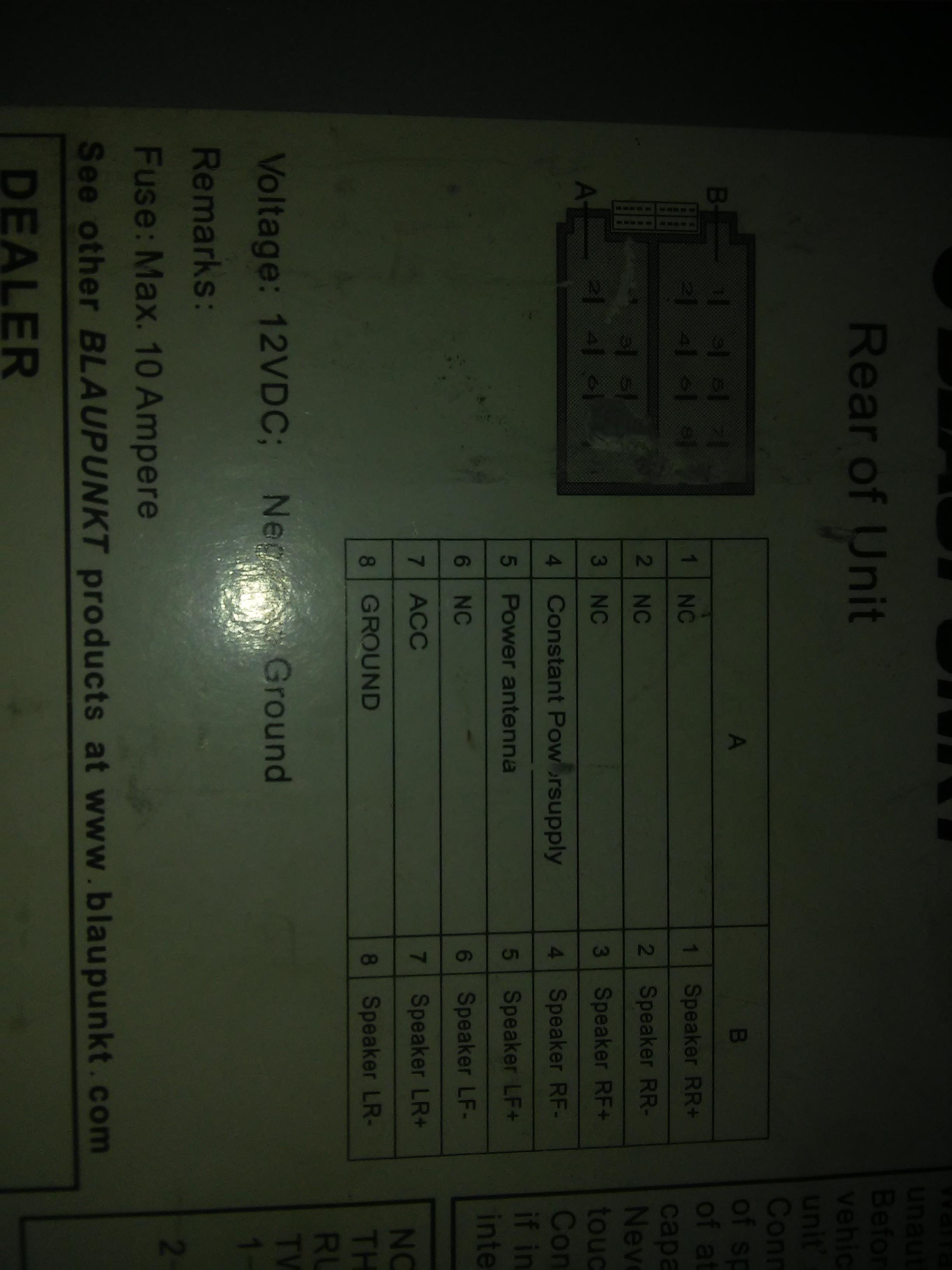

    gumisie wrote:
    For proper operation of the radio, two voltage (+) pins are needed. 4, pin. 6,
    I think that 2x + 12V should be on pin 4 (permanent) and pin 7 (after turning on the ignition).

    gumisie wrote:
    Hello, and what about the second plus (pin 6 of the ISO cube). For proper operation of the radio, two voltage (+) pins are needed. 4, pin. 6, yellow wire.
    Best regards.
    The yellow cable is plugged into the pin. 14 and there is no voltage on it, under the pin. 6 I do not have any cable plugged in, there is also no contact under this socket on the radio.
    I add the radio connection diagram, does anyone have a diagram of the iso cube installation for this corsa?
    There is no such pin in the ISO bone, max is No. 8. There are two ISO bones in the car and both are 8-pin, one for power supply and the other for speaker.

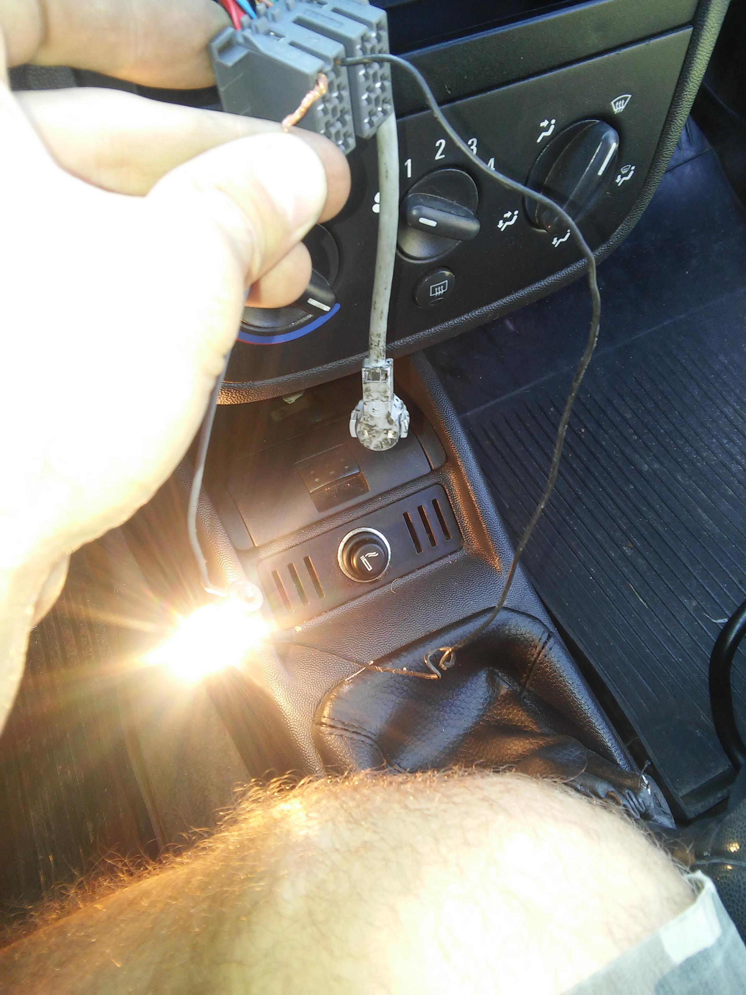

    I have no voltage under pin 7, even after turning the key, what to do with it? Where to get the tension after turning the key?
    I connected the constant and variable voltage for a short time, the radio works, I connected the electricity from the lighter and everything works, thank you for your help. Best regards.
    Go to a proven car electrician and connect this pin 7 with pin 4 (permanently).

    Fifiopel256
    Posts: 7
    The cube fastened as the boys wrote above, I pulled the electricity from the lighter, everything works as it should.
