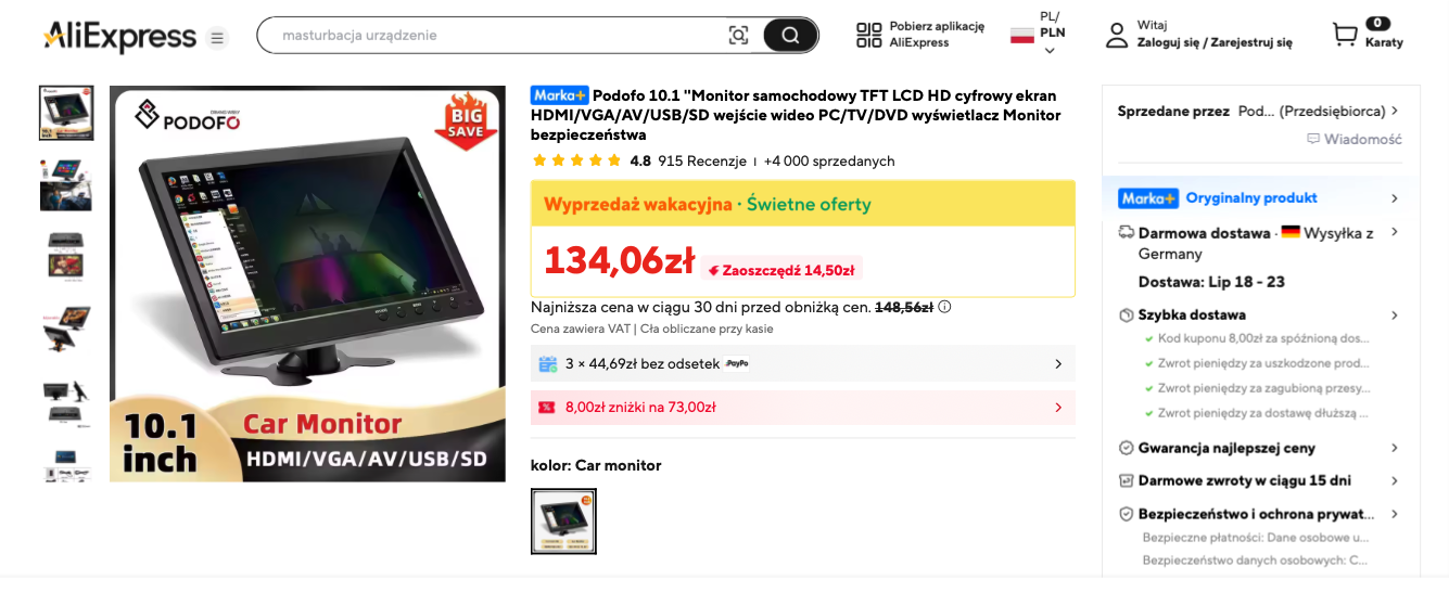

    Preskaler
    Level 40  
    Posts: 6432
    Help: 492
    Rate: 1057
    If the Moderator doesn’t mind us digging up an old thread, I can see the simplest solution.
    AliExpress product page screenshot for a Podofo 10.1-inch car monitor priced at 134.06 zł.
