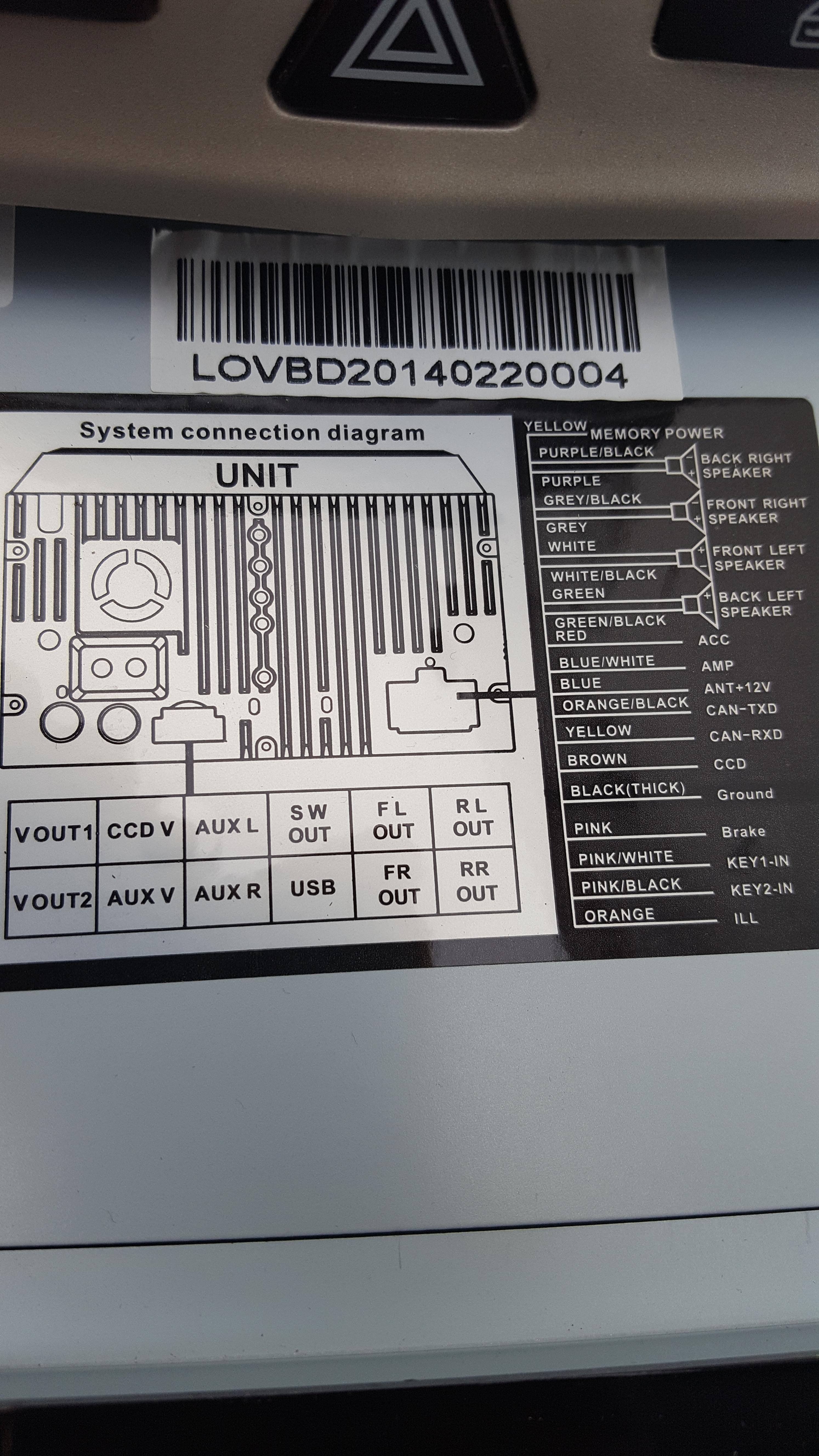

    I bought a car with this radio.radio 2 din Chinese company after the diagram do not know where to put cinch with video camera. Will you help me?

    On the black side you have a CCD, that's it ;-)

    Well ok, but no clothes, no cinch from her and this white cube on the left side? There are 20 pins in it. I will also say that in the settings I have as a back-up camera. And the CCD is not a changer by accident?

    Not on the black only on the white-CCD V, on the black side flies a brown CCD cable, it's a plus from the reverse.

    Then you could explain it to me how I can connect it. On the right side I have white cubes and in it ccdv ia after black ccd on a brown cable and let's assume that plus from quiet I put on ccd and minus on ccdv?

    On the CCD V you give the VIDEO signal from the camera, on the CCD cable you enter the plus after switching back on (it can be from a light bulb)
