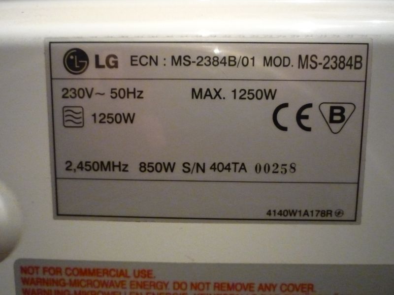

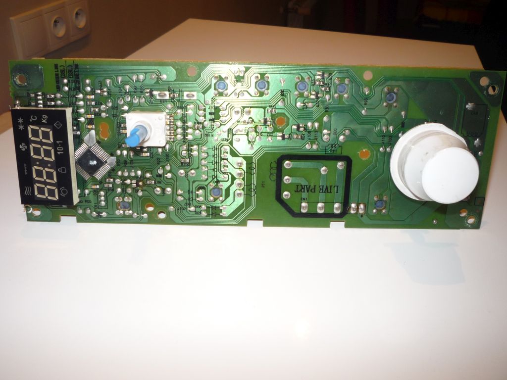

    The microwave display has been switching off for some time. Sometimes it did not work, but after some time it started to work. Currently nothing is visible on the display. In the pictures, a plate from this pattern.

    There was no power on the display. I replaced the capacitor. It's currently working and it's OK.
    I close the topic.
