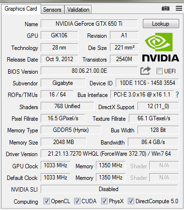

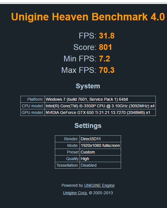

    Okay, first the description of the problem:
    -When turning on the computer after the night (sometimes also after the monitor goes into sleep mode during the day) the monitor blinks instead of turning on normally. You can't turn it off with the button then, and turning on the PC first and then the monitor also has no effect. Blinks so that the image appears for 2 seconds and then disappears. After rebooting the PC when it is already working, the flashing does not occur.
    -Often when playing, e.g. in CS:GO, the graphics card seems to cut off the signal to the monitor and then the sound from CS:GO is jammed, but after 5 seconds it returns to normal, although the card turned off twice during the game (sound from the game looped, the sound from TS3 was working normally) and it didn't want to go back to working and a reset was needed.
    My attempts at diagnosis:
    -I connected the HDMI cable instead of D-SUB - the problem persisted.
    -I connected an old computer instead of mine - the problem persisted.
    -After disconnecting the D-SUB/HDMI cable, the monitor normally turns on and shows that it is looking for a signal (then somehow the monitor works normally...)
    My gear (already has some):
    i5-3350P processor
    GTX 650 Ti graphics card
    Antec VP 500 power supply (yes, I know it's too powerful for that)
    Thanks in advance for your help, I have no idea what's going wrong.
