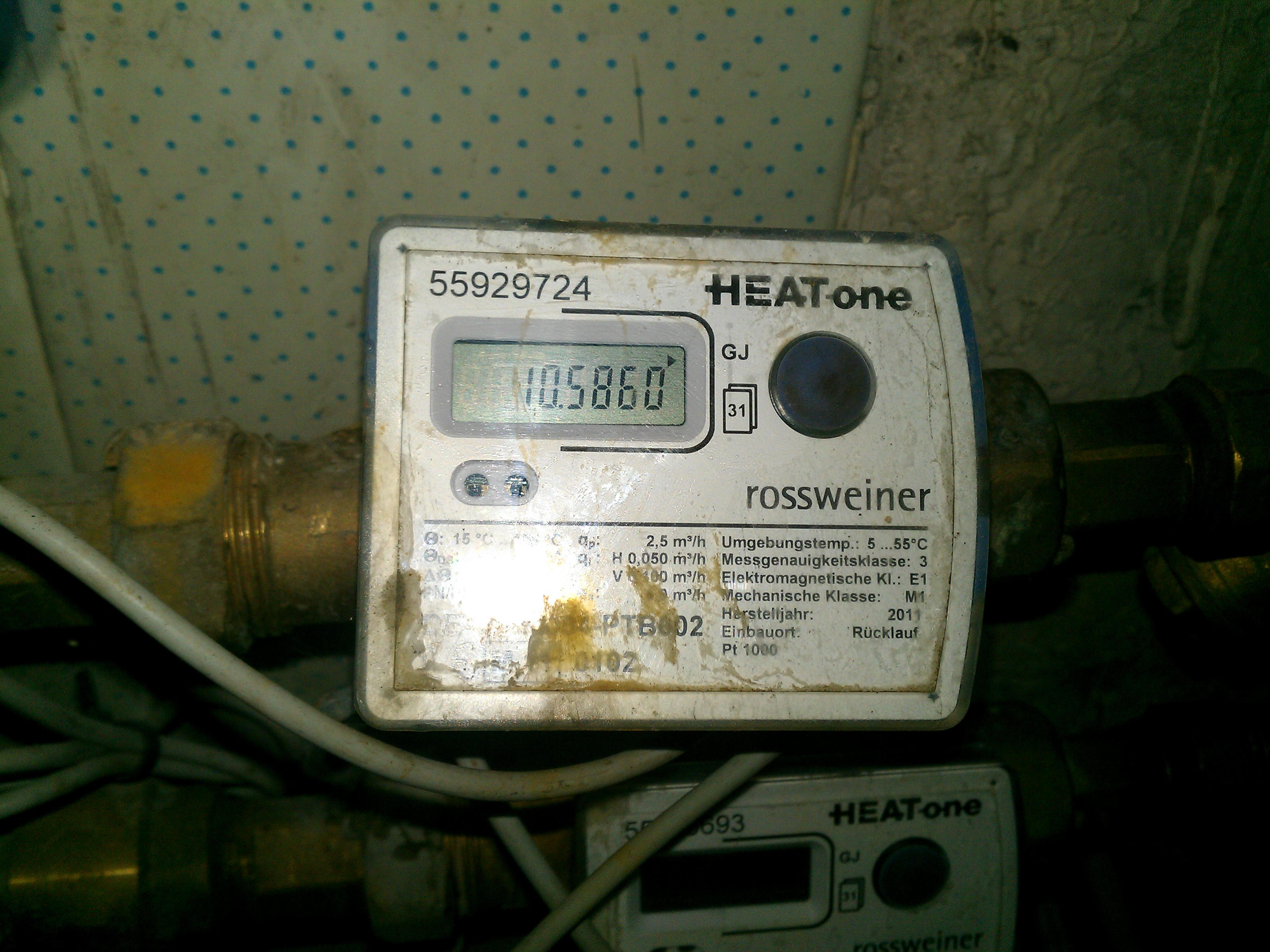

    Hello, I have a rossweiner DE-10-MI004-PTB002 heat one heat meter. I am completely green and I don't know which numbers indicate the heat consumption. He shares a house with a neighbor, we have 2 of them. He is at home and I am at home. I have a photo taken before the heating season and after and the numbers are different also some measurement is for sure. But which one and how do I calculate how much gas I used to heat the house on the basis of these numbers? Advice as you can.

    Those marked with GJ.

    Thanks for the answer, and especially for the instructions, because that's what I was looking for. How to calculate now how much gas went to heat the house? I was looking in google but I did not find any specific solution. Add something, multiply?

    I found on the website http://oferta.pgnig.pl/czy-jest-gaz-ziemny because we get gas from them, the gas values provided by them. "calorific value - not less than 31.0 MJ / m3 1)". We have a Brotje WBS 22C condensing furnace. According to this website http://www.ogrzewany.pl/product/Kociol-kondensacyjny-EcoTherm-Kompakt-WBS-22-E/?id=1779. The furnace appears to have an efficiency of 109%. The numbers from before the heating season are 0.5512 from October 21 and after - 10.5860 to April 8. According to this page, what you gave the formula to calculate is 31 MJ / (divided by 3600 seconds, i.e. an hour) 3600s = 8.6111 kWh from m3 of gas. And these 8.6111 kWh multiplied by 10.0348? I subtracted 0.5512 from this final value. I don't know if I understood correctly :-) . We also heat water with gas and boil it. I do not know if there is any division into gas used for heating utility water. Surely there is no meter by the gas stove.

    The heat consumption is: 10.586GJ - 0.5512GJ = 10.03GJ or 10,035 MJ
    10 035 MJ / 31 MJ = 323.7 m3 of gas. Efficiency above 100% will only be provided when several conditions are met, including at full load, with condensing boiler operation, which is not always the case. This is catalog data, not actual data. The conversion above is only approximate, not super accurate.

    Not enough data. If you have one storage tank in common and there is no third meter that would count the heat for heating domestic hot water, then any calculations do not make sense.

    I understand, but at least I know how much energy the heaters themselves used, and this already gives a resultant sum. Anyway, thanks for your interest and answer.

    Heating water is sometimes a big part of the bill. In one family, two people use the shower briefly, in the other four people use a large bathtub. If you had at least a meter accounting for hot water consumption, you will determine the gas consumption and the distribution ratio during the summer, when the heating is turned off. There will of course be an error due to temperature differences among others, but you will be closer than now.
