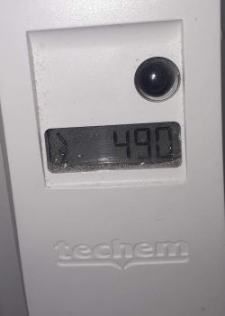

    Hi
    I recently changed my flat in Germany and I have this contraption on the radiator. Am I able to somehow tell if I have used a lot? (yes, I know, they do not measure the actual consumption, only the temperature difference, if I understand correctly)
    I get 3 readings over and over there
    The first one is verbrauch, i.e. wear (at the beginning I had 302). Do you know if it's a lot or a little?
    Heat Allocator in Germany: Reading Interpretation, Verbrauch, Radiator & Temperature Difference
    And I don't understand this reading.
    There was a third one with the device number.
    Regards and thank you for your help.

    The indications on which there is a drawing and a pencil are archival indications (from last year). The latter is the current consumption in a given year. The third indicated is actually the device number. It is difficult to judge whether high or low consumption. If the archives for the whole last year were 490 and now for January (3 weeks) you already have 165, it is not known how much will be until the end of this winter and at the end of the year.
    Izusek wrote:
    (at the beginning I was 302)
    I don't understand that. At the beginning of what, what period or when. I do not know if your accounting period is also "calendar year" but you have to find out for yourself. We have a "calendar year" to be settled.
    And one more thing
    No - this is a normal cost allocator with units. Come in here Link and you will read how it is accounted for.

    At the beginning, i.e. when I moved in in October 2018, the reading from the counter which is now 490 was 302 (this reading was entered when taking over the apartment as consumption) ".
    And the one from the second display, which is 165, was not saved at all. I wrote it down myself and it was 689.

    Izusek wrote:
    October 2018 is the reading from the counter, which is now 490, it was 302
    If so, it means that from October 2018 to the end of December it gained 188 units (490-302). This state (490) is saved in the memory at the end of 2018.
    So this is a different factor (not the one from the first photo). You saved 689 in October, now wait for it to display the year-end status. Write down the indications as the pencil appears (this upper mark).
  • #9 17722593

    Then write it again one by one. You get the reading from one factor.
    1. When you had 302. Historical record is 490 at the end of 2018 (1 photo).
    2. When did you save 689.
    3. From the current recording it appears that you already have 165 (2nd photo).
    Because otherwise we will not come to an agreement. As you write, there cannot be three different indications from one divisor.

    So these readings I gave are from one device.
    1. When taking over the apartment, only the reading that is now "490" was written down (with the entry it was "302")
    2. And the one from the second photo is not recorded in the documents of the takeover and WAS "689", and IS now "165" (weirdly either goes backwards or circled, I don't understand this measurement)
    In the living room, I also have such a device (living room with kitchen), the readings are as follows:
    1. And there was also one reading, i.e. consumption IS "1163" ... WAS "1157" (they were not unscrewed at all, change from cooking in the kitchen)
    2. And the second reading, which was also not written and I don't understand it IS "1" ... WAS "2676"
    By the way, thank you for your commitment and for trying to help.

    I still don't understand your records. Briefly write like this:
    First condition allocator ...... date ........., archival entry (a stamp with a pencil) ........, present indications .......
    Second state allocator ........ date ........., archival entry (a stamp with a pencil) ......., present indications ..........
    Third condition allocator ........ date .........., archival entry (a stamp with a pencil) ......., present indications .........
    Cost allocator ..........
    Indications with a mark is the entry at the end of 2018, indications without a mark (pencil) are the current entry.
    The data recorded in this way can tell me more than your description.

    I thought about what you wrote earlier and I think it is correct.
    Number one allocator. For 2017 it was 689, for 2018 it is 490 (with a pencil), and the current state (without a pencil) is 165
    At the introduction on 10.2018, I had 302, i.e. it increased by 490-302 = 188. So I got these 188 from 10.2018 to 2019. Then the counter reset, if I think correctly. And to these 188 I have to add the current entry 188 + 165
    So the number that the pencil is at will be the same by the end of the year? And in its place will be how much is currently on the meter without a pencil?
    Number two. For 2017 it was 2676, for 2018 it is 1663 (with a pencil), and the current state is 1
    With the introduction on 10.2018, I had 1157, i.e. it increased by only 6 because it was turned off.

    Your reflection is correct. So I hope that I helped you solve the puzzle with the displayed numbers on the divisor.

    The divider has an internal calendar. No units are charged from June to August. In May and September, it counts half of the units it counts in full in the remaining months.
    The counting of units starts from the temperature of +19.5°C measured on the radiator and at the same time the difference between the radiator temperature and the ambient temperature measured according to the allocator is above 3.5°C. Of course, the greater the difference in these temperatures, the faster the heat consumption units are added. The rate of growth of the measured units is not constant, i.e. linear, but there were no specifics here.
    Therefore, you should close the radiator valve when airing, because then the temperature difference with an open window, especially during frost, especially severe frost, will be so large that the units will increase before your eyes. The smaller the temperature difference, the fewer units, so it is good not to cool the rooms. You need to find a reasonable compromise between the method of airing/ventilation and heating costs, because if you don't think it through, you can end up with very high costs. After the introduction of these allocators, previously there were evaporators, many residents in the block began to lose their minds due to the sudden increase in heating costs.
    The readings are made remotely by an administration employee. The read values are processed by the company that handles it. The administration has released parameters for each radiator, including its size and the area of the room it heats. There is probably also a factor depending on the location of the room in the block. Only all this together affects the calculation of heat consumption in one apartment and this is added to the heat consumption in the block, and therefore to the final settlement.

    We have infrared allocators, some phone models have an IRDA module, there is probably also a reading program, I would have better knowledge when, for example, during ventilation, the charging of values increases quickly...
  • Nonlinear allocator readings rise with radiator-room temperature difference
    #21 20828304
    dakam
    Posts: 30
    Rate: 7
    Certainly, the greater the temperature difference between the temperature of the place on the radiator to which the allocator is attached and the temperature at the allocator on the room side (it is possible that the allocator has an air inlet from the room at the bottom), the faster it counts the units. Taking into account the faster cooling of a hot element (here: a radiator) in cold air (here: in a room), the scale, i.e. the speed of calculation, should be higher, i.e. it will be a non-linear increasing function. Maintaining the smallest temperature difference between the allocator sensors is the only way to reduce heating costs. Even minor changes, such as airing for 1-2 minutes, especially in frosty weather, and the air from an open window flows onto the allocator (because cooler air always flows down as more dense, i.e. with a higher specific weight), result in additional units being added immediately, which is not equivalent to the heat consumption of the radiator. This is an imperfection of this method of "measuring" heat consumption. Therefore, common sense suggests avoiding such situations so as not to be burdened with additional costs that do not have an equivalent in the heat consumed.

    If I added an additional heat source to the premises, which would maintain a constant temperature in the premises at 28-30 degrees, while having two radiators turned off at all times, which are set to zero in this premises, would the TECHEM allocator not charge any units at all? "being aware" that someone else is generating the heat, not the radiator on which it is located?
  • Heat allocator counts only when radiator exceeds air temperature
    #23 20840746
    dakam
    Posts: 30
    Rate: 7
    I don't know whether the TECHEM allocator is "aware" of this. However, mine, probably manufactured in the southern part of Poland (or China), according to a description I once found in one of the companies that install them, would not charge heat in such a situation. The counting starts when the temperature received from the radiator, i.e. from the mounting welded during installation to the radiator, must be 3.5°C higher than the air temperature in the housing opening at the bottom front, looking at the radiator. I think this is the general principle of operation of this type of devices, although they probably differ slightly, e.g. in terms of temperature thresholds or the speed of counting units, which depends on this difference. And I suspect that the increase in units is not directly proportional to this difference, i.e. the larger the difference, the more it counts. The radiator accepts heat from an external source, but when the valve is closed it will not have a temperature higher than the surrounding air. So no divisor should charge anything. Of course, we assume that the heat source does not directly heat the radiator. If the sensor on the room side (hole in the casing) is warmer than the sensor connected to the radiator by a thermal bridge (mounting), the situation is as in summer, so there is no basis for calculating heat consumption. It seems so obvious that probably every allocator manufacturer accepts it as the basis for the operation of the device.

    pdusp wrote:
    the allocator has a diode for RFID transmission
    The diode has nothing to do with RFID.
