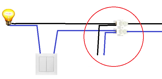

    i have motion sensors and would like to control the lights with them - here comes the problem. Where do I get the power supply for the light switch? If I connect the power supply, after all, I will close the circuit and the bulb will light up :/ Well, and I can't control the relay, because by disconnecting I will lose power. On the other hand, I know that Fibaro has a dimmer module which somehow circumvents this problem and plugs in instead of a switch. It is even possible to buy a bypass to be able to control low power (LEDs) . I'm an amateur at electronics, but I suspect that the power circuit draws negligible current and closing the circuit does not cause the bulb to light up.
    Any ideas on how to solve this? Is it possible to make/buy such a power supply that would be plugged in series with the bulb and in parallel with the relay? Then a small current feeds the control circuit and the relay controls the bulb.

    Well, yes it would be nice if I didn't have to rip up the walls for new cables for the switch. In the switch I only have the one, the blue one in your picture :(

    The light circuit is made so that one wire goes from a switch box somewhere under the ceiling to the switch, from the switch to the light point and from the light point to the switch box. In the switch box I have one wire that is interrupted by a switch, so that I close the circuit and the bulb lights up.
    In practice this is done so that two wires go from the switch box to the switch and two from the switch box to the light, but the result is that we have a loop interrupted by the switch.
    To the best of my knowledge this is how it is done in the construction industry here in Poland (the so-called 2-wire system, here it is outlined ), although I may have outdated information and now pull two wires from the switch box to the switch and two wires from the switch to the point (3-wire). That would take care of the problem, but that is not the case with me unfortunately.
    This is with the rest of the problem in z-wave modules for lighting control. In Poland, only the dimmer from Fibaro works because it works with the 2-wire system, as I wrote in the first post. The rest require a 3-wire system, or are only suitable for sockets.
    Now I've thought about putting the control in a distribution box, but from such a box the wires extend to several points, so it would be impossible to stuff several control modules in there. So we are back to the initial question.

    machmichgut wrote:
    Luke-O, then why is the whole of my flat as I drew it and the installation was done by expert installers? Who is misleading whom here?
    If in your case the blue wire is interrupted by a switch, then either you have a phase on the blue - which is a reprehensible error, or the switch interrupts the N track - which is an even bigger error.
    You have been misled.
    Wire colours:
    1. Brown and black are "phase" (L).
    2. Blue is "neutral" (N).
    3. Yellow and green is 'protective' (PE).
    In addition, the "phase" should be connected to the bottom of the bulb (via the switch) and the "neutral" to the thread (permanently).
    Any further questions?

    You have two states:
    I) Switch disconnected (light off).
    In the switch box you have power available and two problems. The first is that the voltage is reduced by a small size power supply. You can solve this analogously as given in II (in parallel with the switch) plus a current limiting resistor. The second problem is to make the current flow through the light source not cause it to glow or flash. This is where the bypass mentioned in #1, i.e. a capacitor connected in parallel with the light source, can help. I would also limit the current drawn and use a capacitor or supercapacitor as energy storage.
    II) Switch on (light on).
    You can gain a few volts from the voltage drop e.g. on diodes switched in series with the switch, as here:
    Light switch - how to make an indication that it is on
    The relay draws a few milliamps. Perhaps it would be better to replace it with a solid state component?

    What voltage and amperage do you need to power the circuit? What light source will you be driving?
    Before you write, think about eliminating the relay, using low-voltage and energy-saving components, sleep modes, etc. How about using some kind of energy storage, such as a capacitor (supercapacitor) for increased energy demand (switching of the control element, wireless communication)? I would remind you that the current consumed by the control system has a direct impact on possible problems with e.g. LED lights - hence the need for "bypasses".
    All components must fit into a limited space. It is also necessary to keep the right distances and use components with the right parameters - so that there is no overvoltage.
    Some, or all, of the components will operate at a potential to earth close to the mains voltage. You wrote that you have already made sensors - I took this to mean that you have a good "feel" for electronics. Are you sure you want to make such a controller yourself? But maybe in this particular case it would be simpler to buy a ready-made one (little space, high voltage)?

    Unfortunately, if the installation is done by amateurs, this is the result.
    Modern installations are carried out by running a full three-wire power cable to the light switch box and leading either a three-wire or four-wire cable out of it as required.
    The blue and yellow-green wires are connected respectively with wago connectors at the bottom of the box, while the phase wires are short-circuited by the switch. Any switch.
    In this way we always have access to a full, safe power supply in the breaker box.
