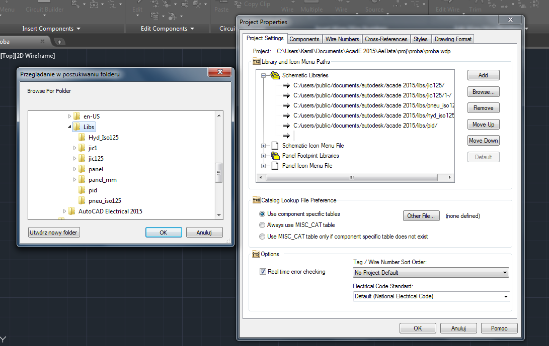

    To change the symbol library, right-click on a given project in the Project Manager and select Properties ... from the drop-down list. The window will appear and in the Project Settings tab there are paths to the symbol library.

    Thanks for the hints. I tried the changes in the right place, unfortunately I don't have libraries like IEC in the Libs folder. :|
    AutoCAD Electrical 2015: How to Access Electrical Symbols, Diagrams & Libraries for Student Version
    Okay, I had the IEC option checked during installation. Despite this, there are no symbols like in the first post. It's hard to start completing my own elements. Thank you for your willingness and help :wink:
