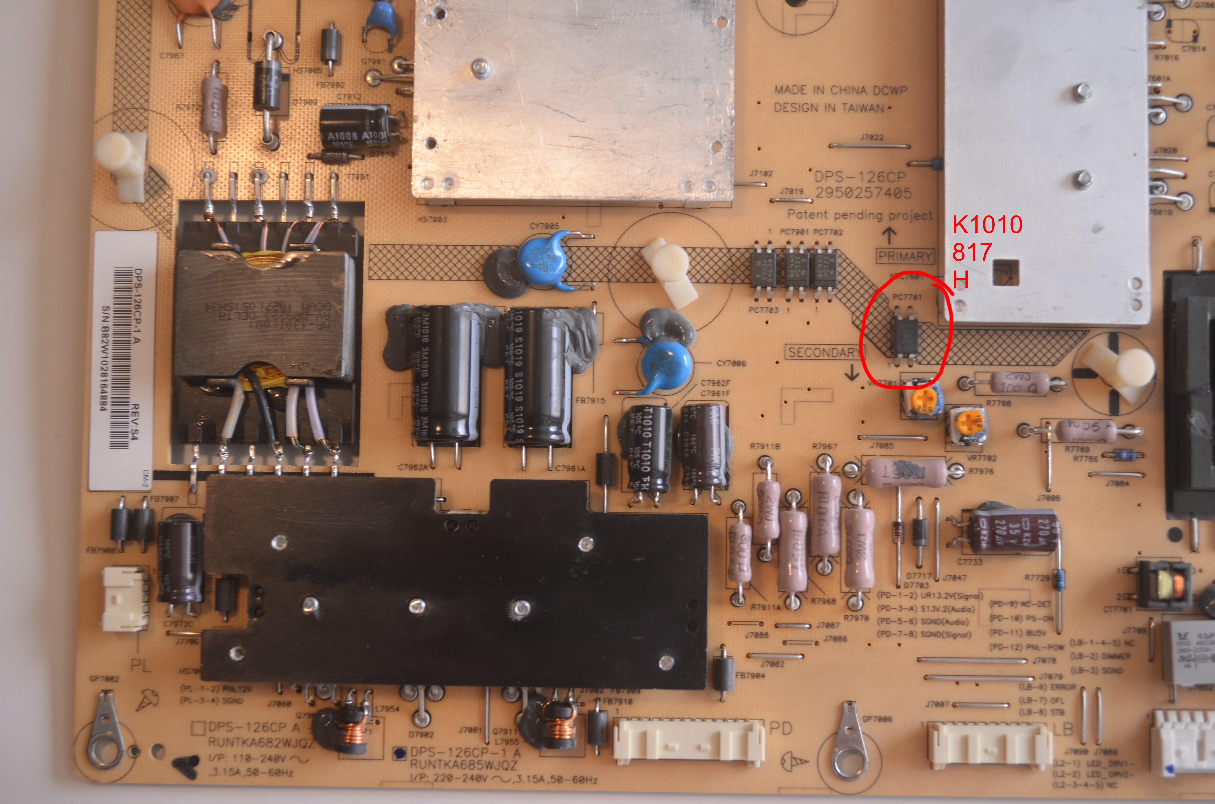

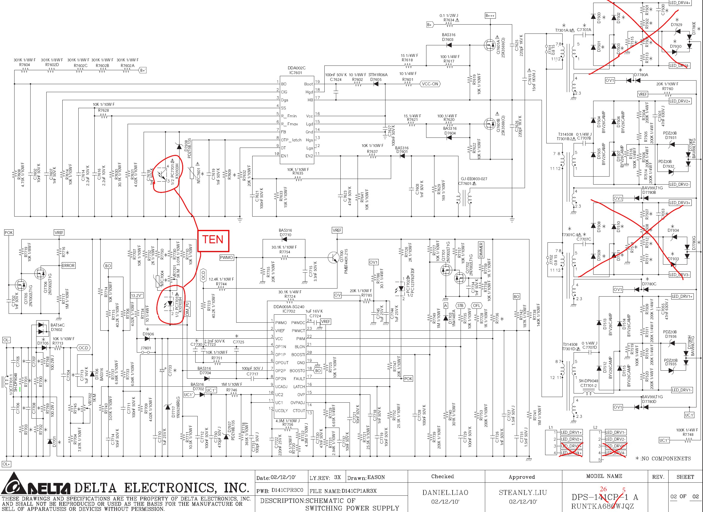

    Kley
    According to the diagram, the transoptor is responsible for information about the brightness of the backlight. From the motherboard goes information about how clearly the matrix should be illuminated. The matrix's backlight is 200-300V, so as you can see in the picture, the optocoupler sits on the line separating the low voltage from the high one.
    Take a hairdryer - heat it. Warming up, it starts to flash and when you overheat it all should be brightened - at least it did.
    The original K1010 H is not available in Poland - on the alibaba you can see that someone from Poland is buying it, I suppose that an important parameter is the CTR about which the letter H speaks - I can not find anywhere the CTR range for H.
    As for the exchange I bought for PLN 1.5 PC817 C - because it was in the store. Everything works, but as I have set the automatic brightness, sometimes I see the extreme brightening or darkening jump which was previously very smooth and unnoticeable. Of course, I additionally left the windmill on the casing but without it, too, it is ok.
    I will mention that I took the TV to the site (Białystok winding), the serviceman said that he will not be ... and orders a new power supply - repair is not an option - price 1200-1500 + labor.

    CTR ( % ) dla K101 E to 50-600
    1. Current transfer ratio
    ( CTR:Min. 50% at IF=5mA VCE=5V ) Link
    • K1010H.pdf (117.87 KB) You must be logged in to download this attachment.

    Well, we are waiting for the next options - heat sink, stabilizer, other goodies under the heatsink, aging diodes, transoptor (especially overheated with astonishment that changes its parameters) ...

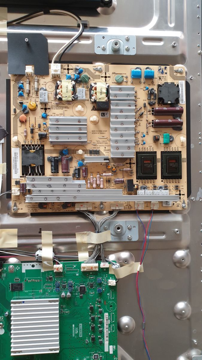

    Gentlemen with no unnecessary claims. It's not nice to read some nonsense.
    And now about a similar patient. Namely, the power supply (FLYBACK converter) was dying after heating up. The culprit turned out to be a transoptor in the AC-DET branch, which after the heating cut off the signal.
    test oscilloscope and freezer torment because every reset lasted for a dozen or so seconds, but as the hot air went faster, I found the area, after which cooling the plate and touching the soldering elements revealed the perpetrator
    You can see K1010 transoptors some thin on thermal stability. The first one was just PC123 and it fit.
    PS Let's exchange knowledge, not quarrels.

    Kley wrote:
    matrix's backlight is 200-300V so as you can see in the picture, the optocoupler sits on the line separating the low voltage from the high one.
    You may refer to this because I do not want to.
    The triplets of optocoupler parameters can not be found on the internet. ;)
    Do you think that it is really worth to exchange knowledge with such? ;) This is not a replacement. :)

    For 2 weeks I have problems with image flicker in this television model (about 7 years old). Symptoms occur at different times, from 2 - 8 hours.
    But there was a period that everything was fine for a day and a half. It is a small flickering - you need to look at the moving image, you can see it at once. Sometimes it helps to turn off the TV for a few minutes and it works without a problem all day. three days ago after excluding TV is the backlight for a few seconds. Yesterday, after switching off screen 7 times every 0.5 seconds.
    I read that they could be: fluorescent lamps, capacitors, problems with contacts or non-temperature-resistant components, power supply
    I will be grateful for advice - I am going to a professional after the New Year - we will see what he will say and let it be profitable to repair.
    I have a question, what may be the cause of this fault, is there already something more on the forum?

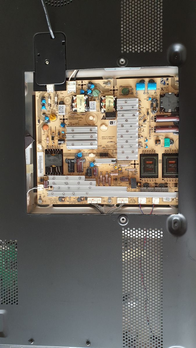

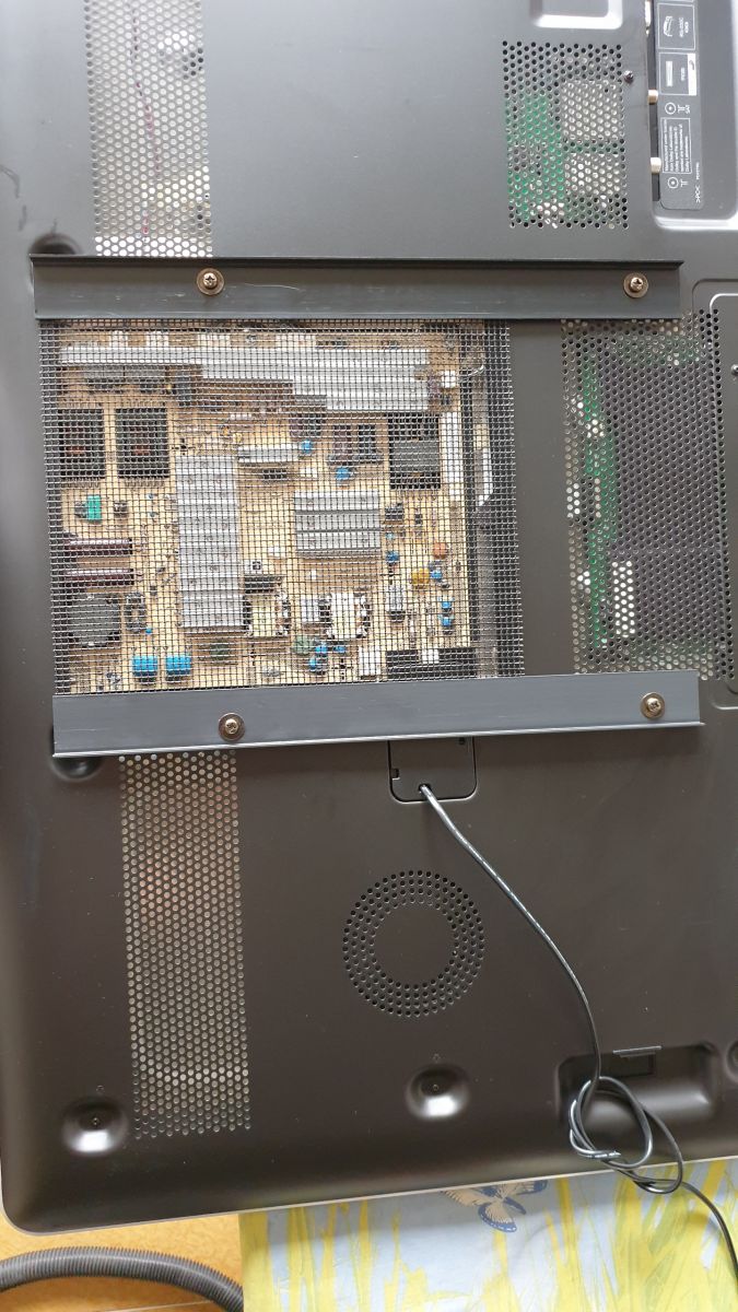

  • #44 18893508
    graceful
    I have had the same issue. It is unbelievable how semiconductors are poorly cooled.
    I decided to improve that but I did want to use any noisy coolers, so added couple of U profile to original cooling plates and also optocoupler, is not necessary to change it if is also cooled.
    Then I made hole to rear cover and put plastic grid.
    The cooling is much better now, see attache pictures.
    Of course somebody can say that this is not ideal from elcetric shock protection but for me is important reliability....
    I would like to thanks Kley that figured out what is the root cause of the flickering issue !!!
