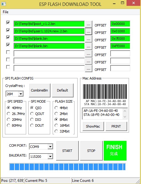

    (esp_iot_sdk_v1.1.1_15_06_05) README.TXT:
    download:
    boot_v1.2+.bin 0x00000
    user1.1024.new.2.bin 0x01000
    blank.bin 0x7e000 & 0xfe000
    *NOTICE*: If you use Esp Flash Download Tool, please MAKE SURE to choose FLASH SIZE to 8Mbit.
    Implementation:

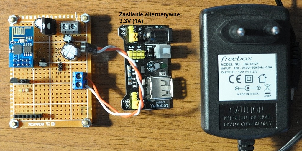

    On the universal board it looks like this:
    ESP8266-01 - Reset every 30 seconds after AT+CWJAP=SSID,password command
    3. I was also hoping that these times were changing with the battery and the thing was clarifying, but in further experimentation everything was back to normal to those 30 seconds or so and on the two boards.
    4. My 3.3V power supply on the board with the ESP 8266 is 0.5A (may not be enough) and the contact board is AMS 1117 3.3 (1A).
    5. New approaches:
    (a) I gave power to the ESP on the universal board from the power module (photo : alternative power supply) 3.3V - WDT reset time every 30 seconds
    b) I gave power to the ESP on the universal board from 2 AA batteries (3.19V) - WDT reset time every 30 seconds or so
    6. It's a pity that I don't have a test (laboratory ) power supply so that I could find out if this is the power supply - you can see from this that I need to buy one in the future. But from these experiments it seems that probably not asilization?
    7. I still have an ESP8266 -03 module, but it's without goldpins and with a raster of 2mm, I'm afraid to solder such small ones - and I have a hm... transformer soldering iron, and when I have an IC I usually mount it on a socket, so as not to damage it.

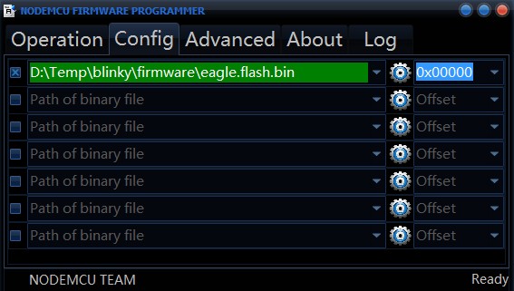

    AMS 1117 3.3 (1A) - temp 37-38 degrees (slightly warm)
    AT-firmware - various and also internal with nodemcu-flasher-master
    but also with Arduino ide examples with Webserver. on 192.168.1.103 I have:ESP8266 24 T=23.87 Time:20s
    With the Nodecom mcu firmware it is OK until I give the command AT+CWJAP="@HomeCA72",""
