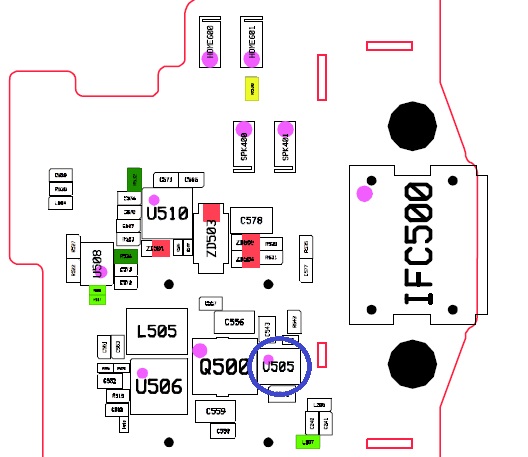

    I have a question, what is this element marked in the drawing as U505?

    As you have already obtained this drawing from the service, then look on, there is a description.

    This is some other arrangement. The one I'm looking for has nine pins under me

    Then take a picture of the PCB, and do not paste the image from the service.

    I marked the element with the yellow circle.
    It's not in my damaged tablet.

    It's good that you can see something in this picture :P

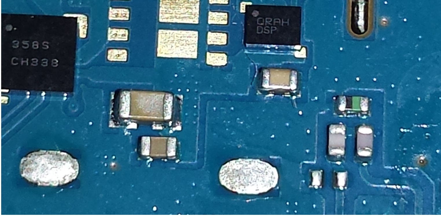

    I throw a photo of the searched system.
    Subject to be closed.

    This is FPF2411BUCX_F130. Below the datasheet.

    Please remember that this model has two IC-BATTERY ICs (U505, U506).
