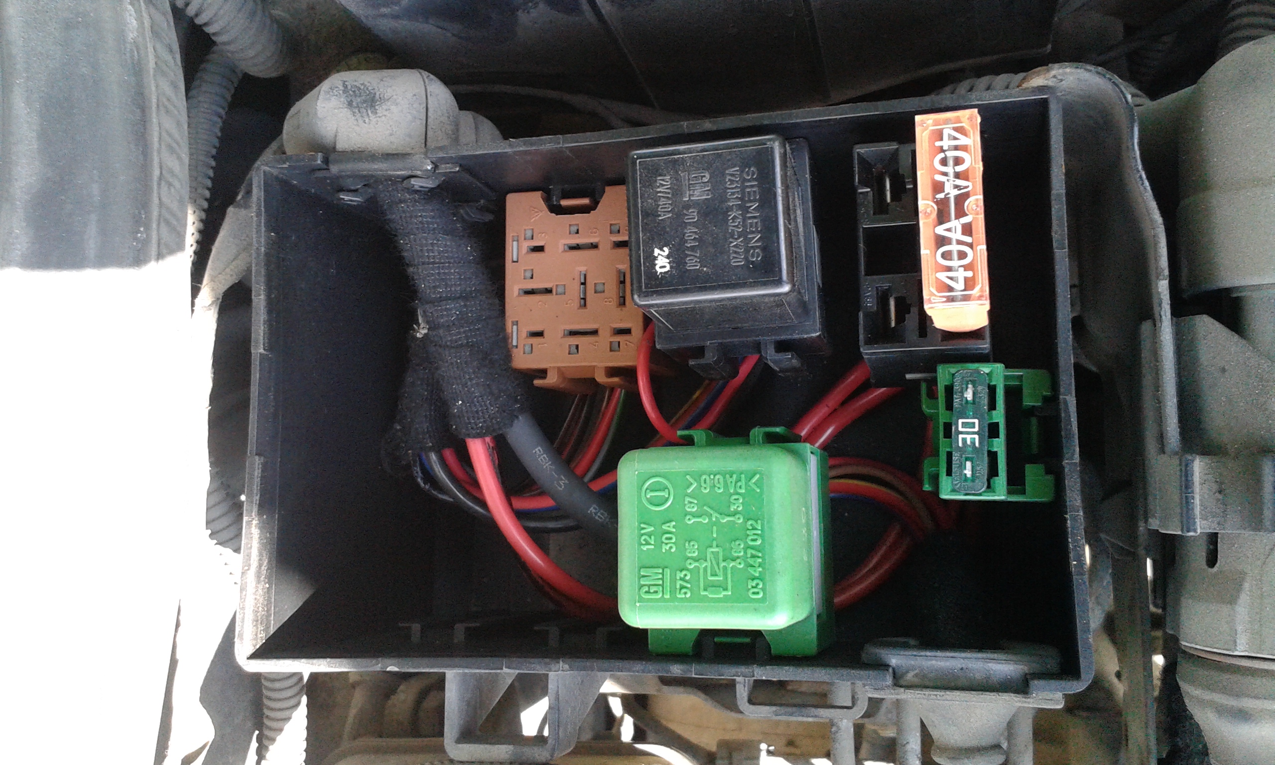

    Give a picture of the relay box under the hood.

    I mean, one fan works all the time and the other one turns off normally.

    Then pull out the controller and check the relay contacts.

    What controller, since, has one fan and a relay, as you can see, controlled from the engine's ecu.

    After all, he wrote that he has two fans and one runs all the time, so how do you want to have two fans connected separately to two relays where they control two gears?
    I haven't seen two fans without a driver yet.
    Although you are right that the relays are in the place where the relays should be from controlling the fans by the ECU.

    KOlego do you have a fan module in the wheel arch, did you look at it?

    The module is in the bumper on the driver's side. And the lamp is sometimes holy, sometimes not

    Pull out the module and check the relay contacts.

    Thanks to everyone for your advice and suggestions :) it turned out to be a faulty module. I replaced it and everything is fine and whirring :D
