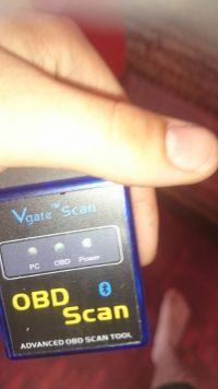

    I do not have how to check the error code now, someone knows a good program for this device to show me an error ??? Opel Astra g 2 1.7 Isuzu 2003: Persistent Cooling System Light Despite Fan Module Change

  • #12 16531704
    bubu1769
    Posts: 8063
    Help: 1177
    Rate: 2374
    There is no good program under this ELM, you can check the free version of Torque for android, maybe it will show you something.

  • #14 16533102
    conrad9210
    Level 26  
    Posts: 909
    Help: 83
    Rate: 210
    Hi. Under this, Elma works fine on the android SCANmyOpel. I used to diagnose Astre 2 with X16XEL with it.
