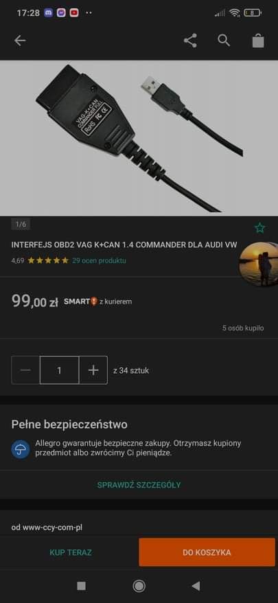

    I have a vag com problem. Drivers from the viaken vag kkl usb website installed for the cable. The cable is k can vag commander 1.4 ports are also set to com2. In the vag com settings, it searches for the port and interface, but if it wants to enter, for example, the engine or immobilizer, it tries to connect and after a while the error "No Response from Controller" pops up. What could it be? VID_0403 PID_6001

    k+can vag commander 1.4 and VAG-COM are two different cables, although some functions will work interchangeably. Nowadays, the usefulness of the ISO KKL cable (commonly known as VAG-COM) is negligible, because it does not support CAN, which most cars have, hence there is nothing to answer on the K line, because it does not exist.
    You have the cable on the FTDI chip.
  • #36 20322398
    tzok
    Posts: 38884
    Help: 3175
    Rate: 6546
    The cable should work with the program for which it is dedicated, i.e. VAG K+CAN Commander 1.4.
