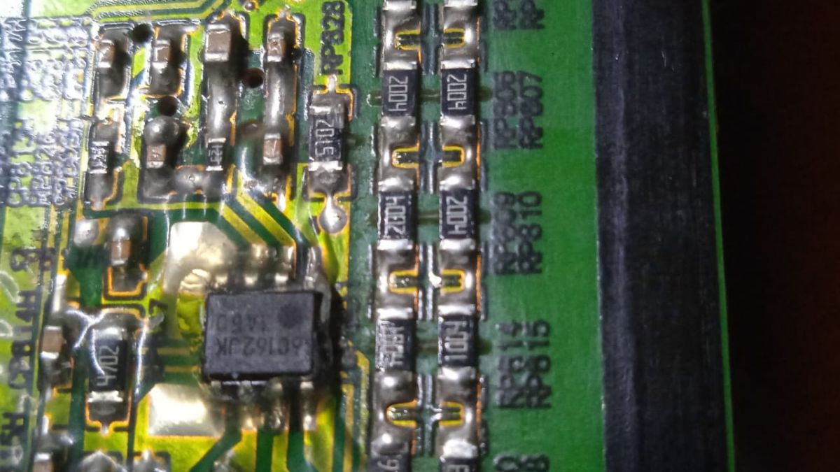

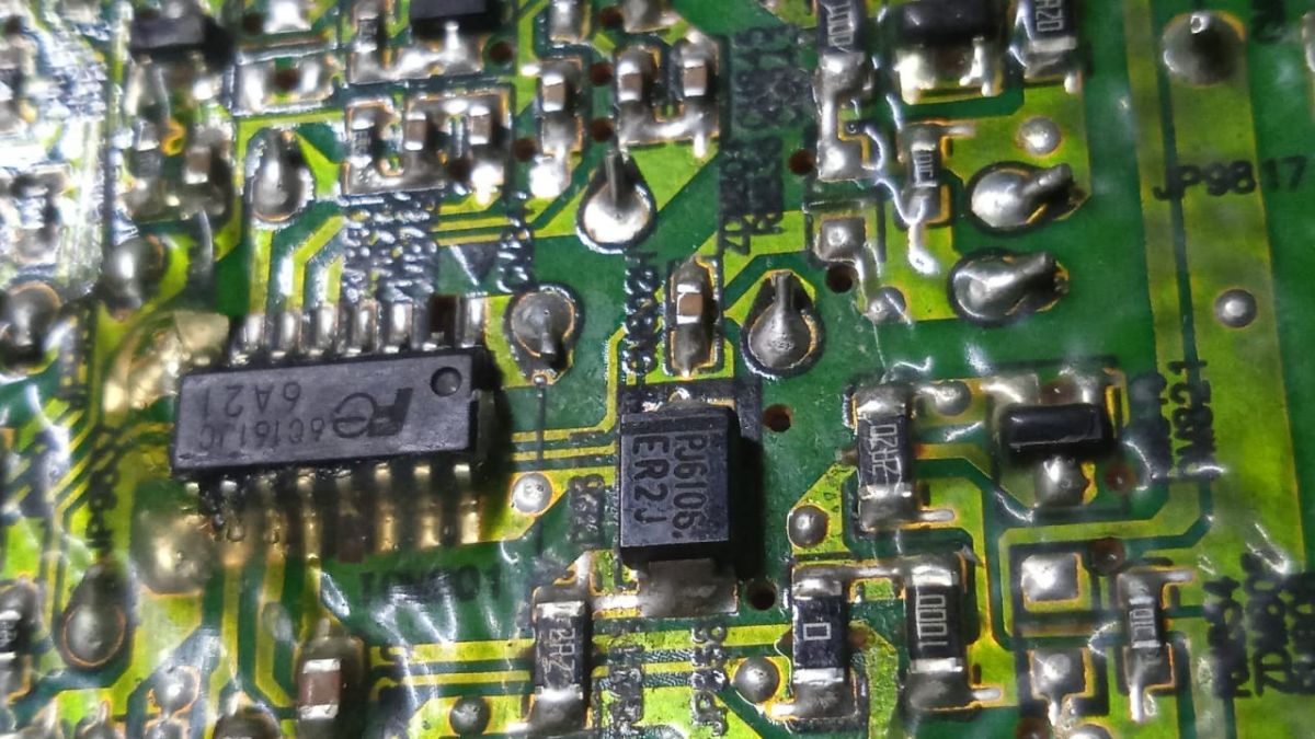

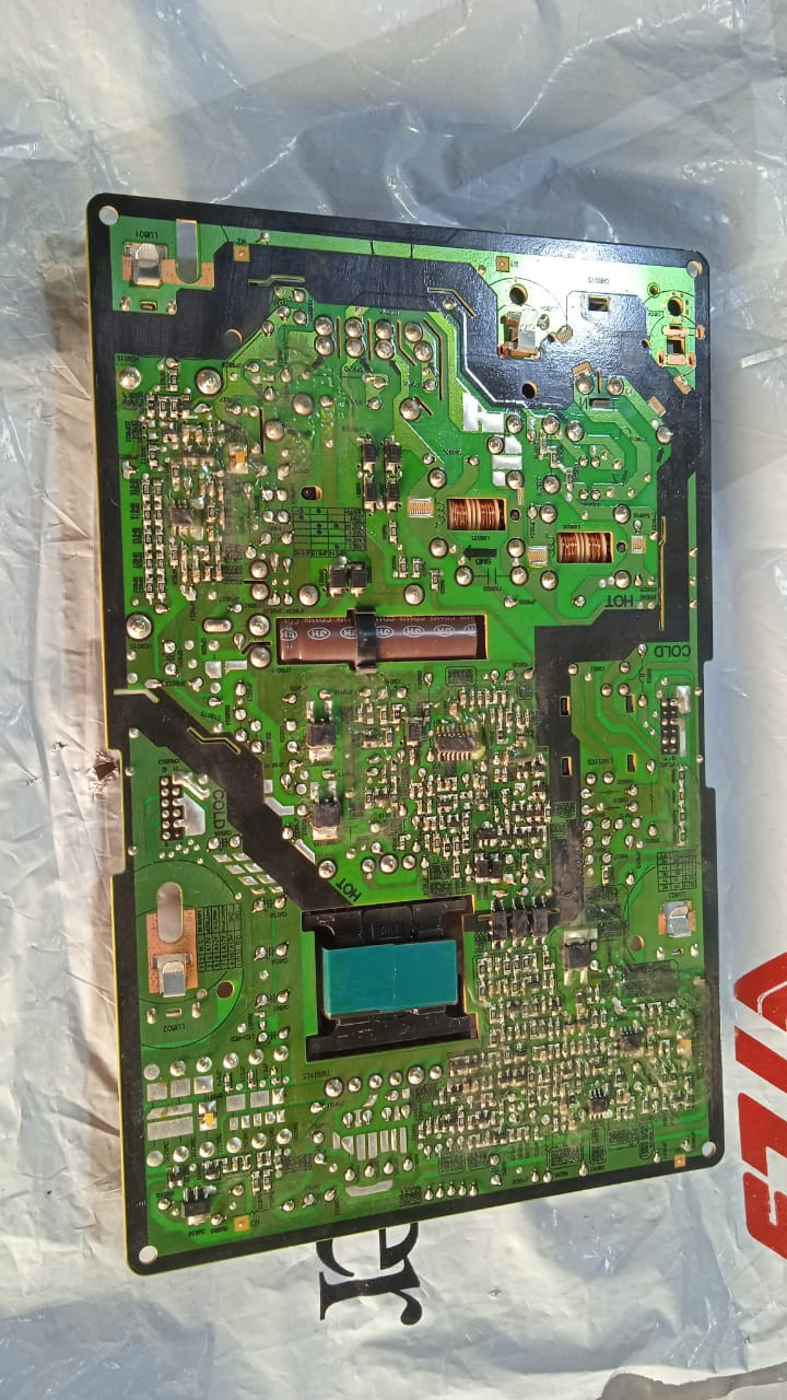

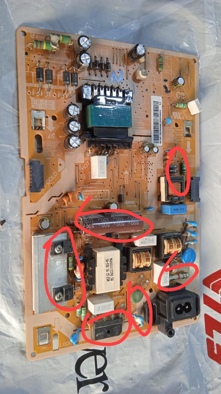

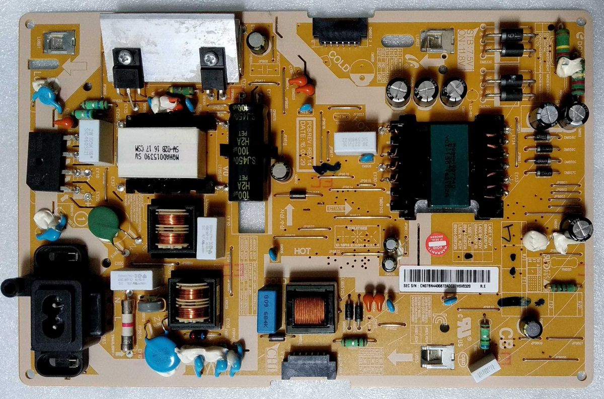

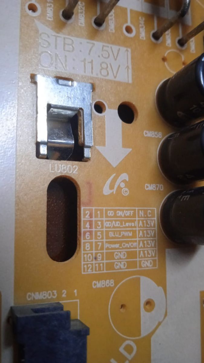

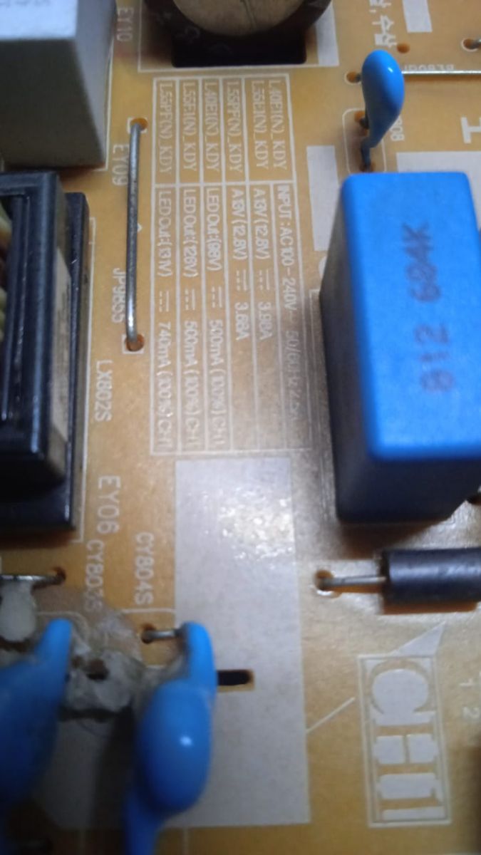

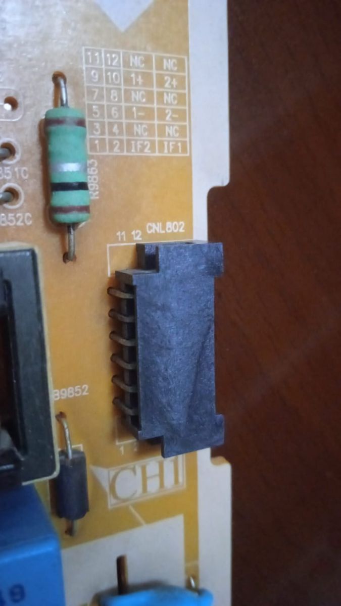

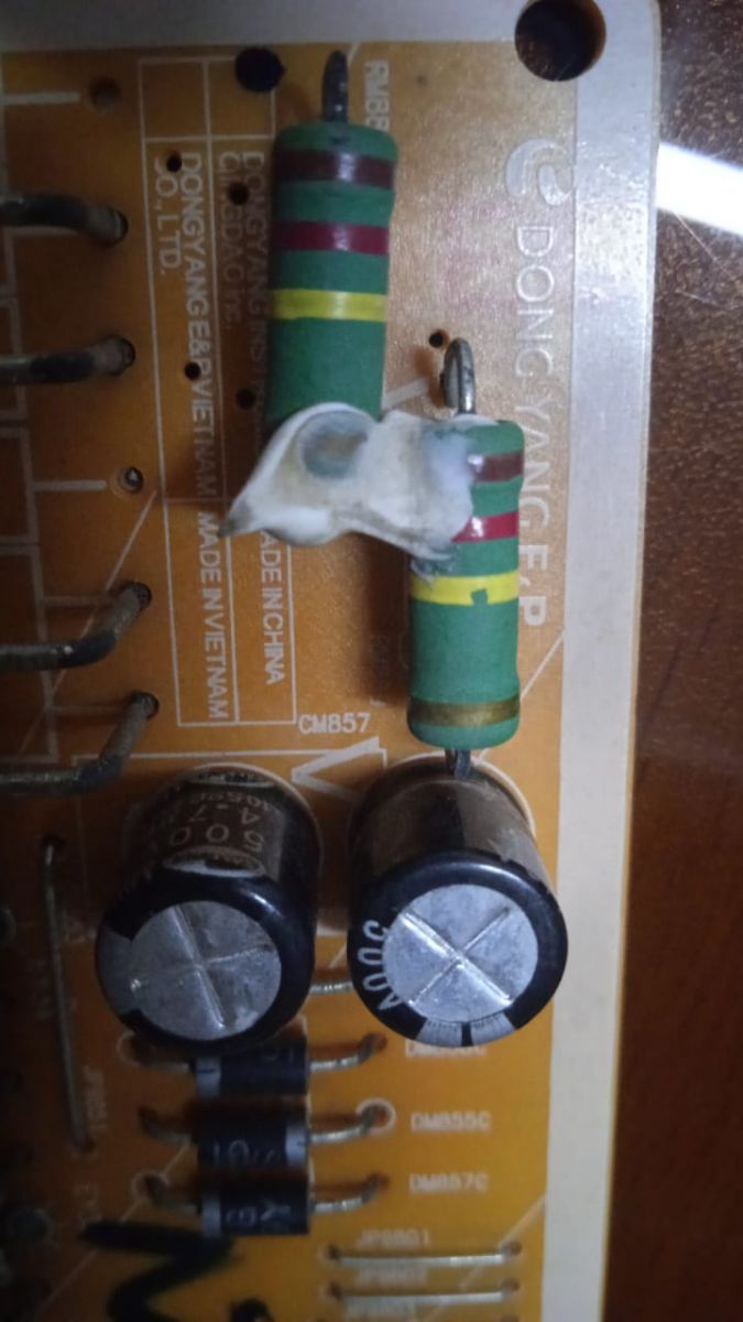

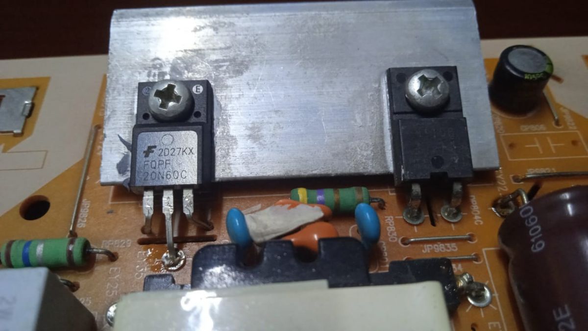

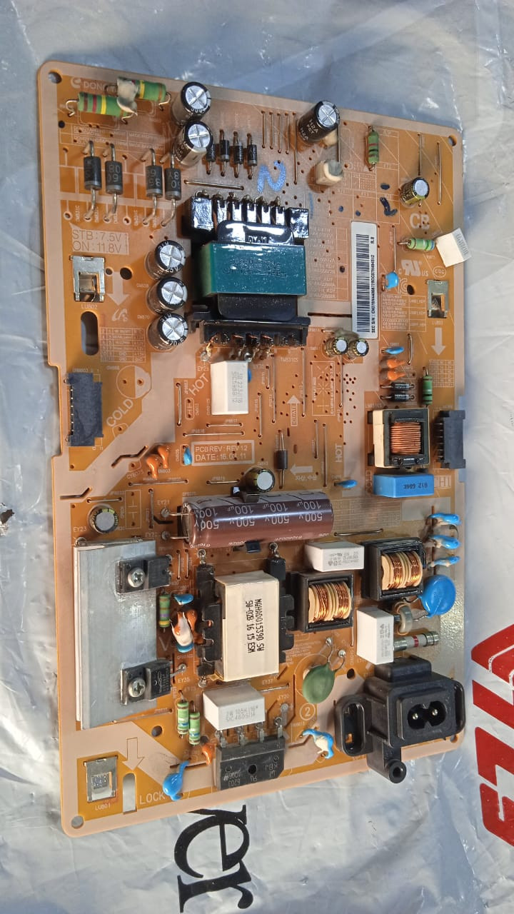

    I am looking for some help regarding the SAMSUNG SMART LED TV Model No. UA49K6000AR Schematic of the Power Supply Board, since the Power Board is DEAD with Blown FUSE & FET.
    Now, I need to have the reference schematic to find the cause of the related defective SMD parts also, as the Power Board Design seems to be working with PFC boost configuration, I guess.
    Please help find the link of the Schematic or Service Manual for this LED SMART TV.
    Pictures of the Power Supply Board and Back LABEL are attached for reference.
    Your prompt response will be APPRECIATED.
    Thanks & Regards
    Could you please specify your location or region, as this might help in finding region-specific resources for the schematic or service manual?
    Karachi, Pakistan
    Have you already attempted any troubleshooting steps or repairs on the power supply board, aside from identifying the blown fuse and FET?
    Yes, tried to replace the blown Fuse & FET (as per the datasheet of the original FET) and tested, still getting the POWER BOARD is making SHORT Circuit and the Fuse Blow again. Need help with schematic. Thanks

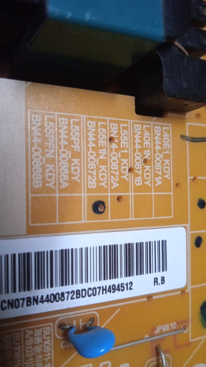

    It "s power, supply (PSU) BN44-00807A
    - for UA55MU6310, UA55KU6000, UA49KU6300K,
    Power Supply (PSU): BN44-00807A L55S6_FHS
    * PWM LED driver: SLC3011N
    * PWM Power: SPC7011F, FA6A20
    This forum about this PSU wrote
    Phrase: BN44-00807A Search on selected forums Found 48 results
    * Link .

    Hi Lisek,
    yes, the Actual Model No of the Power Supply Board is BN44-00872B, as printed & checked on the Board itself.
    Could you plz share the link to download the schematic of this board. Thanks

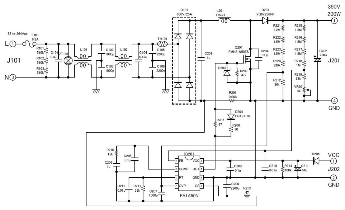

    Power Supply (PSU): BN44-00872D L55E1K_KSM
    PWM LED driver: SEM4082A
    main IC FA6A21N no datasheet
    - set for low Iled (from 480 mA > 270 mA) Link
    sorry No SM, only ...
    Circuit diagram of a power supply with FA1A50N marking. .
    p.s
    is BN44-00807A, with FA6A20
    - from FA6A00N series (FA6A00N, FA6A01N, FA6A10N, FA6A11N).
    Link ICM912
    PSU BN44-00852F - L48MSFR_MDY
    FA6A21N
    FA1A50N
    SLC7015x > ( SLC7015R , SLC7015R02 , SLC7015R02-E2 )
    - info. Link .
    attach. BN44-00704E
    FA6A21N corresponds to FA6A31N, there are small differences, there are nuances
    FA6A21N, = ? FA6A20N
    • FA1A50N FA1A60N FA1A61N FA1A21N FA6B20N FA6B21N FA6A10N FA6A11N FA6A30N FA6A31N.pdf (1 MB) You must be logged in to download this attachment.
    • FA6A00N.pdf (310.34 KB) You must be logged in to download this attachment.
    • FA6A30_31.pdf (1006.87 KB) You must be logged in to download this attachment.
    • SamsungBN44-007.pdf (268.55 KB) You must be logged in to download this attachment.

    Thanks for the help & support.
    Lisek replies and find the defective parts in SMD SOT223 pack NPN BJT and related SMD 0805 Resistors & SOD123 / SOT23 pack Zenere Diodes & resolved the issue.
    Thanks to All.
