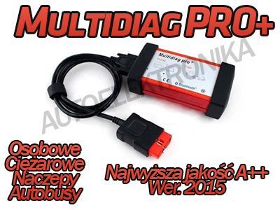

    Hello, I would like to ask if multidiag pro + 2015 is a good diagnostic and programming device? I mean a deeper interference, but it will only be used for personal use!

  • #2 14936797
    leonov
    Posts: 8917
    Help: 1039
    Rate: 2247
    henryk214 wrote:
    for diagnostics
    Of course.
    henryk214 wrote:
    and programming
    Not very.
    Not very much, but it depends what you mean by that.
    This is equipment with capabilities such as Autocom and Delphi "clones"

    #8 14937153
    grala1
    VAG group specialist
    Posts: 9823
    Help: 1495
    Rate: 5052
    What you showed was AUTOCOM in a different housing.
    You can see that your knowledge is zero in the subject.
    You can not write any programs on it or change them, you will not turn off DPF or EGR.
    Such equipment is used to read errors, control engine components (what the car manufacturer allowed), read parameters seen by sensors in the car, sometimes change the coding or, for example, adapt the throttle, EGR or, for example, the ESP overload sensor.
    This equipment does not cope well with Asian cars, it covers European cars quite correctly.
    ELMa let it go - it's a waste of money.
    Remember that how much you would spend on the equipment, the most important thing is your knowledge, because you have to interpret the measurements and make a diagnosis.
    Unless you are going to replace this c the computer will show in errors.
