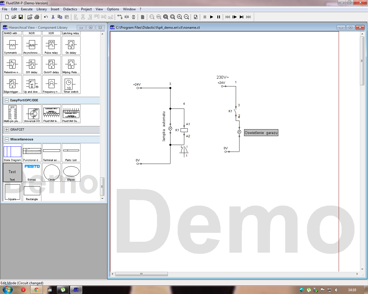

    I've come up with something like this, so that as the garage door opens (or closes) from the remote control, a lamp in the garage will also light up.
    And now a question to experts on the subject, how can this be done most simply?
    I would like to add that the gate operator itself has a small lamp, which is supplied with 12V during operation, and after 2 minutes it goes out - and such lighting would suit me (I enter the illuminated garage, get out and either light the rest of the lamps, or continue walking, and the lamp goes out by itself after some time - just like in the gate drive).
    Please provide me with a link to an existing thread (if possible, move it), or a ready-made solution that is as cheap and simple as possible.

    Normally you go into an electronic shop and ask for a relay with a 12 V coil and 230 V contacts, connect the coil in parallel to the lamp, and put the phase on the normally open contact, from the output of the contact to the lamp and to GND, and you're done.

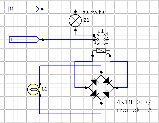

    1. i understand that Z1 is a 230V bulb ?
    2. for what purpose is this bridge ? is it necessary ?
  • #13 15477462

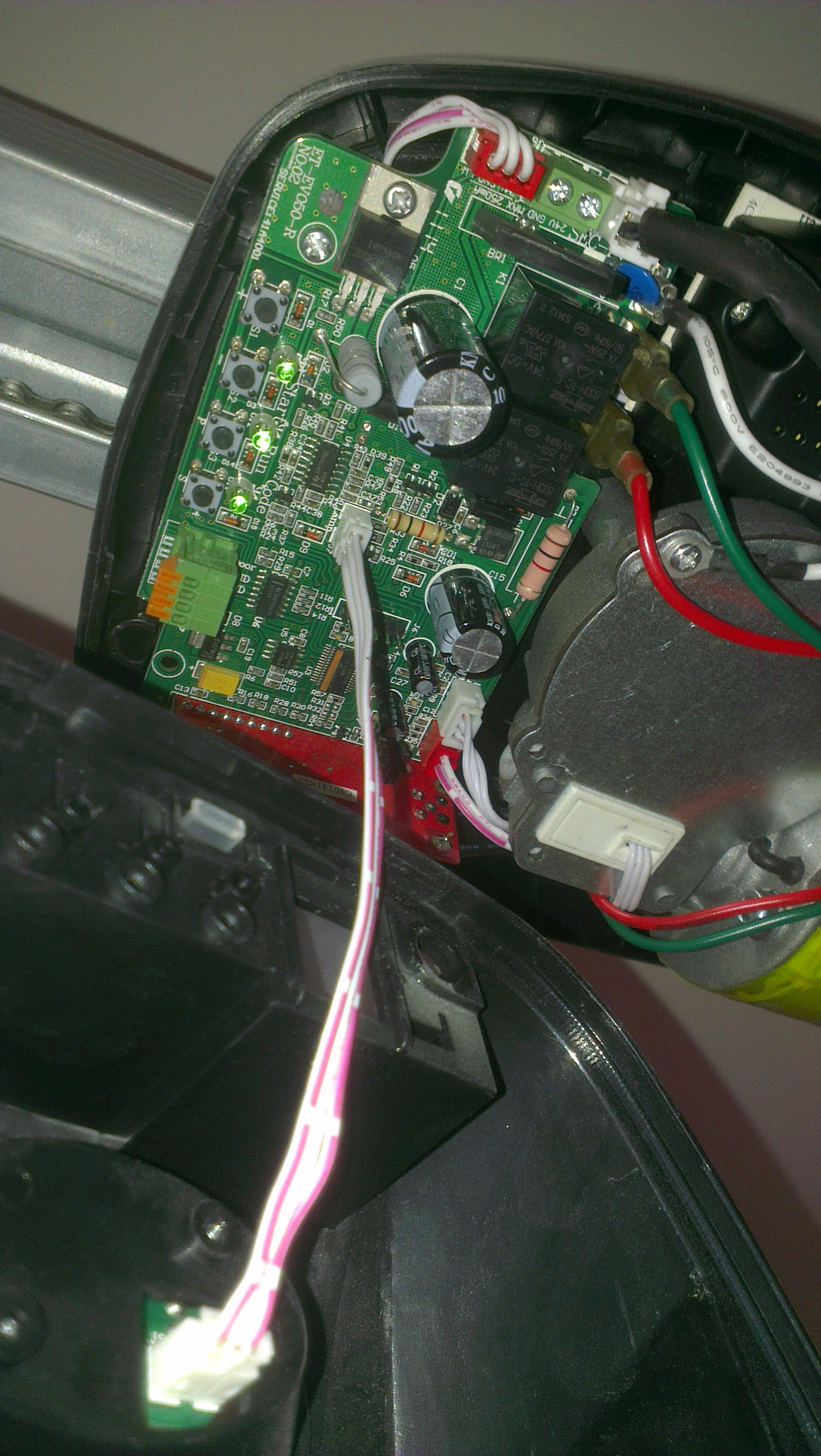

    Hi. In the photo of the control panel you can see two miniature relays whose coils are powered by 24 volts DC. So if the same voltage is supplied to the control, then you have a good relay and the bridge is unnecessary. If it is variable on the control, the relay will buzz. You can still bridge pins 1-2, 3-4, 5-6 to increase the load capacity of the relay. Greetings.

    Re.1 Yes
    Ad.2 The bulb (L1) is most likely supplied by the relay contacts with AC voltage straight from the transformer and as you have a DC relay with marked polarity a bridge is needed....
