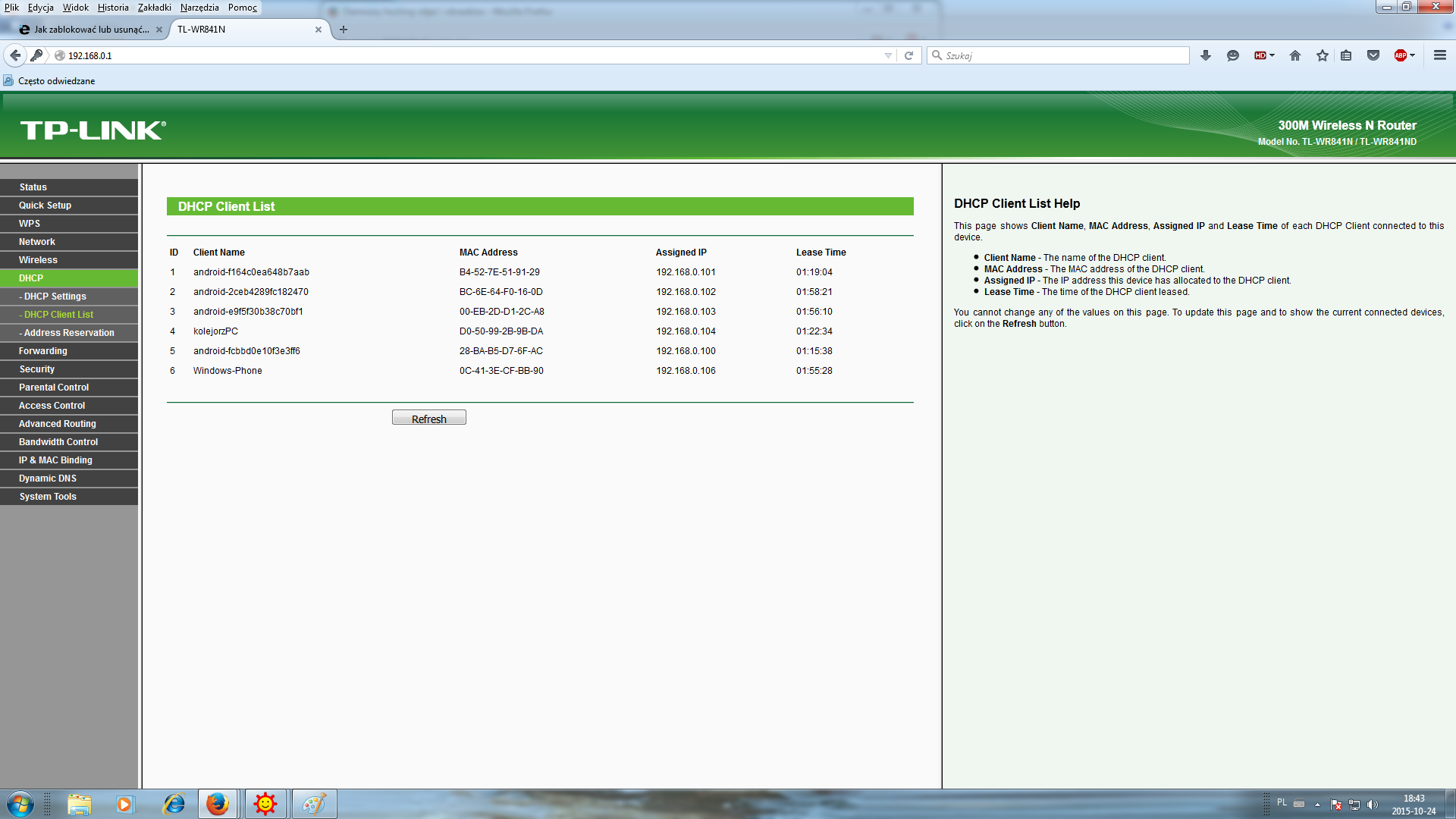

    How to Block/Remove Specific Wi-Fi Devices from Connected Network without Changing Router Password
    This is a list of devices connected to my WI-FI network, how can I remove some of them? I do not want to change the password to the router, so I am not interested in this type of help
    and where should I look next?
    • How to Block/Remove Specific Wi-Fi Devices from Connected Network without Changing Router Password rou.png (299.96 KB) You must be logged in to download this attachment.

    See, if you started with the router model, you'd get a more specific answer sooner ...
    Wireless - Wireless MAC filtering - you set the list to "Deny" and turn it on ("Enable" button), add MAC to the list. The status of the added MAC should also be "Enabled".
