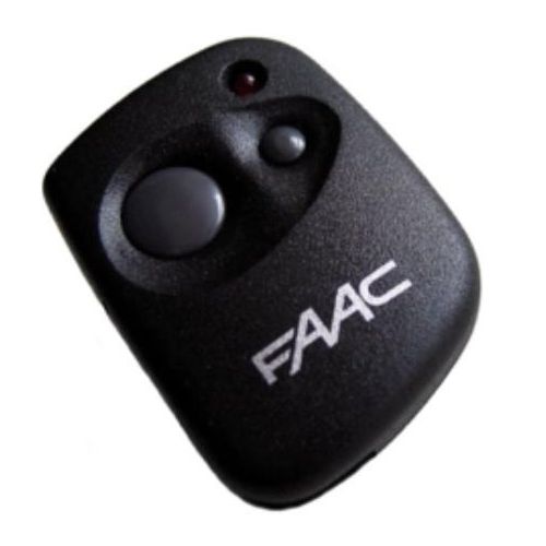

    The remote control I've been using so far is visually identical to the Faac FIX 2 remote control, can I now buy another one of the same type?...Do you know how to go about adding another remote control?

    The remote looks identical to the attached photo , only there is no writing on the front (i.e. that faac), I still have to check today , maybe there is something written on the underside.

    • Controller identification/adjustment/programming of another remote control pilot-faac-fix-2-kanalowy.jpg (17.68 KB) You must be logged in to download this attachment.

    Buy the remote controls as they were - if they were without the Faac inscription, buy one, you can always return it.
    On the radio you have - the board soldered vertically - two pins on the corner of the board. Then the radio is clean of remote controls and is in loading mode, waiting for the first remote to be loaded. You press and there you go , each remote in turn.
