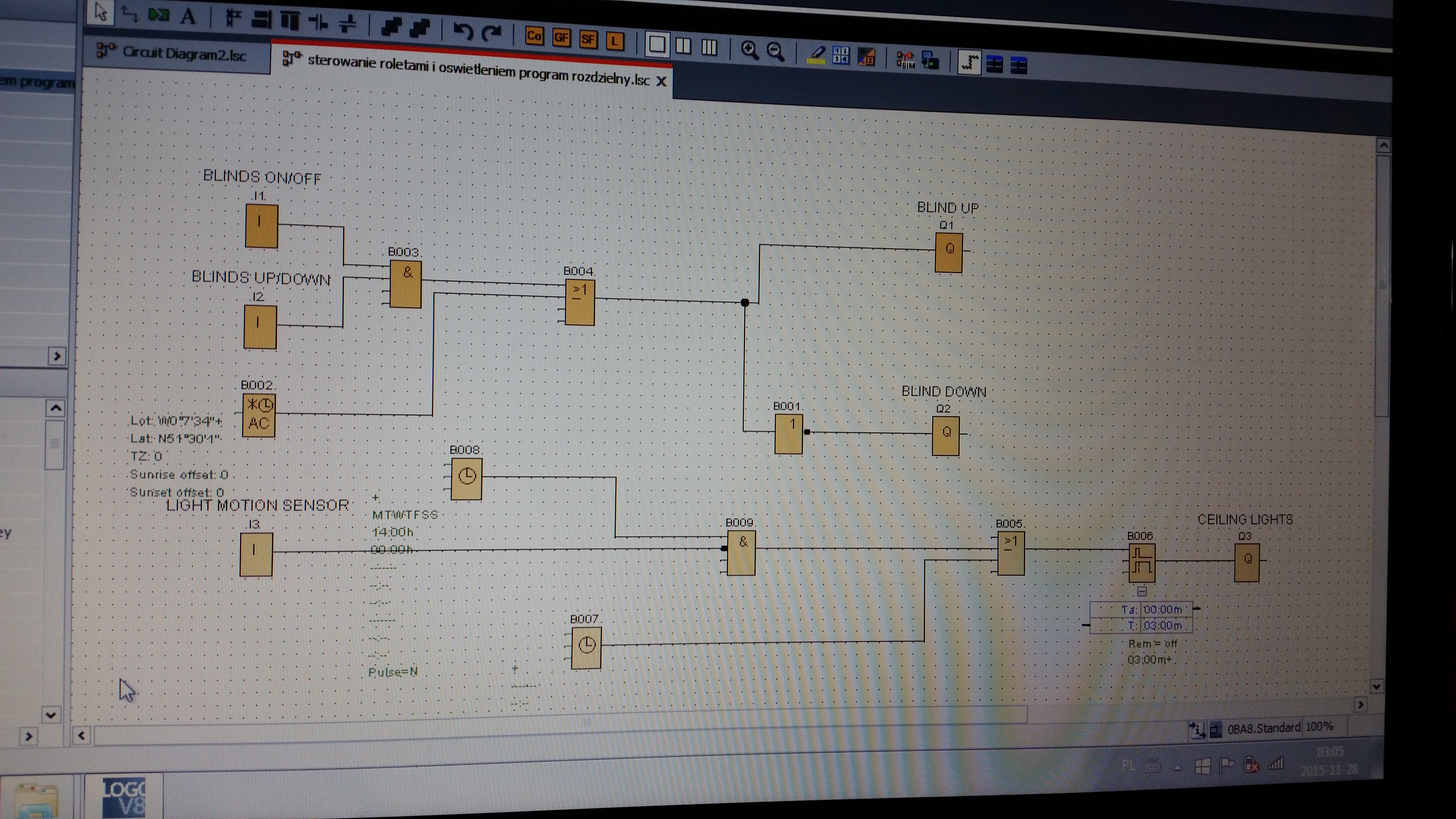

    I have a question about the PLC as in the title.
    Everything works OK with the exception of being able to manage the online interface, i.e. after creating a custom program for myself to manage my window blinds and room lighting, by entering the local IP address of the controller, I can access its logo page and find out the general status of the device, i.e. what mode it is in, software version, etc etc etc, but when I enter the second tab (Logo variable, or BM logo) the image of the controller appears but the display is blank and nothing can be changed with the cursor from my laptop by pressing the keys of its simulation. I have tried with several browsers and the same thing. Is it the fault of the operating system (I have Windows 7, 64bit) and supposedly this Logo is supposed to work with it, or is it the fault of the connection?
    I want to try to get into the driver settings to enter the port number where it is supposed to run over the internet so I can manage it online via a remote ddns or WAN address, thanks for your help

    The programme is simple, consisting of basic blocks and the simplest special blocks, i.e. I-gates, OR, a delay for switching off the lights, a weekly timer and an astronomical clock for setting the lowering and raising of the roller blinds, nothing to brag about.
    With regard to the 'messages'-in my case 'message texts'-I do not have this block in the programme. And you can't set anything in it until you add it. But adding it before one of the Q's and entering parameters into it (e.g. clock time, time of the off-delay block, etc.) and where the information is to be displayed (web server) changes nothing, the only thing that changes is that everything disappears from the display in the LOGO and I think to myself, oh great, so now this and that will be shown in the virtual logo, and here it is empty again hehe.

    From what you write everything is behaving ok (symptoms) :)
    The problem is in your created program, and it is not a matter of bragging but of checking if there is a correctly created program.
    And from the description it seems that it is not.
    Send the program to the forum or to me on PW, I will see what you have copied and correct it. Then you will see if everything works ok for you and what changes I made.
    Describing it on the forum is pointless because it would be a bit of writing. :)

    Ok, I am attaching the programme. Sorry for the picture, but when I tried with the logo for the attachment, the website didn't accept this file extension
    Thanks to
    • Logo! Siemens 0BA8 24RCE web interface shows blank controller display—browser or config issue? program_zs.jpg (7.24 MB) You must be logged in to download this attachment.

    - Pack the program file with rar or zip and then give it to the forum.
    - "Message texts" you do not link to the Q output but give a high state block and then link to the message texts. Then in the Message texts properties you select (as I wrote earlier) the web server and determine what should be displayed.
    - When it comes to changing IP, WAN, DNS etc. via a web browser, I assure you that you won't do it. There is the ability to view, display, and control e.g. on, off, more, less etc.
