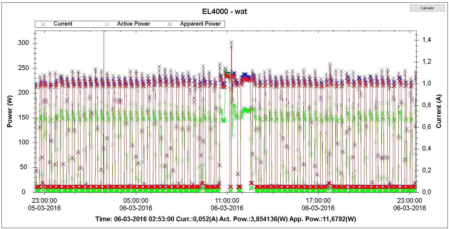

    This is what the daily power consumption of an LG refrigerator looks like:
    Old refrigerator - High bills, old refrigerator and house, buying a wattmeter And more detailed:
    Old refrigerator - High bills, old refrigerator and house, buying a wattmeter .
