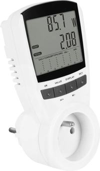

    Greetings.
    We have a very high consumption of electricity, after a time of heavy sighing over the bill I took it upon myself to determine what is to blame.
    I have a few theories:
    1. Meter broken
    2. One tariff
    3. Old installation, old house, done very amateurishly
    4. Old refrigerator
    5. Someone plugged in, connection error
    I would like to figure out with your help what is the cause.
    The first thing I wanted to rule out is an old refrigerator. The refrigerator is 40 years old, very graceful, but it is on my target.
    According to your experience, how can such a thing be a current-consuming thing?
    I wanted to buy a wattmeter to determine this. The first better one on allegro is called dual tariff and I would like to know if I can measure on one tariff with such a thing? Does it have the option to program one tariff?

    To begin with, disconnect all devices, literally all of them, and check if the meter is spinning (the main one).
    Then look for the culprits, if there are any.

    Hmm it's an electronic meter how do I check if it flies? :) Something flashes?
    The problem is with this refrigerator, its not possible to unplug it because it will defrost, so I wanted to treat it with a wattmeter, since I'm already going to have this trouble. Maybe unplugging for a while to plug in this appliance should not cause me defrosting, but the risk is there.
    I'll provide a table of what we have at home, maybe tomorrow I'll be able to, to show more where we stand.
    We have a consumption of about 800kW for 5 people. Flow heater 5.5kW.

    In that case, I add the digits (code 1.8.0 - you can see the total energy consumption).
    I don't know if it wouldn't be simpler to invite a metering electrician with equipment to the house....

    From curiosities today I "measured" the consumption in this heater. Mom went to take a bath and the meter for 7 minutes of her bathing went from 25039.4 to 25039.8, then for 7 minutes without the heater it went to 25039.9, so it comes out so slightly messed up counting it per person came out 0.3 without the heater....

    I give the results so far of playing with the wattmeter (I am in love with this device):
    grandma's TV including antenna - 40-50W
    our TV - 40W
    laptop 1 and 2 - about 30-35W (per head)
    microwave - 1050W
    bathroom stove - 1840W
    hair dryer - from 200W to 800W
    old oven - 2200W (he is not used at all, 1995 vintage out of curiosity I turned on)
    and queen - prehistoric refrigerator :) - 100-120W
    baby refrigerator this new, it didn't even start the meter, only when I opened it then 14W, I suspect she "freezes" every so often...
    sometimes in the outlet I have 217V ....

    Refrigerators had to be measured how much they consume in 24 hours because they cycle on.
    I have an old Polar that consumes 1kWh/day.

    In the case of refrigerators, we do not measure its instantaneous power (what it draws at a given time), because it does not make sense.
    My recently purchased Samsung sometimes draws 0W, other times 15W, sometimes 40W, but once I caught it drawing 160W.
    By the way, taking advantage of the fact that some colleagues are confused by the units, I would like to remind you that power (that is, the rate at which energy is drawn) is measured in watts (W) or kilowatts (kW).
    The energy consumed is measured in kilowatt-hours (kWh). My refrigerator on a daily cycle consumes less than 0.6 kWh. In a monthly cycle it will be less than 20kWh.
    Large energy consumption of old refrigerators can have a trivial cause, such as damage to the door seal, through which warm air gets inside.
