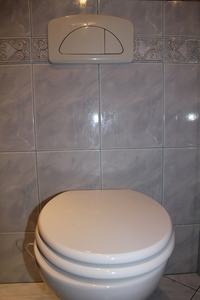

    Does anyone know the model / type of a concealed / wall cistern shown in the photo and knows how to remove the button to get inside. I do not know how to dismantle it and therefore I cannot remove the cause of the water dripping.
    I am asking for your suggestions. My water is leaking every time and I have to do some miracles to make it stop, but it only works once :cry: Maybe someone has already repaired it, or he does it professionally (plumbers connect :) and can tell you how to deal with it. I don't want to tear anything off.
    I would be grateful for the tips :D

    What model is it? Please send some photos.

    I paste the photo of the button.

    In general, you slightly lift the button up and take it off.

    For me it is right and up and I have to put in a little force.

    But should I move all (all plastic) upwards or only the part that I push to start the flush? :?:

    I have a little different, but not the buttons, all the plastic, this panel is like that for me.

    RocoBlanco wrote:
    If someone has such a button / concealed cistern at home or repairs such cisterns, please let me know what this model is. I have not found an identical model on the network and I still do not know how to remove the button.
    It is not about the flush model, but the flush button.
    Take a picture where the button is placed in relation to the toilet bowl itself. This will allow you to assess whether it is a pneumatic button, a cable or a direct mechanical button directly on the cistern.
    On the other hand, most of these buttons are quite large and they are also a panel covering the access to the cistern in case of failure.
    Most often, the cover is mounted on latches, but sometimes it is screwed with screws covered with buttons only.
    If you have feeling in your hands then you can find the attachment points by gently prying the edges of the cover around, looking at where it stays firmly attached.
    You can also try to gently pry any of the buttons with two flat screwdrivers or the tips of table knives.
    You have to do it gently and with feeling so as not to damage any latches.

    It resembles cheap models available for promotion in supermarket chains. Usually, with these promotional items, a few years ago I encountered the problem of breaking hooks. Professionals dealt with this drawback with the help of glue or silicone. Some people do it on purpose to this day in order to have a job and a move in the interest.
    Another thing, why have you been taking such a long time to dismantle it? The reason for disassembly is usually a failure, and it is rather difficult to live with it for so many months.

    I have the same button and I was able to remove it.
    He hangs on such struts on springs. It has to be moved upwards.
    However, I need to replace it because the hinges / catches are broken, as my colleague said earlier.

    @RocoBlanco, now I'm looking at this disassembled button and I think I wrote it wrong before.
    It turns out that you have to move the whole front panel DOWN (not up) and swing it out of the lower hooks.
    I can't check it because I have the button disassembled myself, and the flush is in another apartment.
    I am enclosing a photo so you can see what it looks like from below.

    Thank you if I don't know what :) I was able to remove the button according to your directions and photos in 10 seconds. For me, nothing is damaged / broken in the button itself, so the problem is probably in the adjustment of the screws responsible for the pressure of the buttons.
    I post pictures of my button. For me, they look a bit different because the pushers are mounted on permanently connected plastic triangular plastics. Maybe this will come in handy for how to fix your button.

    As for disassembly, you actually need to move the panel with buttons down - gently and without pulling it towards you. Rather, even pressing lightly against the tiles / walls. It comes out without any problem. Then, when it comes out of the buttons, slightly tilt in the direction in which it bends.

    It is a SIAMP cistern. Parts for this miracle are owned by the service technicians of the Koło company
