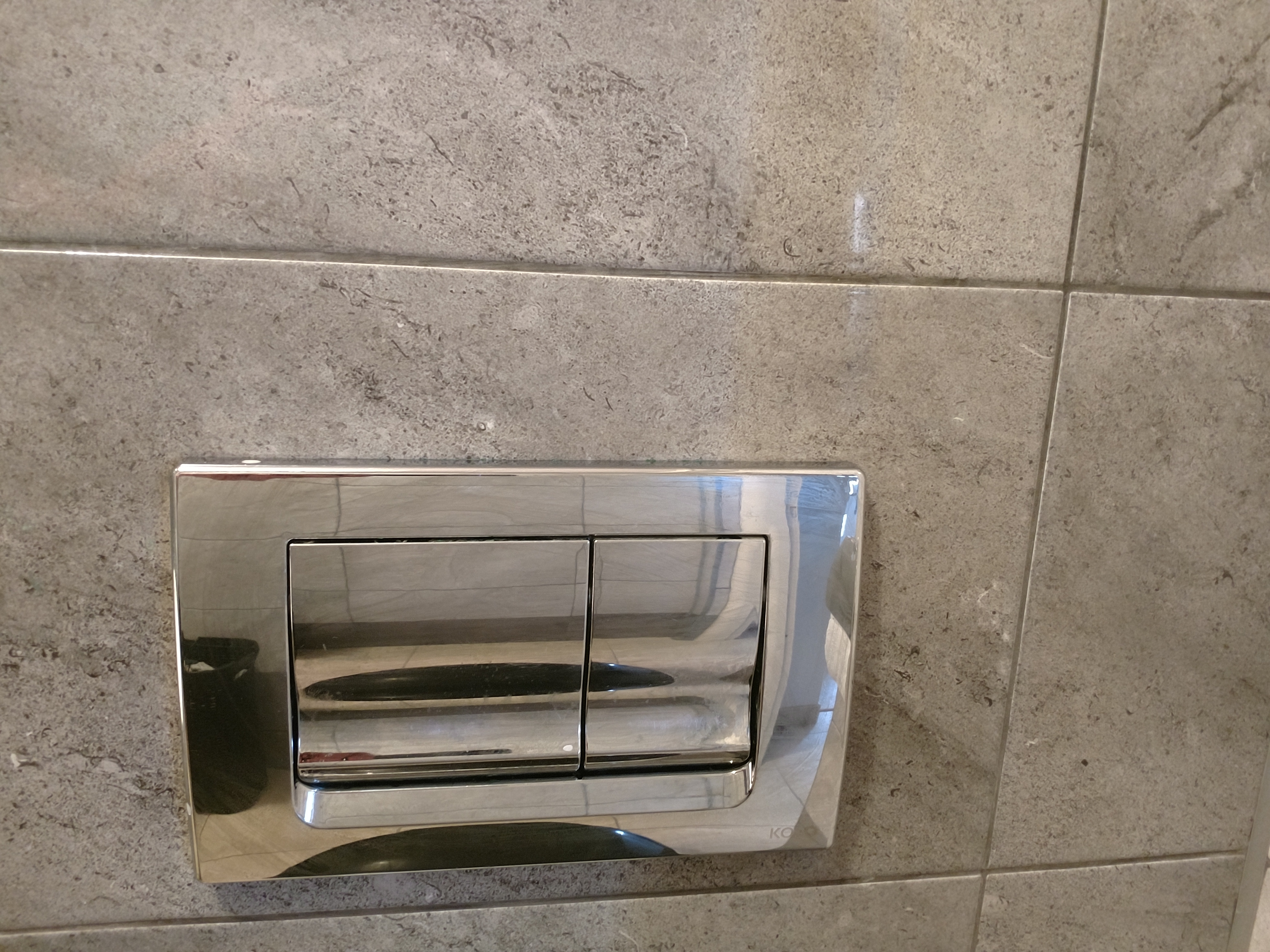

    Hello! I have a conundrum on how to download the button model shown in the photo to check the fault inside. I prefer to be sure, because when I try to do it lightly, the mount is quite opposed to me ;)

    Slide to the left (or right depending on the version) and disconnect from the latches (pull towards you)

    Cool. Thank you so much for help. I kept thinking top and bottom were the only options.

    An old topic but new challenges. There are glass buttons with bellows that are removed by gently levering with a flathead screwdriver on both sides to disengage the two latches located at the keys. Assembly by pushing the pins into the holes to click.
