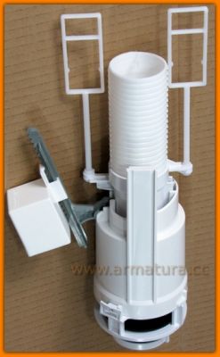

    The flush drain valve in the flush-mounted Cersanit has started to jam, sometimes it does not return to its place after draining the water and the water runs to the bowl all the time. I would like to take it out, clean it - see what the problem is, but how to do it? The access is what it is, I do not want to break it, I do not know if it unscrews, pulls, maybe some hooks? Valve as in the picture.

    Robert B wrote:
    And wouldn't it be easier to look at the manufacturer's manual?
    https://www.cersanit.com.pl/instrukcje-montazu/
    Or at the distributor:
    https://www.lazienkiabc.pl/att/Instrukcja-17482.pdf
    Turn counterclockwise until the latches release.
    Of course, the easiest way: the first link does not contain it, the second one has a different valve, in addition, I have a paper manual from Cersanit for my frame and it tells about the maintenance of this valve, but it does not say how to remove it :) . Thank you for your help, maybe it is enough to twist it harder because I tried earlier and it did not work.

    I just dismantled this valve today, first you need to squeeze the fork that holds it to the frame, then turn the entire valve 180 degrees counterclockwise with the gasket that closes the water supply to the bowl upwards, then there is a place through the hole to clean this gasket or remove it the entire valve through the hole in the frame, before that, of course, unscrew and remove the float valve. Regards
