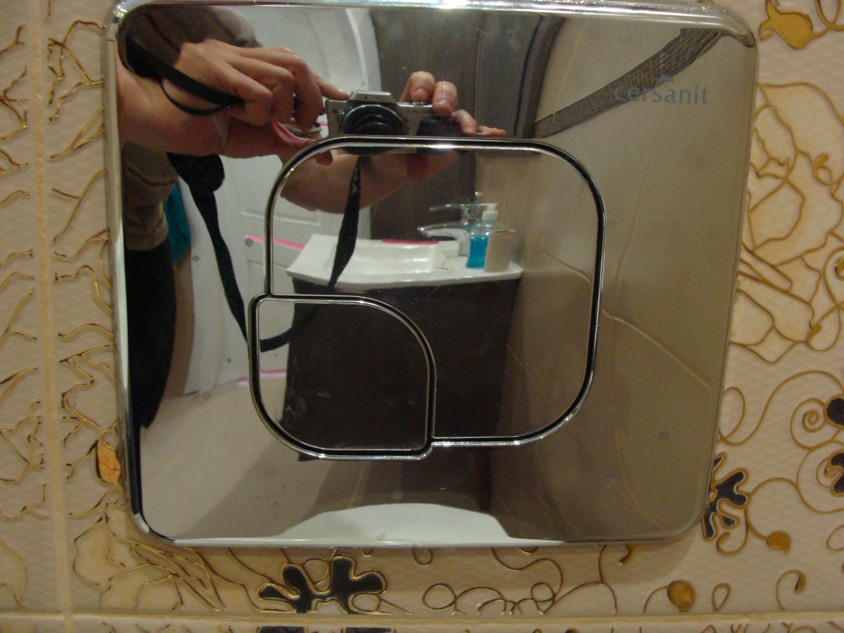

    I have a problem with a leaking cistern. I have to press the button several times to "bounce" and the water has stopped flowing into the toilet bowl. Unfortunately, in order to fix it, I have to take off the whole button and here the problem arises because I do not know how to do it. I attach a picture. Maybe someone has a similar one and has already taken it off?
    Attachments: To view the material on this forum you must be logged in.
  • #2 16956661
    lukasixthm
    Posts: 599
    Help: 60
    Rate: 381
    Try to lift the frame up parallel to the wall. It should be from the top on fixed hooks and from the bottom on springs.
  • #3 16956799
    aczu69
    Rate: 25
    Managed to. A bit of power, but without losses. It turns out, however, that you have to move the frame to the right and pull away from the right. At least in this model.
    Thank you for your help.

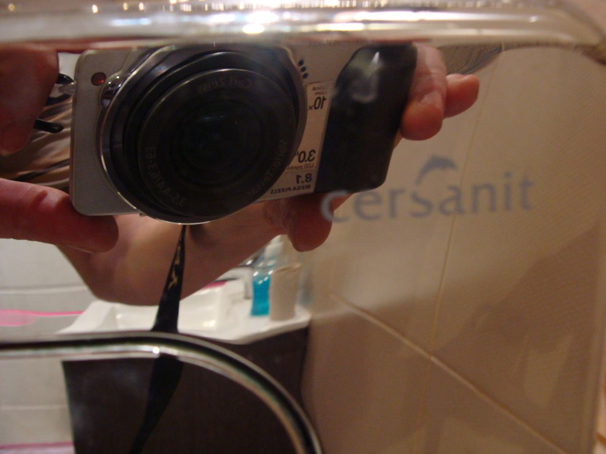

    Hello colleagues.
    I have a similar problem with leaking water and I would like to make sure how to dismantle the button from the Cersanit cistern and get to the valve, elements.

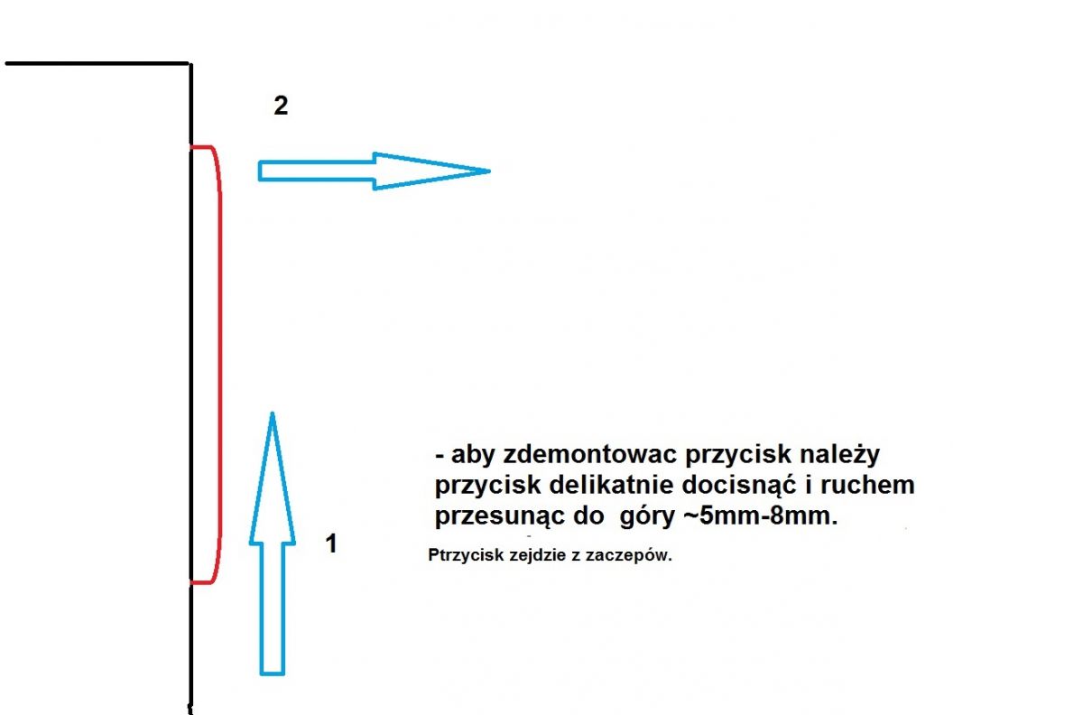

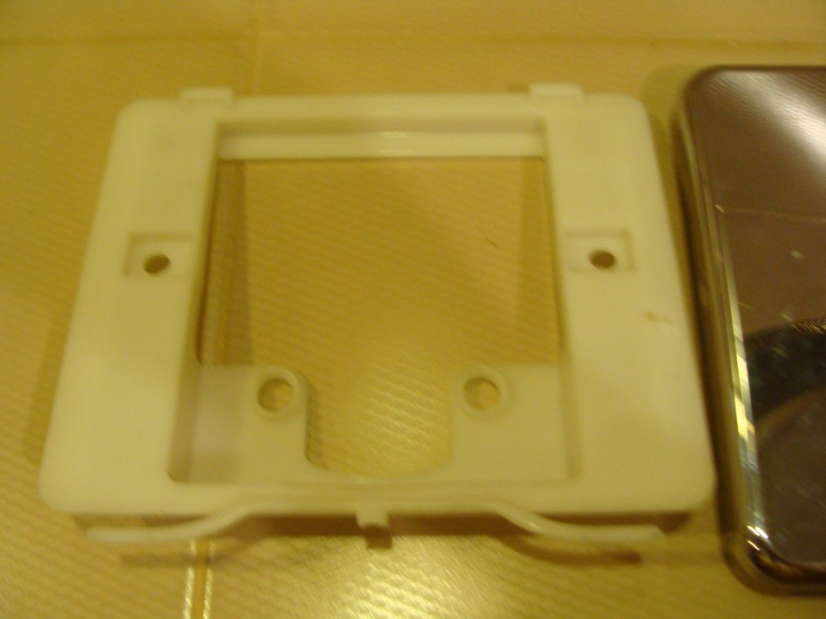

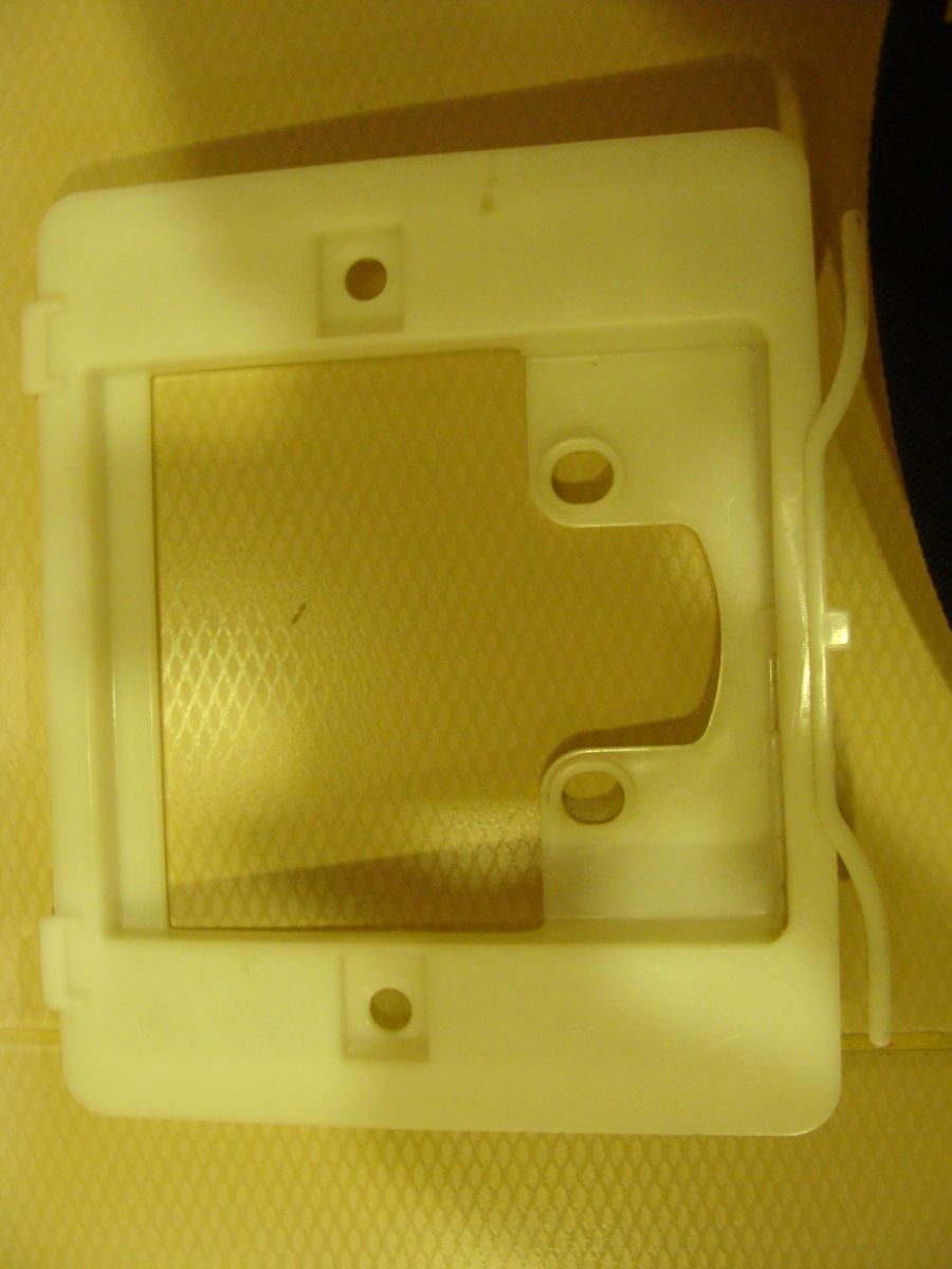

    Removing the "Cersanit" button
    Instructions for dismantling the Cersanit button Plastic mounting frame for Cersanit button on a light background. Photo of a mounting frame for a Cersanit flush button.
    Installation, assembly.
    Attach the button from the bottom and move it up to fit it onto the upper hooks.
