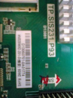

    okay, I got it started: TP.SIS231.P93 and under this one D13081

  • #17 17075966
    63
    Posts: 78
    Please try this
    • Sencor SLE-3210M4 matr.CA1T743 ch.TP.SIS231.P93 3210M4_kbi 315A1L03.bin (8 MB) You must be logged in to download this attachment.

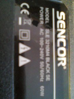

  • #18 17078887
    elmo071
    Level 30  
    Posts: 1057
    Help: 167
    Rate: 800
    I have such a batch can help:
    SENCOR-LED-TV SLE3210M4 BLACK SE
    Motherboard: TP.SIS231.P93
    Memory: U5-GD25Q64
    Matrix: HV320WX2-201-D
    Sencor SLE 3210M4 TV Cartridge Search: TP.SIS231.P93, KBI+315A1L03 RoHS, 25Q64 Batch Issues Sencor SLE 3210M4 TV Cartridge Search: TP.SIS231.P93, KBI+315A1L03 RoHS, 25Q64 Batch Issues Sencor SLE 3210M4 TV Cartridge Search: TP.SIS231.P93, KBI+315A1L03 RoHS, 25Q64 Batch Issues
    piotrmessi1984 wrote:
    okay, I got it started: TP.SIS231.P93 and under this yet D13081
    According to the markings on the second picture you can see the model the same
    • 47531_Sencor_LED_TV_m.rar (5.88 MB) You must be logged in to download this attachment.

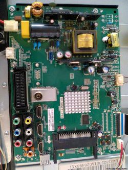

  • #19 17078931
    elmo071
    Level 30  
    Posts: 1057
    Help: 167
    Rate: 800
    Also feeds a colleague under the model
    Sencor SLE3211M4
    TP.SIS.231.P93
    u5 - W25Q64FV
    • 38252_SencorSLE3211M4.zip (5.24 MB) You must be logged in to download this attachment.
