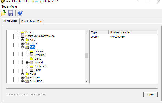

  • #13 16835299
    enceplacek
    Posts: 23
    Rate: 12
    I was able to upload the modified file to tv with the help of the second Vestel Toolbox 1.1 program. I have a question, is there an item responsible for calibrating the screen? Because what I attach from the screen is only responsible for changing the default settings in the TV's image modes. So it's basically good for nothing. Television Technique SM50-240 (vestel) unlocking the PVR function
