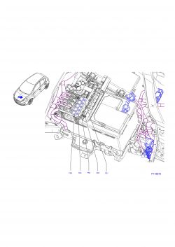

    I am looking for a Corsa D 1.3 CDTI engine control diagram (Z13DTJ year 2007) and a description of the fuse box with relays. Will someone help?

    The box is different. I have a description of the fuses, I miss the description of the relays and the diagram. I have a Corsa C, but I think it differs in details. The car does not burn and I certainly lack power on the pins from the computer. I have to check what comes from where. When it came to me, it discharged the entire battery because the fuel pump was running all the time, but it was smoking. Something is rotten somewhere and I need to find it.

    in the engine compartment:
    Opel Corsa D 1.3CDTI - I am looking for a fuse box and controller diagram
    Components
    K5 A / C compressor relay K40 Relay - filter heating
    K26 Relay for engine management. K45 Relay for high beam
    K30A Radiator fan relay K47 Horn relay
    K30B Radiator fan relay K49 Heated rear window relay
    K30C Radiator fan relay K50 Relay, terminal 15
    K34 Relay for fuel pump K61 Relay for starter
    K39 Relay for fog lamps K72A Relay, terminal 15a
    Added after 5 [minutes]:
    Components
    FA1 Fuse FA3 Fuse
    FA2 Fuse K16 Relay - blower, auxiliary heater with remote control
    Added after 3 [minutes]:
    Components
    FB1 Fuse FB4 Fuse
    FB2 Fuse FB5 Fuse
    FB3 Fuse
