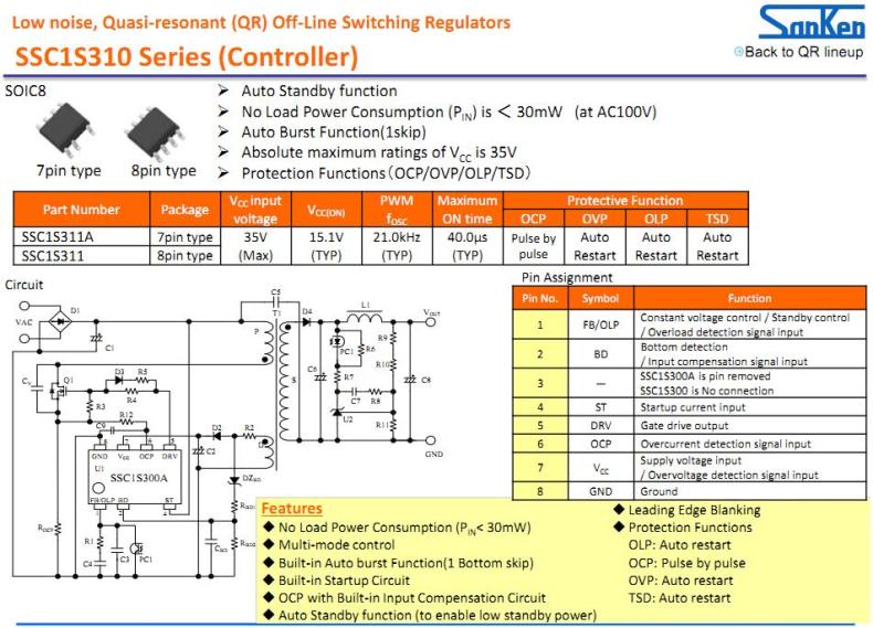

    Nothing like this one now.
    Only after the layout applications and what was written about them, for example, on this forum.
    Power supply pcb: EAX64560501(1.7) LGP32-12P
    * with LGP32-12P being the general name, valid rev.
    or Manufacturer Part Number (p/no) : EAY 62769501
    based on:
    - ICE3BR0665JZ,
    - SSC1S311
    - L6599d
    Inverter: PPW-LE32RG-0(C)REV0.8
    T-con:6870C-0370A
    Panel: LC320DXN(SE)(R2)
    _____________________
    The same LGP32-12P description, e.g. for the LC320WXN matrix
    Inverter : PNEC-D032A REV-0.1
    -OZ9966SN
    PSU LGP32-12P (P/N EAX64604501 (1.5) )
    - L6599AD ,
    - HS01G , (SSC1S311 )
    - FSL106HR
    PSU: LGP32L-12P , pcb: EAX64324701 (1.5) P/N: EAY62512301
    - matrix T320XVN0 1.1
