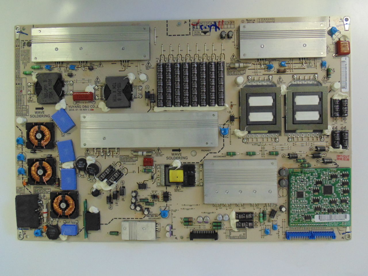

    Please i want schematic diagram for power supply for lg 42LE5500
    or any site that ican buy from it

    PSU in this one is EAY60803201 (board is customised for this model i.e.. PCB has jumpers that change the pcb parameters & model number etc for other types of screen (notably AUO screen or LG) /
    * or. EAY60803101 / EAY60806101
    LG 42LE5500 Power Supply Schematic: Request, Sources to Purchase or Download
    Chassis/Version: LD03E
    Panel: LC420EUH (SC)(A1)
    LED driver (backlight): integrated into PSU; 118V 660mA (42 inch LG)
    - PWM LED driver: AS3693B, MEGA48PA
    Power Supply (PSU): PLDF-L903A EAY60803101 / 3PCGC10008A-R
    - with PWM Power: VIPER27H (Standby), ICE2PCS04 (PFC),
    pic. EAY60803201

    Write what's your power supply and that there are IC in your model.
    * and write what the matrix is applied
    pls.
    LG over the last few years has ceased to publish diagrams of power supply units from their TV.
    Itis necessary to rely on the schemes from their manufacturers ( if they give ? ) or solutions power supply PSU units on the basis of these applied IC

    As I wrote , there is no schematic of this power supply or similar.
    Is Not even in the Service manual for 42LE5500.
    Only after the apps out there, applied IC
    Model: 42LE5500-xx
    LG LED TV 42LE5500
    LED driver (backlight): integrated into PSU; / **118V 660mA (42 inch LG)
    Power Supply (PSU): PLDF-L903A EAY60803101/ 3PCGC10008A-R
    ICE2PCS04 (PFC) and L6599D

    Hola a todos, por favor, si alguien me puede ayudar con el esquemático de PCB EAY 60803101 de LG. Llega al taller con el fusible F102 abierto y el zener B68 en corto, al igual que el oscilador Viper 27H. Hago los reemplazos, pero no logro que la fuente oscile, por lo tanto, no hay standby. Agradezco mucho la ayuda que me puedan brindar.
