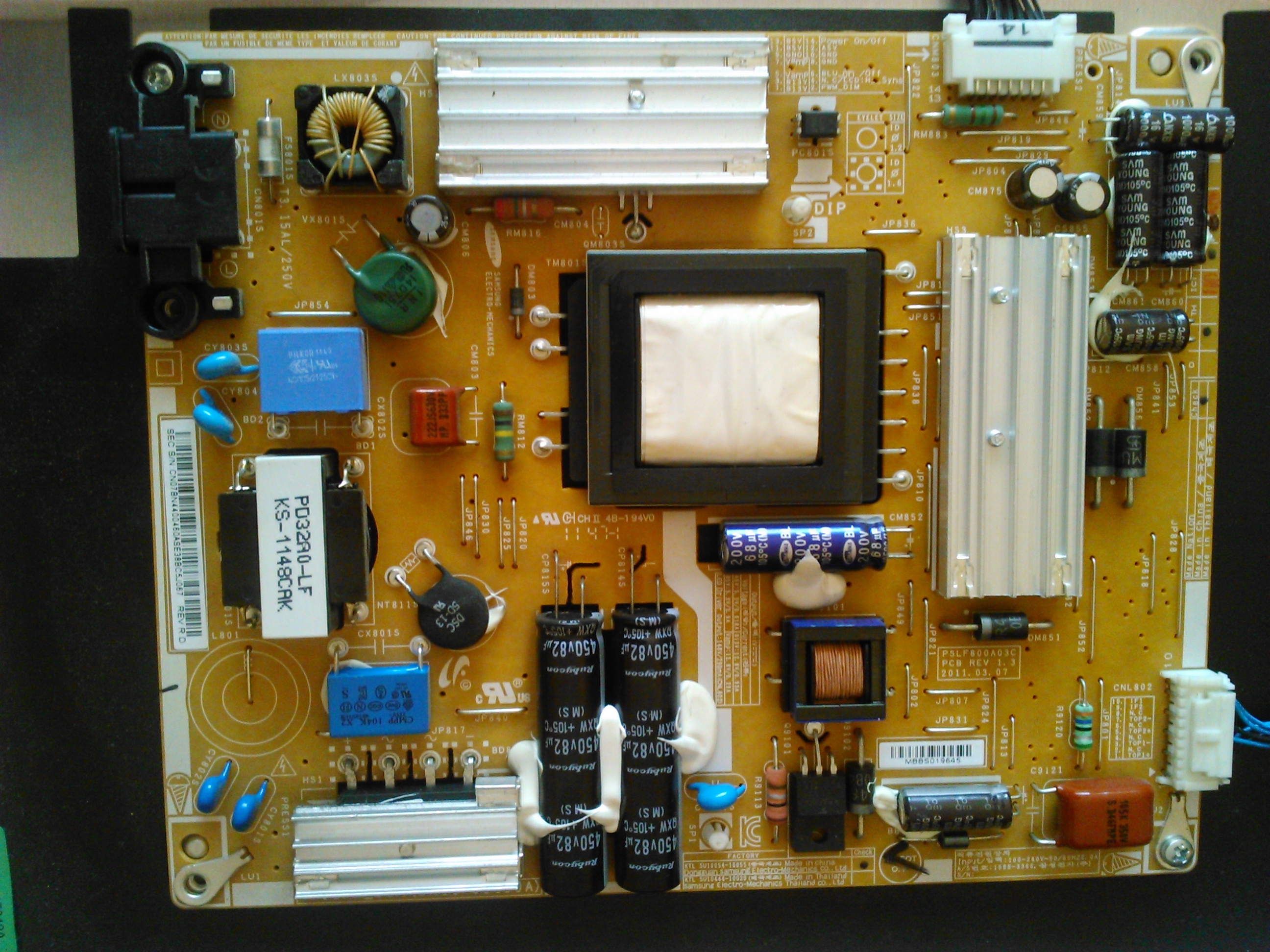

    Motherboard BN41-01660B
    Power Supply
    Samsung UE32D5500 TV - LED Blinks 5 Times, No Sound or Remote Response, PSU Voltages OK
    More specifically? Second, more important number?
    mkpl wrote:
    Power Supply
    + picture. And the search engine will read the name from the picture. ;)
    Can't the letters BN44-00460A and / or PD32AF_BSM or PSLF800A03C?
