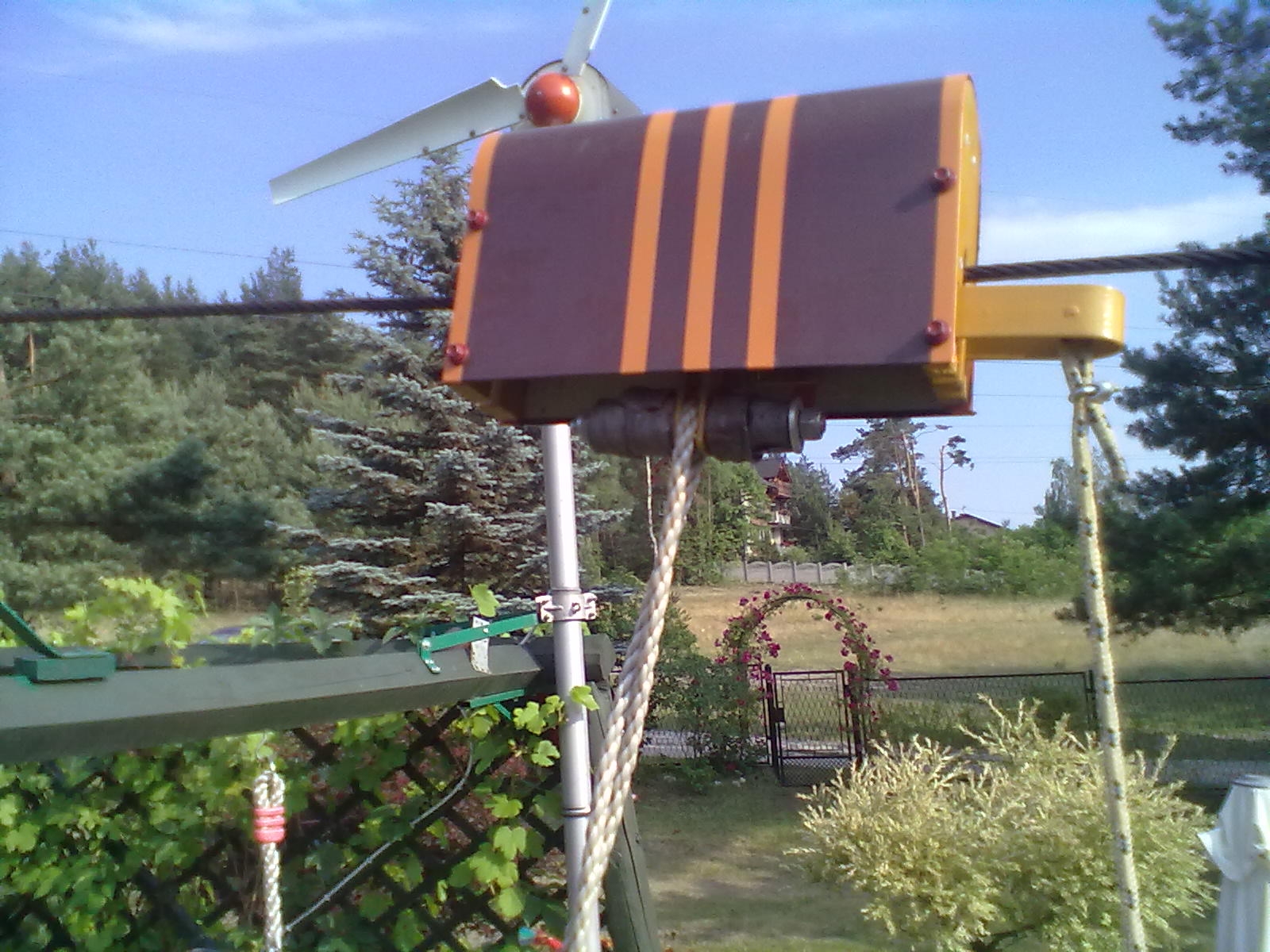

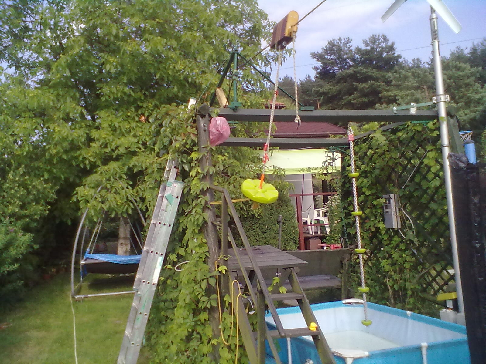

    Zbigniew 400
    Posts: 4356
    Help: 283
    Rate: 794
    A loop of rope and two wheels above the lifting line.
    I can send you photos.
    I'm making a drive for this ..

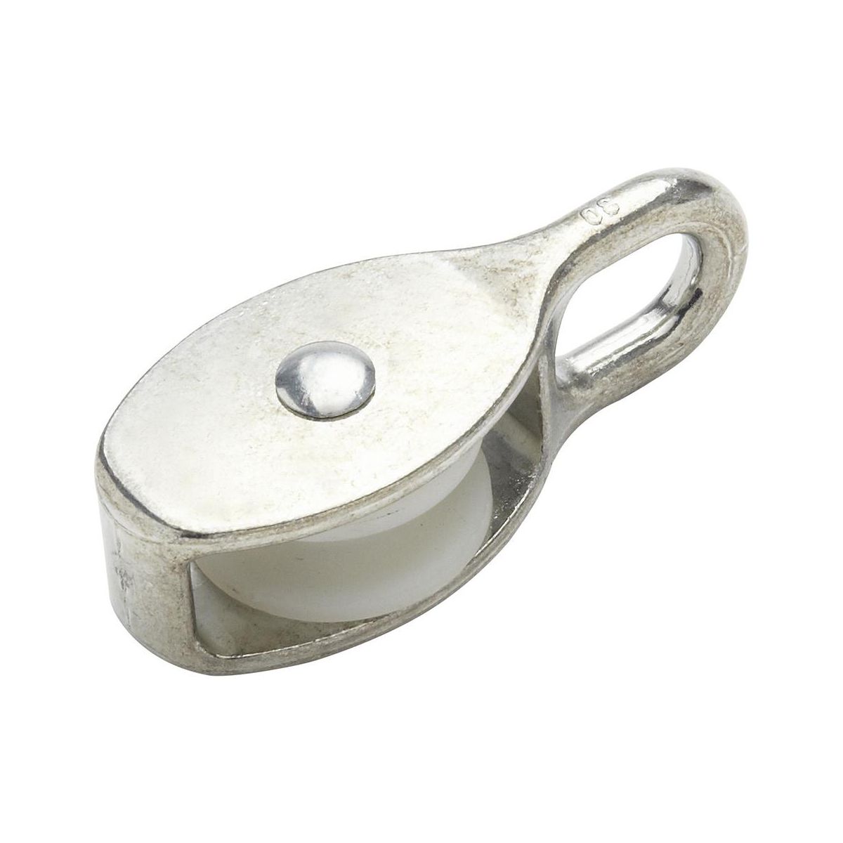

    Now the question about the pulley, why do there have to be two rolls and where, for example, as for a colleague, take the diameter of 100mm? there can be no such thing as in the picture? I do not plan to save, also take it easy :) I am asking for a technical approach.
    • What rope for the zip-line descent bloczek.jpg (66.76 KB) You must be logged in to download this attachment.
  • #18 18193728
    Zbigniew 400
    Posts: 4356
    Help: 283
    Rate: 794
    Solution example
    What rope for the zip-line descent What rope for the zip-line descent What rope for the zip-line descent

    wzaj50
    Posts: 43
    Rate: 11
    To m-blue. Two wheels because the brake is built between them, in the middle. The diameter of the rolls 100 mm so that they were smaller rev. and then quieter at the exit. The roller that you showed is about 40 mm in diameter and does not have a rolling bearing (there will be a high rolling resistance) My rollers are on ball bearings.

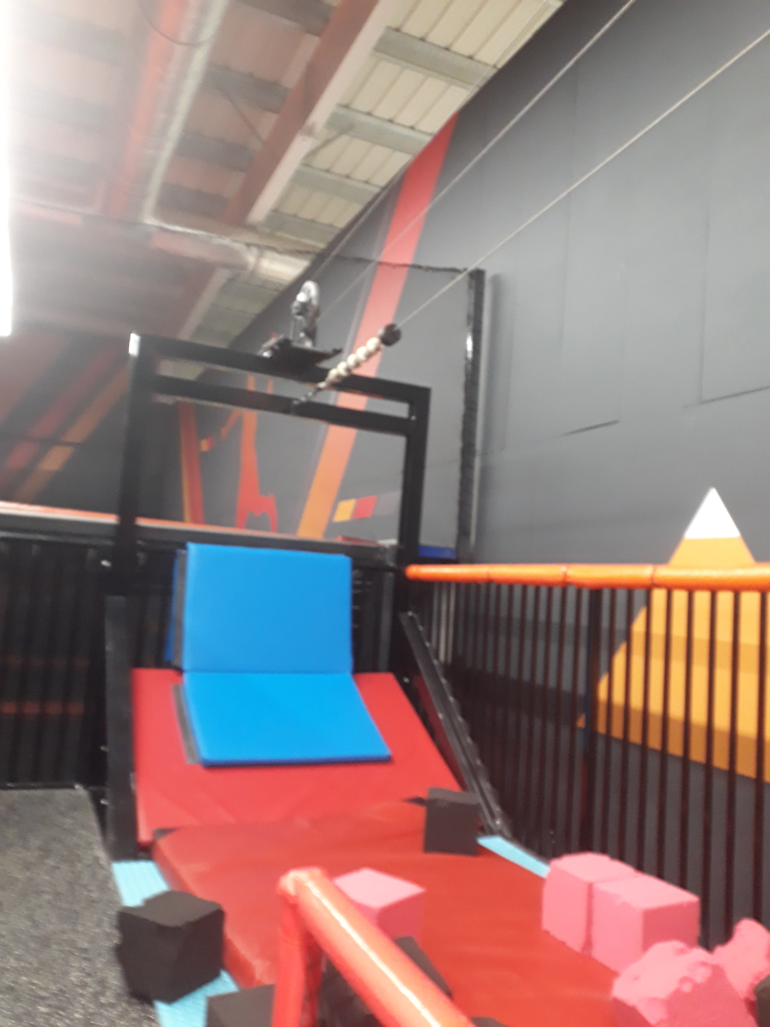

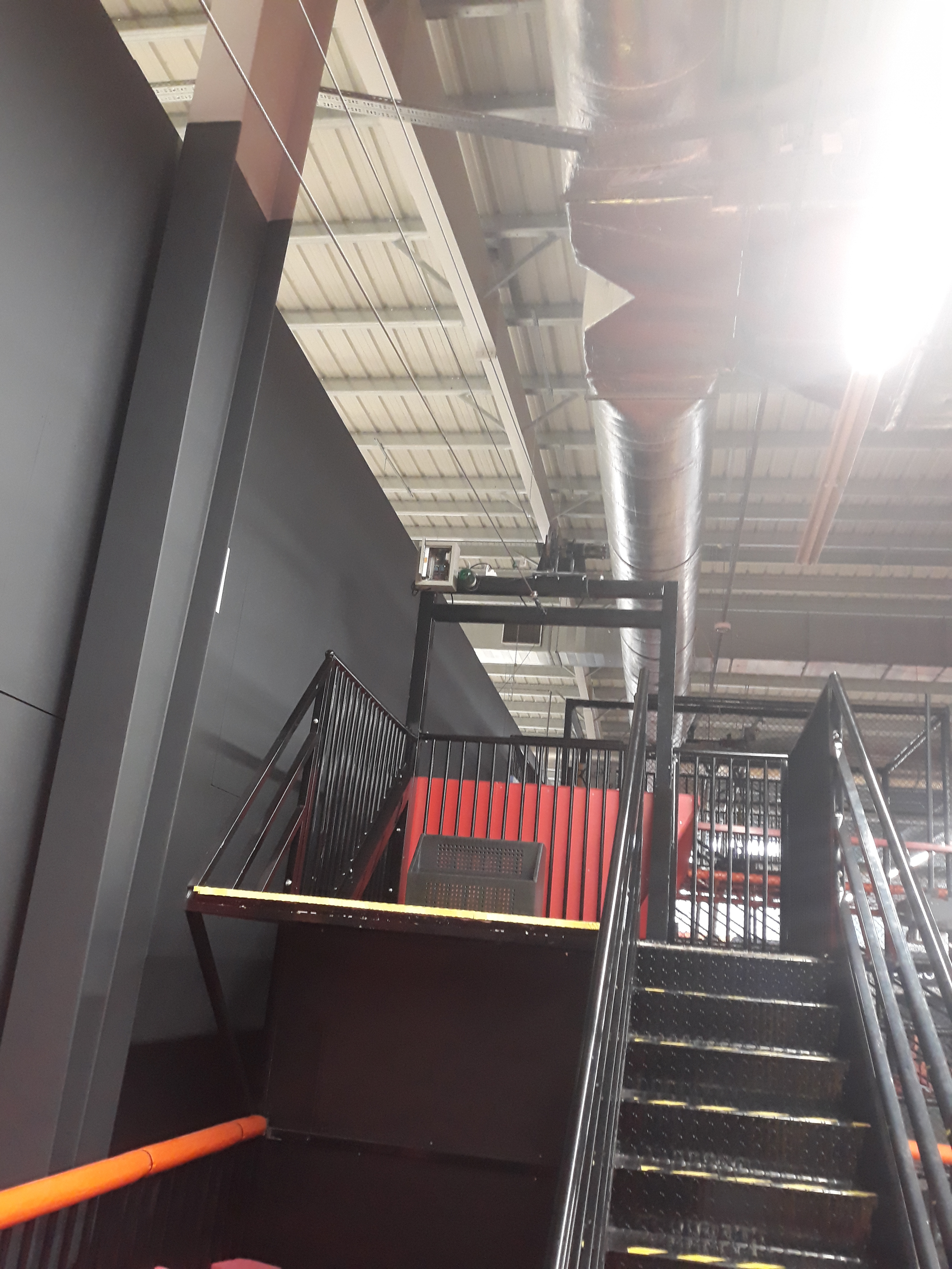

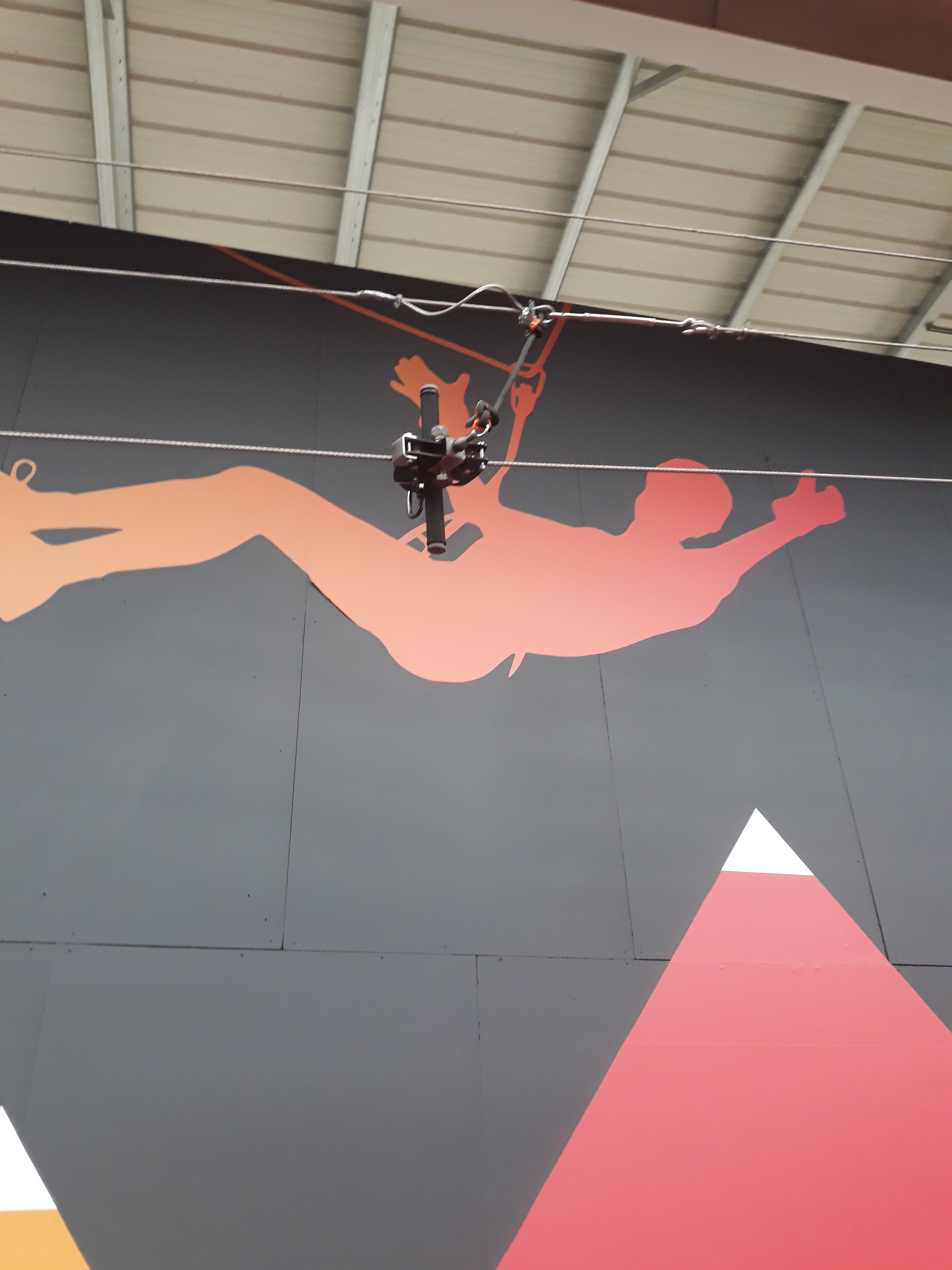

    In turn, I wanted to ask if anyone has knowledge about the construction of commercial zip lines exceeding 500 m in length. Namely, it concerns the issues of construction (thickness of the rope, degree of inclination of the rope so as not to be too slow).
    Thank you in advance for any information provided
