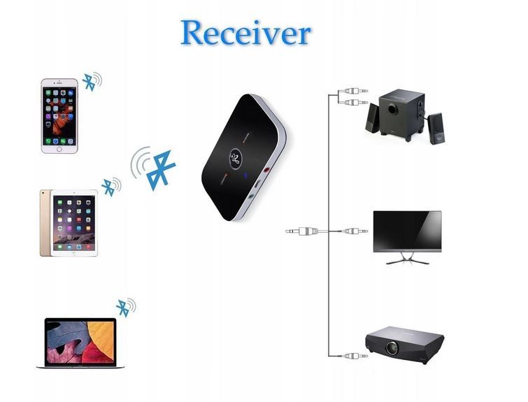

    How to make such a connection wirelessly via Bluetooth?
  • #7 20745170
    mariann
    Posts: 3469
    Help: 549
    Rate: 646
    You buy a Bluetooth receiver with an RCA output (depending on what input you have on the amplifier) and that's it. You pair your phone with the receiver and you have a signal to the amplifier. Such a receiver costs a few zlotys on a well-known auction site. They usually have a small jack as a signal output, but all you need is an appropriate connector and it works.
    Regards.

    But we are talking about a vintage amplifier without a USB input. It must have RCA.

    stefankovalsky wrote:
    But we are talking about a vintage amplifier without a USB input. Must have RCA.
    That's right - we're talking about an amplifier without USB.
    The USB socket in the Bluetooth transmitter/receiver is used to power this device, or it can run on an internal battery, but you need to charge it from time to time. Look at the picture to see how it can work in receiver mode. @mariann has already written about the connection
    Diagram showing Bluetooth receiver working with mobile devices and audio-visual equipment.
