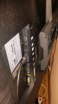

  • #8 16785190
    Lobek3006
    Posts: 7
    Connecting JVC Home Theater from Used Store: Subwoofer Sound & Power Light on but Incomplete Setup
    There is a connection of this type of home theater to the TV with such inputs with attached in the photo.
  • #9 16785857
    Polon_us
    Level 42  
    Posts: 6937
    Help: 1184
    Rate: 1280
    You can connect this TV and cinema with a TosLink optical cable.
    Both devices have these sockets.
  • #10 16788680
    Lobek3006
    Posts: 7
    And some other solution because it doesn't work. It seems to me that an optician in a cinema should shine just as it is in TV. The TV cable is lit, the plugs are removed.
  • #11 16789188
    Polon_us
    Level 42  
    Posts: 6937
    Help: 1184
    Rate: 1280
    Optical output activated in TV settings? -> instruction
    Cinema set to optical input? -> instruction
    And so off the beaten track - the TV has a headphone output?
  • #12 16829114
    Lobek3006
    Posts: 7
    The tv has no output for headphones. However, an optical cable was enough and the amplifier should be properly positioned under the optics. The cinema will work right away. I just don't have time to connect the speakers because I have overtime at work ... I hope I can put it together before Christmas xD. Thanks a lot for the hints ?
