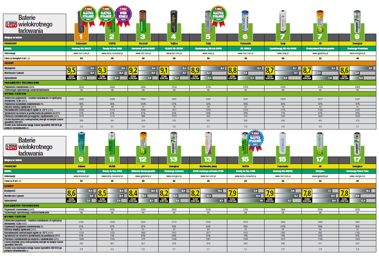

    Varta is on par with Eneloop here.This is a test table for AA batteries.
    Comparing AAA Varta Ready2use 1000mAh and Eneloop Pro 930mAh Rechargeable Batteries .

    JanekSokół wrote:
    Varta is on par with Eneloop here.This is the AA battery test chart.
    I wrote you down because I happened to use both these and these, although the fact is that eneloop in a larger quantity (about 20 pcs.) and Varta only one set of 4 pcs.
    From those in the table I also used Sanyo 2700, and it would be difficult for me to praise them, because although they have a large capacity, they also have a very large self-discharge. They are probably suitable for, for example, powering toy cars and other similar applications, where capacity and the ability to give up energy in a short time are important. I rather value long-term energy conservation and here eneloop are unbeatable.
    For example, in the weather station eneloop (the same set of 3 pcs.) I use about 6 years and charge regularly in the spring and autumn. No problems at all. And yet eneloop have only 1800mAh (the white ones). Sanyo 2700mA ones probably last less than a week there. And what do I care about their 2700mA, for which they certainly got a lot of points in this table, if they lose them in a couple of days? Incidentally, they didn't shine with durability either, the 6 years of service life they already have behind them eneloop can't even dream of.
    What advantages does Varta have? I don't know, I haven't discovered. Maybe it just can't get along with my charger? I don't remember the details, but I think the accepted charge was much lower than nominal. As far as I remember their main drawback was low operating voltage. In the end, I think they ended up in some remote controls and there they somehow manage. With emphasis on "somehow".

    JanekSokół wrote:
    I just don't quite trust the tests on the web,but it certainly gives some food for thought.
    For me, a reliable test would be to test rechargeable batteries up to the contractual limit of usage.
    Varta is softer than Eneloop I suspect it has more internal resistance(you need to check in the specs) see '' average charge time for Canon lamp'''

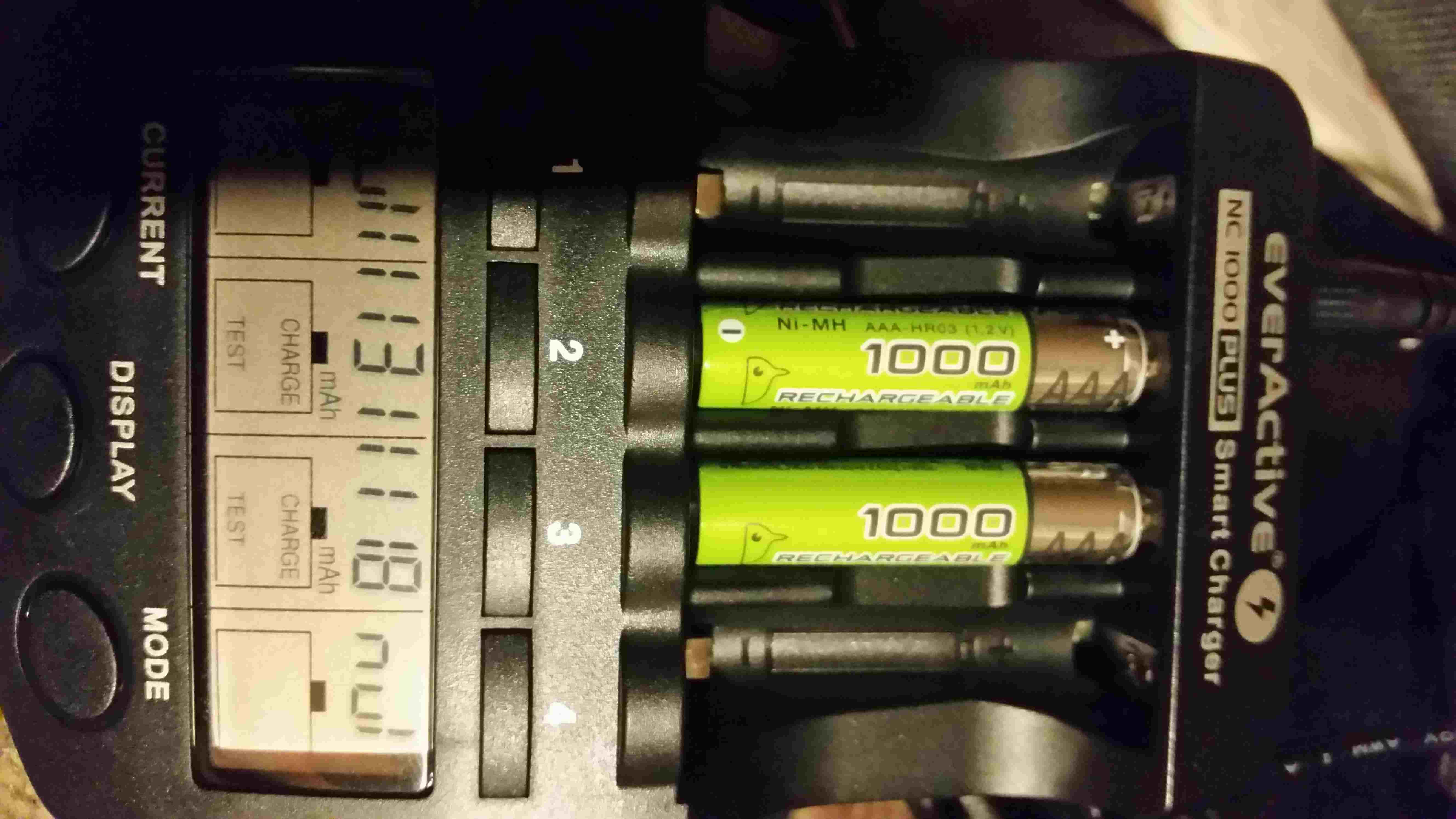

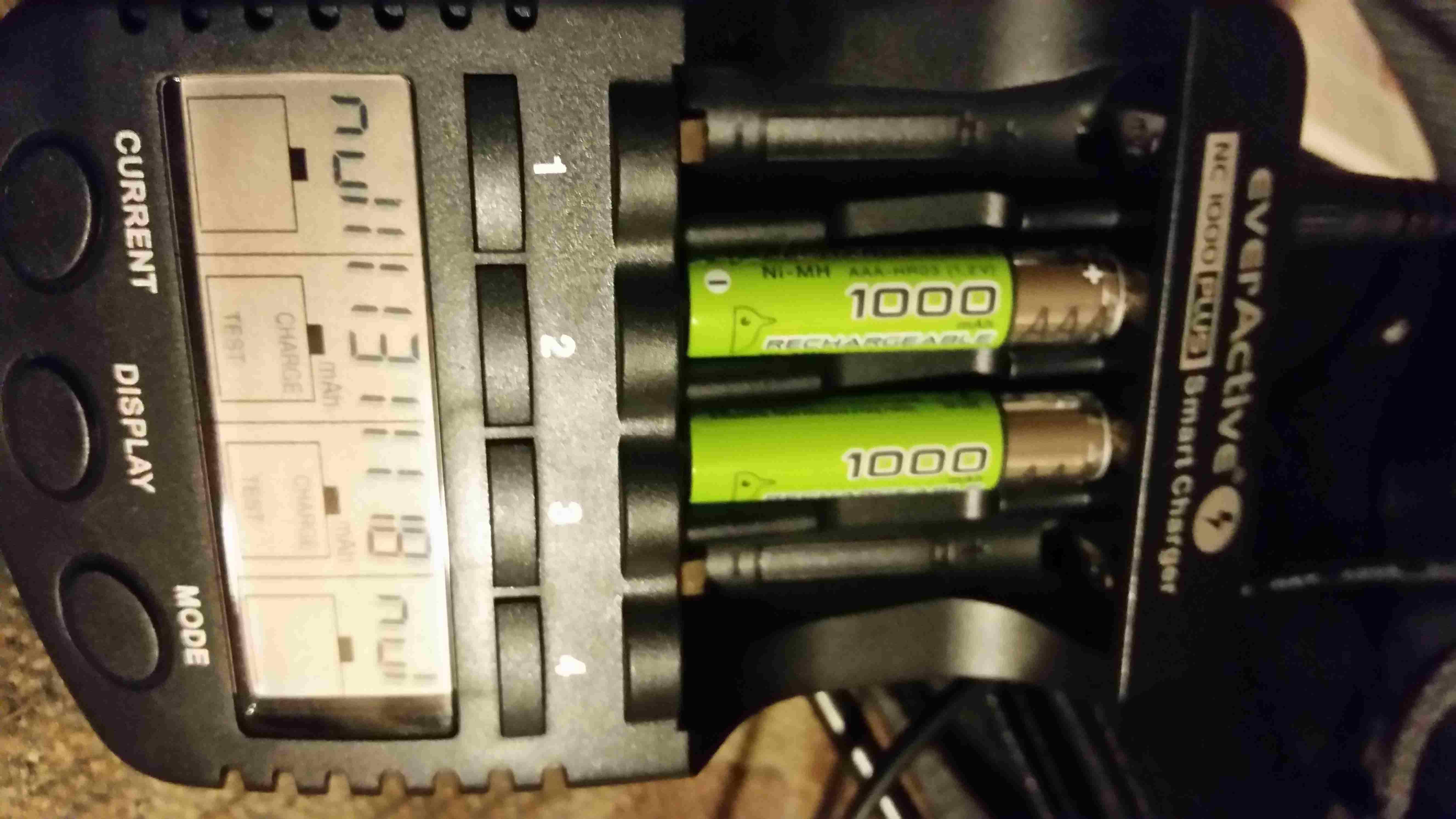

    I'll show you what I bought today..... and I'm shocked
    rechargeable batteries from Auchan: AAA 1000 Ni-MH Rechargable
    What YOU think about it???? Comparing AAA Varta Ready2use 1000mAh and Eneloop Pro 930mAh Rechargeable Batteries Comparing AAA Varta Ready2use 1000mAh and Eneloop Pro 930mAh Rechargeable Batteries

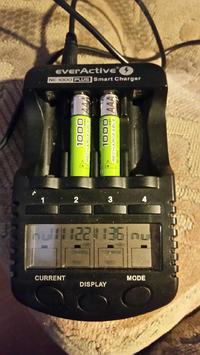

    Results after several cycles...
    I'm still in shock ;-) Comparing AAA Varta Ready2use 1000mAh and Eneloop Pro 930mAh Rechargeable Batteries .
