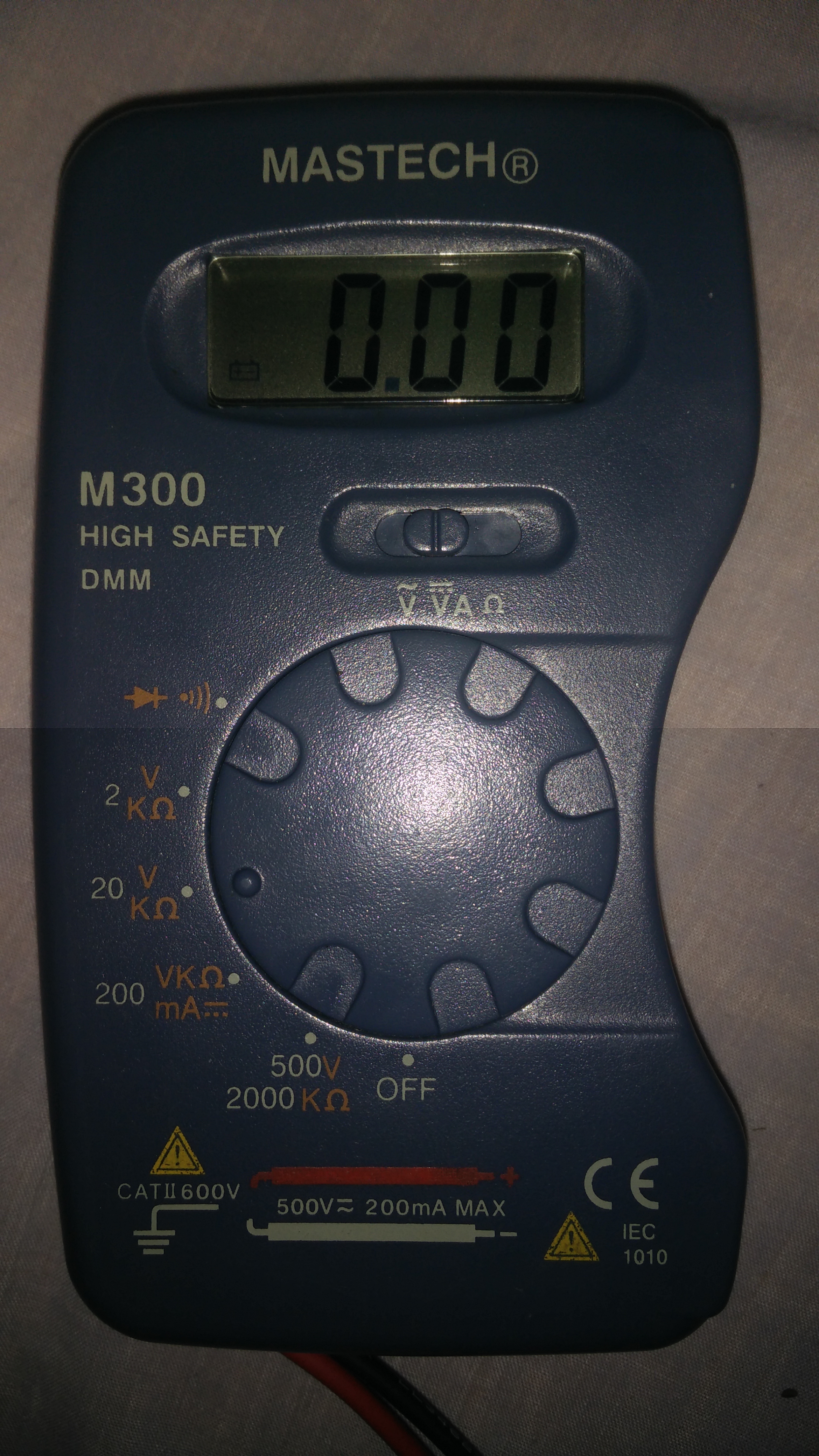

    At the beginning I will mark that I am completely green with electronics, that's why my colleague recommended this forum to me.
    And now to the point:
    My dad has some AA and AAA batteries with different capacities:
    AA:
    Energy 1700 mAh 1.2 V
    Energizer 2000 mAh 1.2 V
    Tronic Energy 2500 mAh 1.2 V
    One no-name 4300 mAh 1.2 V
    In addition, I bought it in Lidl yesterday
    Tronic 2300 mAh 1.2 V
    AAA:
    TESCO greener living 850 mAh 1.2V pieces 2
    Viopow 900 mAh 1.2V - 3 pieces
    Tronic 900 mAh 1.2V - 2 pieces
    And yesterday purchased:
    Tronic Eco 950 mAh 1.2V - 4 pieces
    In addition, I bought the charger for them also in Lidl
    Tronic Universal battery charger TLG 500 B1
    PRI: 100-240V ~ 60 / 50HZ 150mA
    SEC: 3.34VA (max)
    (1-2) X (1.4V -... 1000mA)
    (3-4) X (1.4V -... 500 mA)
    2 X (9V -... 300mA)
    I have included charging AA batteries and what's the most interesting after just 1 hour the green LED on the charger has been lit - they are a bit weird - it's a bit strange for me that it's so fast :(
    I have at home such a tester for batteries and accumulators and actually after inserting it shows 1.2V - 1.4V on 1.5V batteries on the battery but of course this battery has 1.5V.
    I also tried to measure them with the help of the meter but here the fun begins to be unintelligible for me.
    Namely, I know that red is a plus, a black minus, I set on the meter 20V and V -... (this is a dash and below it (...).
    And here the values he gets given in brackets.
    Energy 1700 mAh 1.2V - (1.75V)
    Energizer 2000 mAh 1.2V - (1.94V)
    Tronic Energy 2500 mAh 1.2V - (2.00V)
    One no-name 4300 mAh 1.2V- (1.98V)
    Tronic 2300 mAh 1.2 V -
    (2.08V)
    (2.10V)
    (2.10V)
    (2.12V)
    AAA:
    (2.14V) and (2.07V)
    (1.64V) (1.45V) (1.48V)
    (1.46V) (1.90V)
    I do not know which one I have not opened yet but the producer ensures that they have 75% of the power to start.
    Attached my meter :)
    Evaluating Charge State of Various AA and AAA Batteries with Tronic Universal ChargerIMG_201703...145937.jpg (4.03 MB)You must be logged in to download this attachment.
    Do I do something wrong or the results are good, how to check it out, I am asking you for help and thank you for every support :)

    From the description of the charger it appears that it detects the charge, so probably the rechargeable batteries charged for an hour - maybe they were partially charged, maybe they have a small capacity ...
    And what about the meter, you checked what voltage shows for a regular 1.5V battery? For the new one should be around 1.6V, maybe even a bit more - but not more than 2V. Unless it's damaged.

    For a new battery, the meter set as in the picture above indicates:
    (2.42V)
    The battery is BATT EXTRA AA 1.5V

    D214d3k - this charger is probably a microprocessor (unless they lie in the description).
    For a new battery, the meter set as in the picture above indicates: (2.42V)
    The meter may overstate the indications (and this significantly) if it has a discharged battery - try to replace it with a new one.
    Especially that the picture shows that the meter shows "battery discharged" ... (lower left corner of the display)

    They look inflated, because the NiMH battery rarely has voltage above 1.5V (well, maybe some freshly charged), and the battery does not have 1.795V - but less than on yours. Look, or does it not give an indication of a "used battery" like yours. And maybe change the battery in yours, and see what voltage will show then?

    The battery in this new one was newly installed before the measurement, so it is probably good :)
    I will next cut and check on this new meter batteries from that. :)
    Added after 1 [hour] 42 [minutes]:
    I checked the batteries from my meter on the borrowed and the result is as follows:
    Panasonic lrv08 23A 12V MN 21 battery.
    On the new meters it shows [6.673V] :)

    As it has 6.67V at nominal 12V, it's no wonder that the meter does not show well. Replace with a new one.

    I changed the batteries in my meter and these are the results:
    Borrowed (...)
    My [...]
    Energy 1700 mAh 1.2V - (1.370V) [1.38V]
    Energizer 2000 mAh 1.2V - (1.348V) [1.36V]
    Tronic Energy 2500 mAh 1.2V - (1.367V) [1.38V]
    One no-name 4300 mAh 1.2V- (1.344V) [1.35V]
