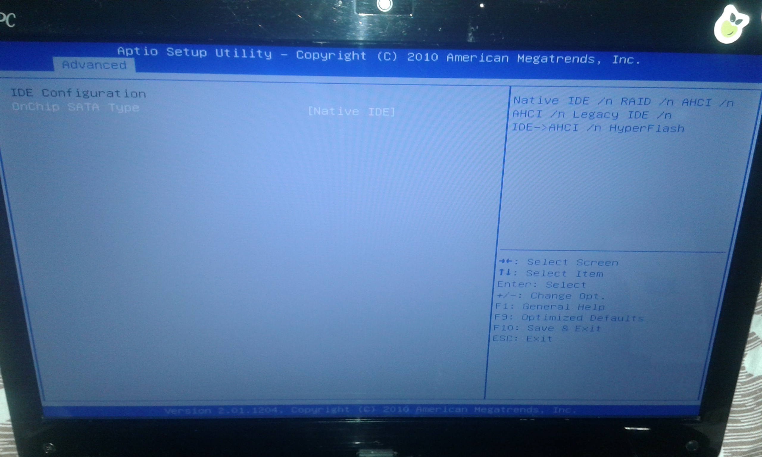

    See what's in the IDE Configuration
  • #9 15627477
    TERRORCORE
    Posts: 38
    Rate: 7
    Accessing Boot Menu on Asus Netbook: F4 Key, Windows Loading Issue, ESC Key Function
    I can change it to IDE -> AHCI

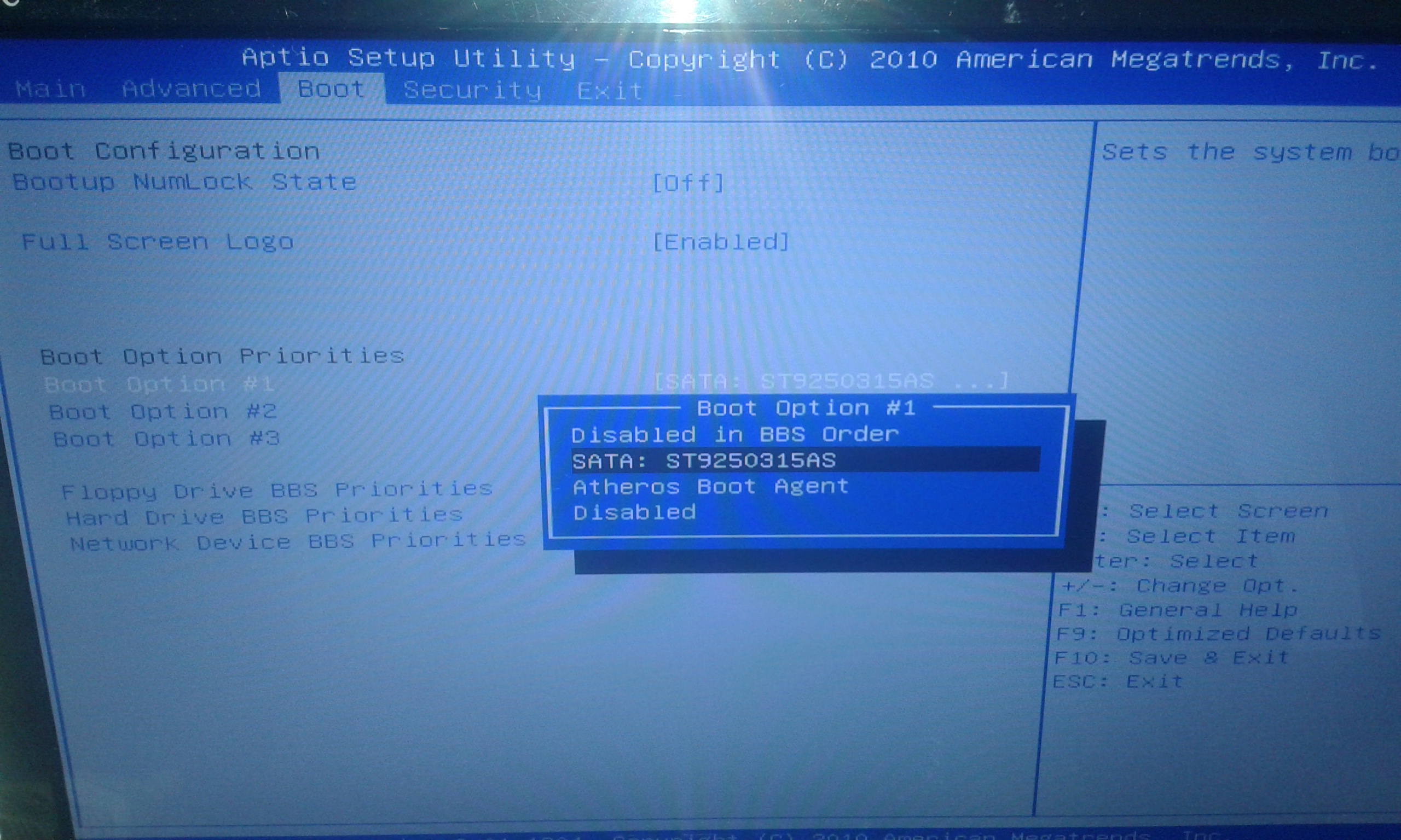

    from what I can see, I can't see Pena on the list,
    photo with advanced> onboard devices,
    maybe insert to another port, turn on the computer and the boot tab,
    Ev. take a photo of boot option 2,3.
  • #13 15632754
    TERRORCORE
    Posts: 38
    Rate: 7
    I also noticed it with bios The BIOS does not see this penny pendrive. After connecting to another port it is the same and in Boot Option 2 and 3 it is the same as in Boot Option 1.
