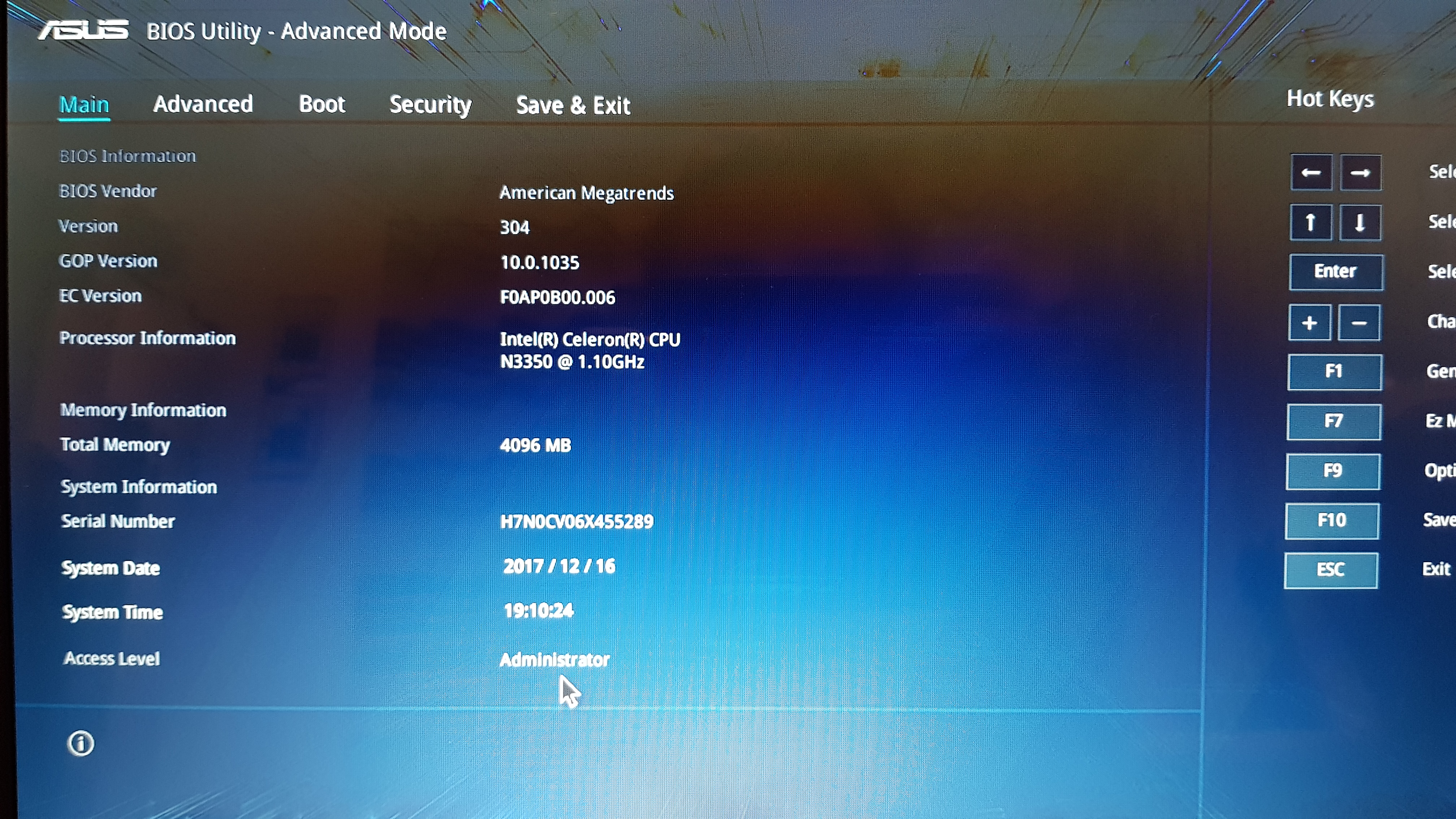

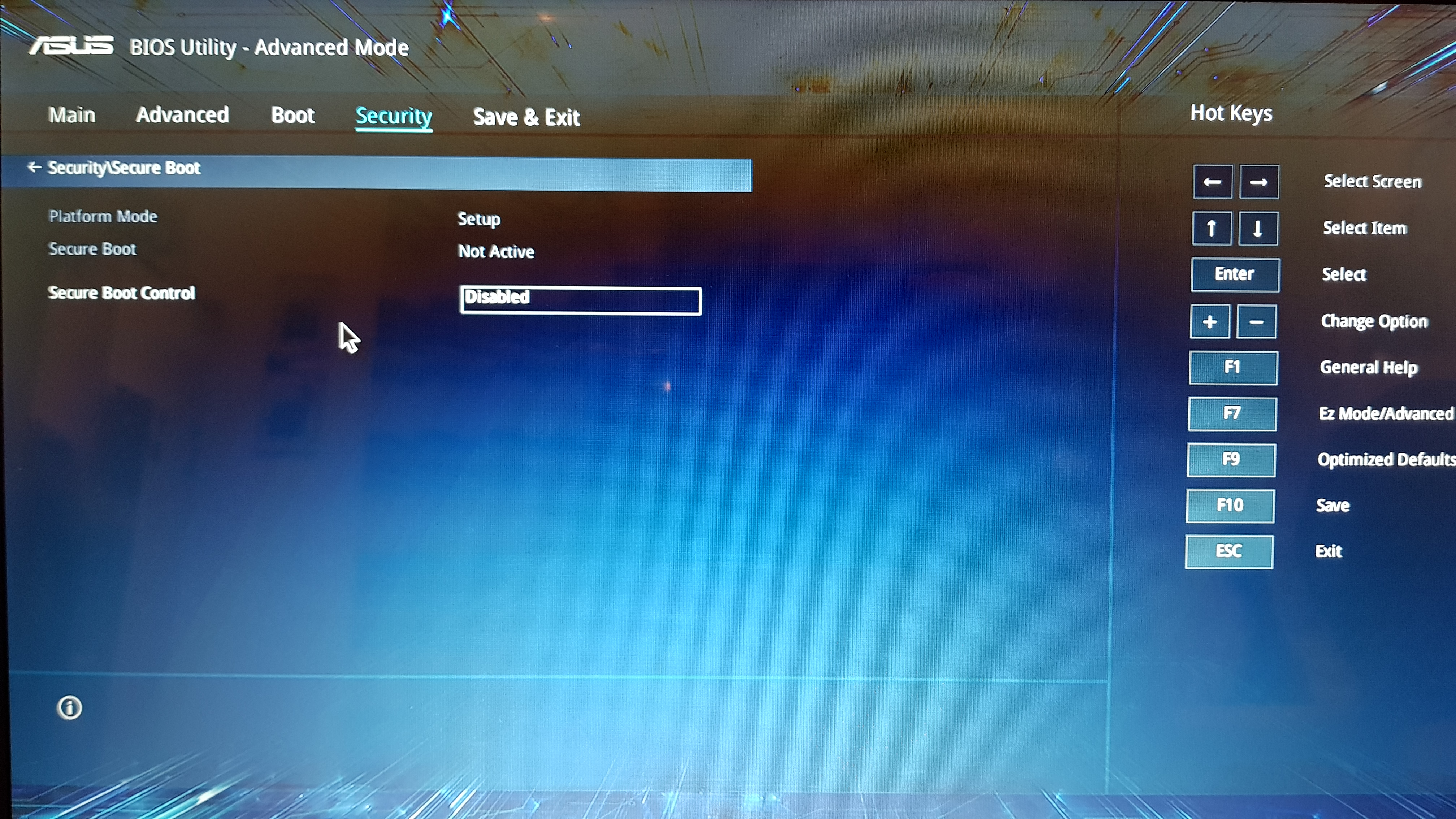

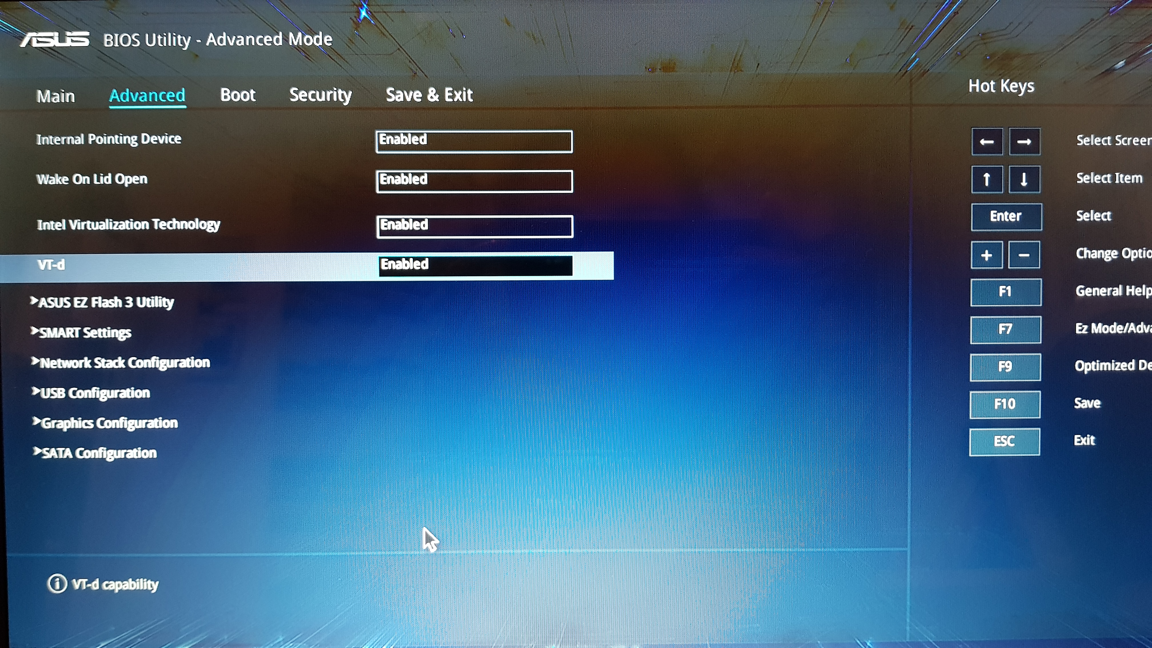

    Yesterday I bought an Asus F751N Laptop with a 304 BIOS. Honestly, for the first time I am dealing with a bios different from the classic one. The thing is that now the hardware is usually loaded Windows 10, which I can not work for anything. So - I uninstalled '10 and set it to BIOS, okay - priorities set to dvd cd rom, in Security Secure Boot Control to disabled, I'm just looking and looking for where to change from UEFI to CSM Legacy. There is no option. I tried to install without, but a startup problem. It hangs on Windows Starting. Somebody knows?

    Will you install anything other than 10 on this? Skipping that there is some celeron sitting there is a problem with controls graphics drivers for a system other than 10.

    3 weeks of fighting and nothing helped. I have installed Windows 10 with 4 times. Secure Boot disable, and csm vain to look for. Unless there's something we don't know about, buddy .....

    Fast Boot turned off too?
    Have you looked at whether 8 or 8.1 starts better? Maybe you need to add UEFI to windows?
