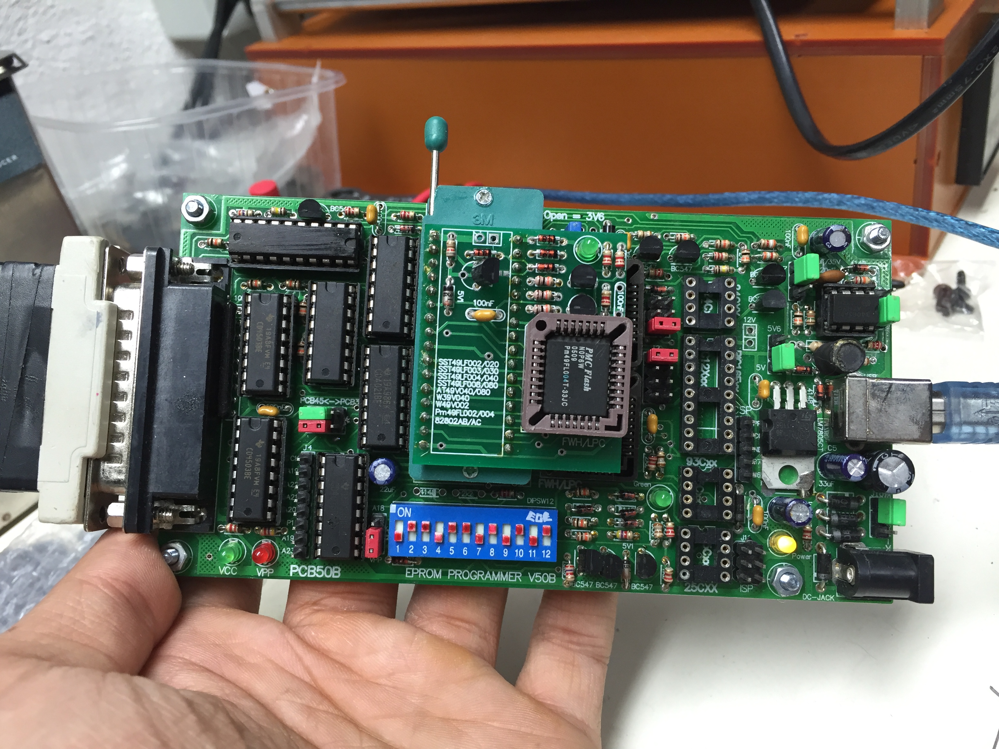

    motherboard gigabyte ga-k8nf-9 with bios corrupted. the eprom is pm49fl004t-33jc
    i've willem programmer pcb50b but it not recognize the chip! i've clicked on device->fwh/lpc->pmc->pm49fl004
    but when i click device id it is not recognized!
    so i've bought the fwh/lpc adapter but it still not recognized!
    could you help me?

  • #7 15656292
    phantomEVO
    Posts: 8
    this is my programmer with my adapter.
    • Gigabyte GA-K8NF-9 Motherboard - BIOS Corrupted, Willem Programmer PCB50B Not Recognizing Chip IMG_5288.JPG (2.19 MB) You must be logged in to download this attachment.
  • #8 15656336
    conan02
    Level 30  
    Posts: 913
    Help: 174
    Rate: 91
    OK. My error, Google show me parallel version flash.
    Seems good adapter fot this chip.
    In this circumstances may be problem with used software (Pony or similiar), broken chip, wrong switch config.
    I had Willem and throw this apart - very unreliable, free software has only one positive - it's free. Try force programming without chip ID. Alghorithm is same for all LPCs, set only capacity and go.

  • #12 15656368
    conan02
    Level 30  
    Posts: 913
    Help: 174
    Rate: 91
    Why You not using FWH/LPC socket on main board? Switches for LPC/FWH config enables main PLCC32 socket not a DIP one.
    Pull adapter form DIP socket and use original socket located on main board. On photo on right from DIP, lower socket.
    Komputer Serwis
    Lwowska 147, Nowy Sącz, 33-300 | Tel.: 602-XXX-XXX (Show)
  • #13 15656398
    phantomEVO
    Posts: 8
    Because the software requests to insert the adapter. However, even without the adapter, the chip is not recognized
  • #14 15656418
    conan02
    Level 30  
    Posts: 913
    Help: 174
    Rate: 91
    Strange behaviour. Socket for LPC flash was located on board for some reason.
    Next tip - I see Willem 5.0 board, this software is dedicated for new 7.0 and 7.1 boards, maybe some incompatibility?
    No more ideas... I stop working with Willems on version 2.
    Last one - failed memory chip. If possible try testing equipment with other LPC chip. If will succeed You have broken flash, if not - then probably is programmer or software error.
