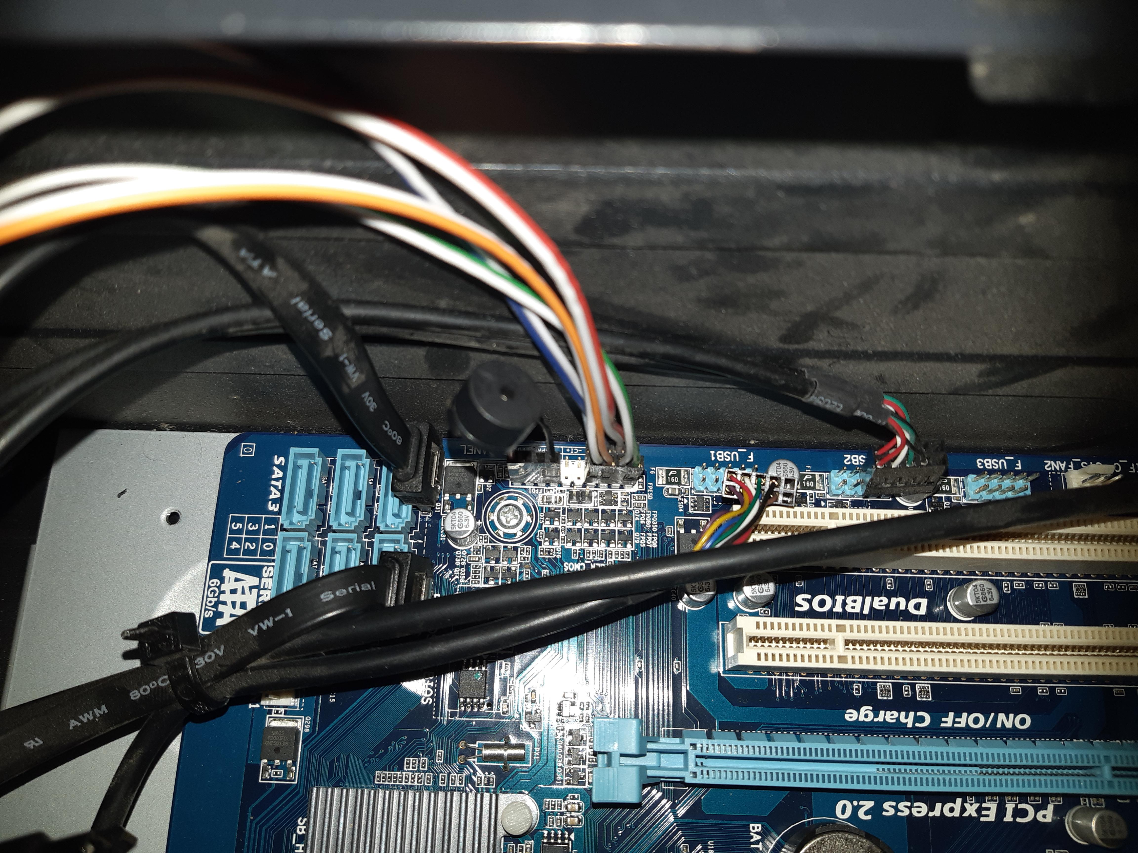

    As I wrote, I gutted it from what I could, only the processor, the motherboard, and the power supply remained. I disconnected the SATA connectors from the drive and the drive, the USB cables from the ports on the front and the card reader. Removed RAM and graphics card, The speaker is connected to the 4 pin connector as shown below. The only thing connected (and you can see in the picture) are the cables from the power switch, reset and status LEDs on the front of the housing
    No sounds.
    Photo from a gutted PC with a view of the speaker
    PS When I try to start the PC, I turn it on only for about 10 seconds, if it does not start, I turn it off with the power switch, I also monitor the temperature of the processor, it is warm / lukewarm.

    Yes, maybe the picture is hard to see, but I disconnected all cables from the board, except for those that go to it from the power supply and left only the front panel (power, reset and status LEDs). Only motherboard, processor and power supply. I just disconnected the USB cable so as not to wonder where it was plugged in.
    Since the PC didn't turn on on Friday, the on-board speaker hasn't sounded once.

    Maybe you have a blown system speaker or buzzer, because the POST procedure (motherboard and components test) always ends with a sound, no matter if it is correct or with an error.

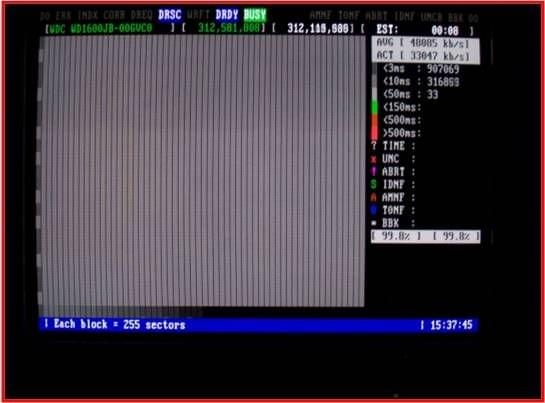

    You can check the condition of the HDD and possible damage using MHDD. Windows does not repair disks and sometimes do not scan, because you will worsen the condition of the HDD.
    MHDD - diagnoses, scans the disk condition and repairs - RECOMMENDED - info. http://forum.komputerswiat.pl/topic/17548-opis-programu-mhdd-i-technologii-smart/

    Until the failure of the loudspeaker "give voice".

Could the POST speaker itself be bad?
Yes. Piezo buzzers fail after ~10 k insertion cycles or polarity mistakes [Murata, 2020]. A silent speaker misleads diagnosis; confirm with a multimeter or swap unit [Elektroda, kiss39, post #17768487]

How can I test a hard drive when the OS won’t boot?
Boot from MHDD or similar on USB. Run a SMART scan; reallocated-sector count over 10 suggests impending failure [MHDD, 2023]. The drive chirping for one second, as reported by the OP, hints at stuck heads or failed motor startup—a rare but fatal edge case [Elektroda, Wojewoda82, post #17767932]
